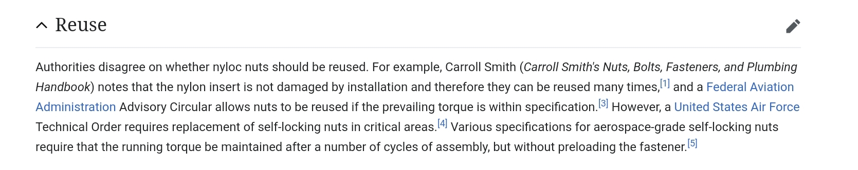

Nylock nuts hold tight after being securely tightened on bolts. After removal of nut, replacement and re-tightening two or three times will remain secure. After several removals, returns and tightenings, Nylock nut holding power is reduced and nuts must be replaced to assure security.
I used to do teletype machine repair work in the Navy in the 1960's before nylock nuts were invented. Nylock nuts, when only applied to a bolt two or three times, hold much better than all but a very few specialty lock washers.
