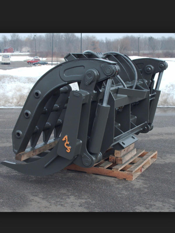

SSQA stands for Skid Steer Quick Attach. It is the standard mounting plate that you have on Bobcat and many other skid steers. Most compact utility tractors have some kind of SSQA plate on the loader so that skid steer attachments can be used. With these quick attach plates, changing from buckets to forks or other attachments takes just a few seconds. Skid steer attachments typically come in light duty, medium / standard duty and heavy duty varieties. For most CUTS the light duty attachments will probably be best. For the largest CUTS the standard / medium duty attachment may be appropriate. The heavy duty attachments are overkill for any CUT and the extra weight reduces what your FEL can lift. For example, heavy duty SSQA grapples can weigh over 1000 pounds. The snow bucket that I recently purchase was "light duty". It is 550 pounds, made of thicker and better quality steel than my original equipment bucket and has more reinforcement. It is not "light duty" by any measure in the CUT world. But in a world with 90 hp tracked skid steers, it is light duty.
The grapples for a 100hp skid steer still look light duty compared to loader grapples that go on machines with lift capacities over 10 ton.
Yeah that might be a little much for a sub compact to handle.:laughing:
If that pallet could talk it would be screaming.:eek:

Yeah that might be a little much for a sub compact to handle.:laughing: If that pallet could talk it would be screaming.
I doubt a sub compact could ever push it. The cylinders on that thing are bigger than the one on my log splitter.

4570, That doesn't look like something that grabs wood . . . It looks like something that eats it. :)
Run for cover . . Look at the fangs it has lol.
