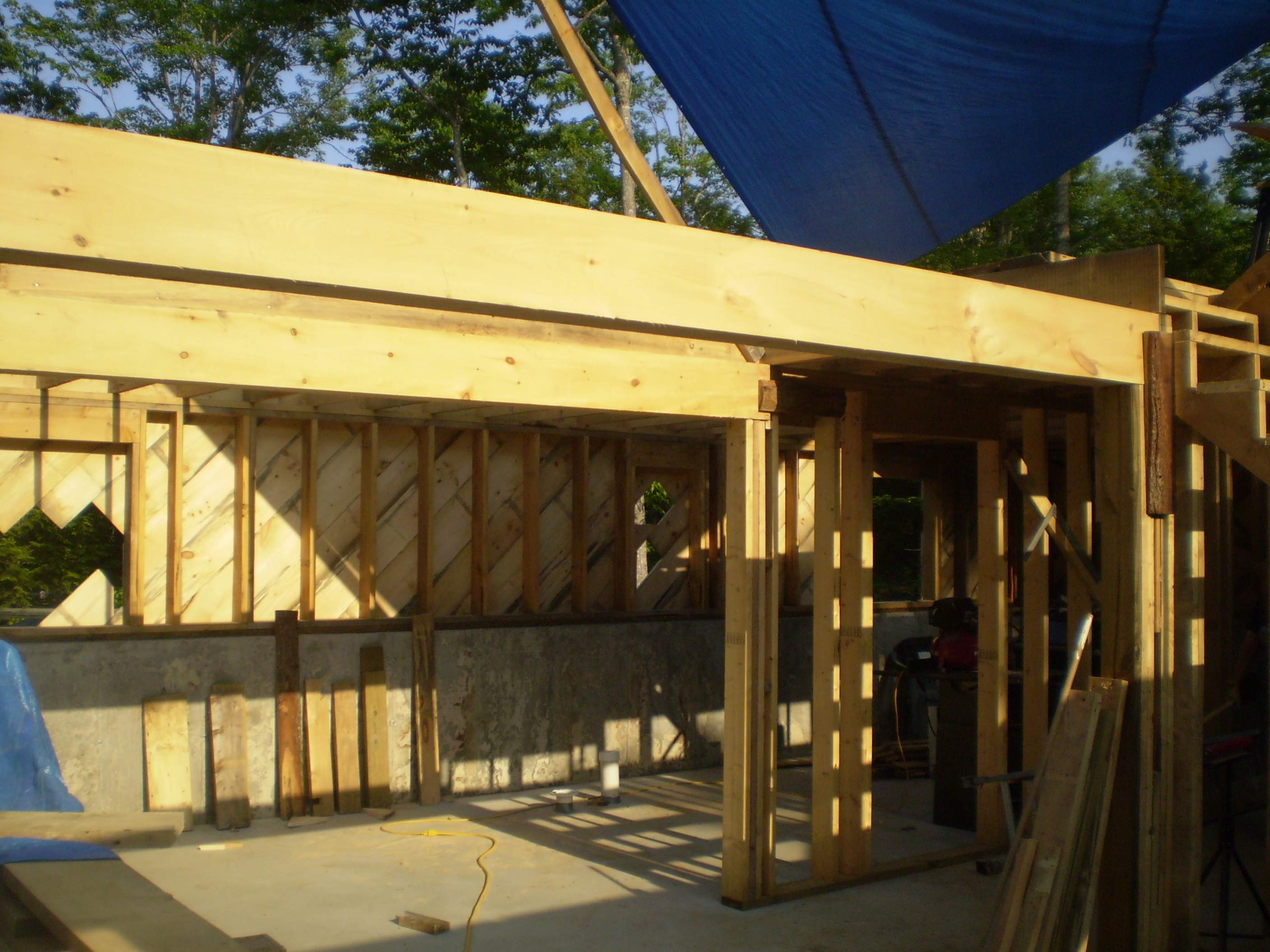

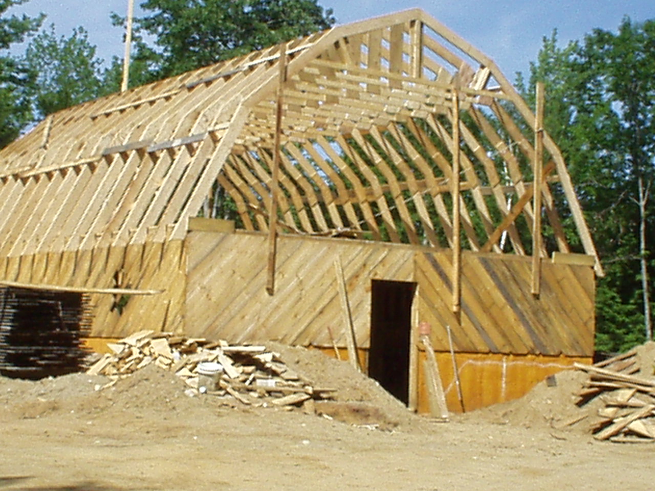

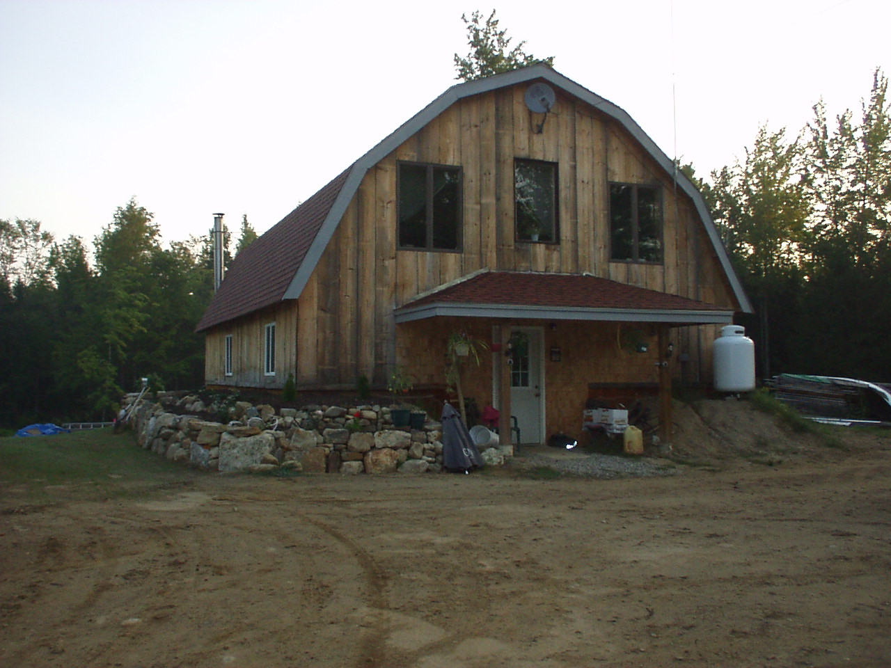

This is the new house I started building in May 2008. It is 28 x 36 one and two-thirds floors. It was designed and revised over the last ten years, still isn't perfect but it was all "out-of-pocket" and sweat!
No power lines, only a phone wire until a new [more] local cell tower goes up. Sat TV (Dish is the best deal $$$-wise here) and internet by dsl/phone line.
I spent 8 months (days off and weekends) cutting over 18,000bf of logs off the 125 acre woodlot. A local guy came and picked them up on his pulp-truck, sawed them and delivered the boards back on site for .25bf. Some of the boards made the trip back to him for T&G, which now cover most of the interior walls.
Power=115v Honda EU3000 (started with an EB3000), big triple baot charger and two Trojan 475aH 6v batteries. We should be installing 10- 235watt solar panels and the Outback inverter/charge controller in early Spring along with 6 more of the same batteries.

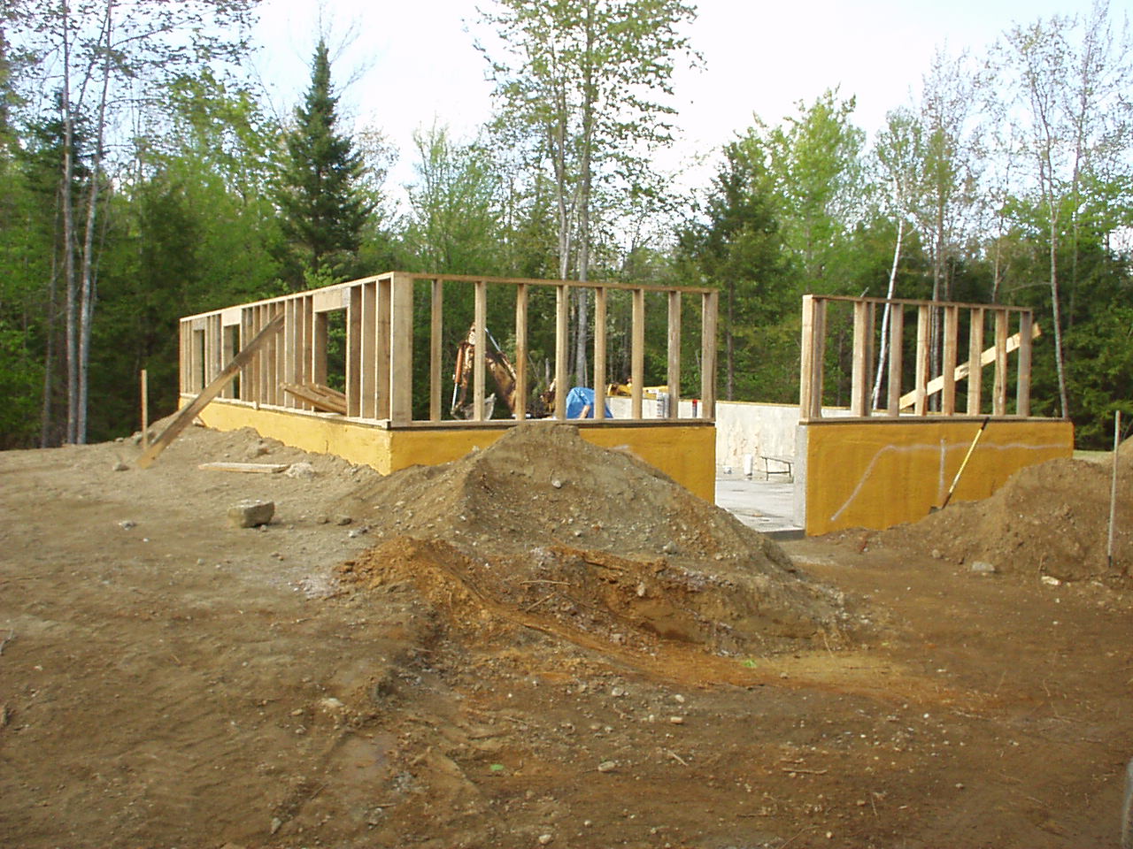

I needed help twice while standing up the home-made roof trusses and once with the 18' 6 x 10" beams inside over the living room. Oh, and since I wanted the concrete perfect... I hired the best for that. The foundation has 2" of spray-on foam before backfilling.
I did take thousands of photo's during the build...

I also see you did angled planks for the outer walls and then large verticle plank siding over those (I assume tyvek etc. between those layers?).
And the interior is all T&G! WOW... you da MAN!

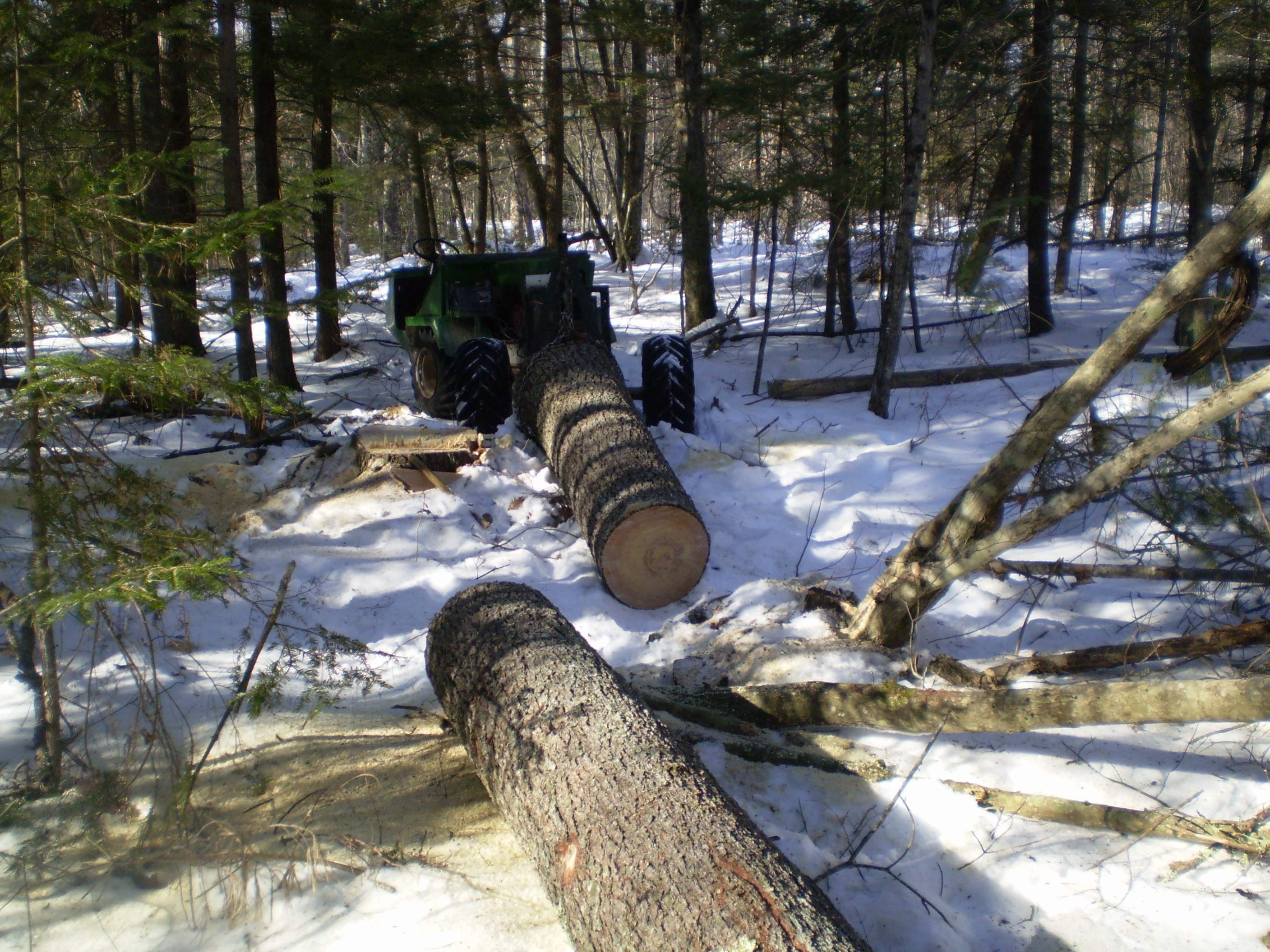

Photo 1.
For the logging operation I used a 1970 PUG UTV, with a log arch my prospecting buddy made up for me. With only an 11hp Honda it could haul this 29" x 12' pine butt-log with relative ease.
Photo 2

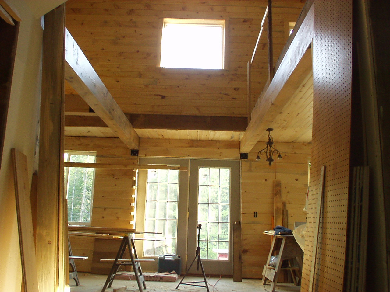

Looking up and North, believe it or not. The open space and the small but well placed windows really light the place up.

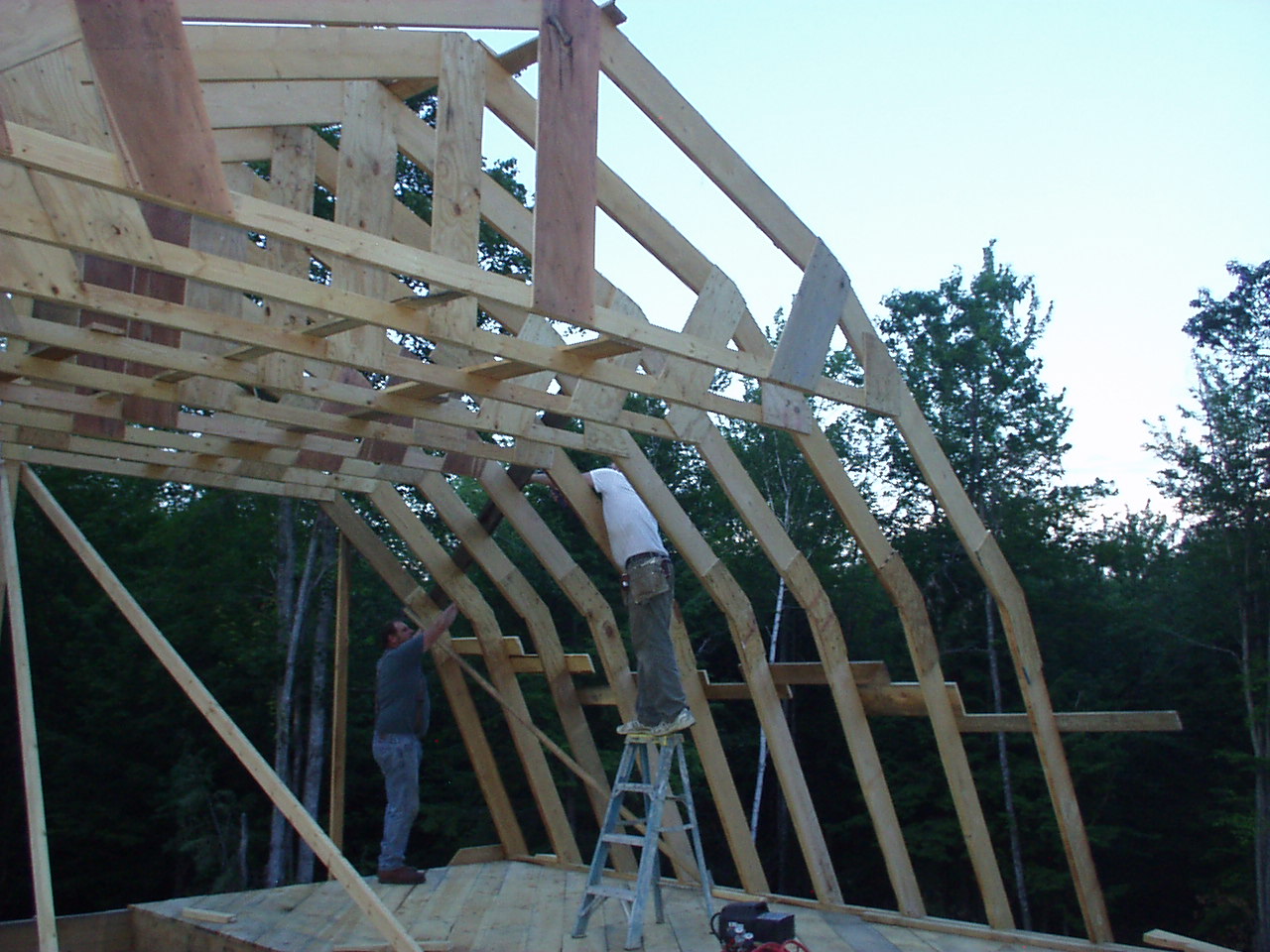

Photo 3
I jigged the roof-lines out on the deck, then built each one on the jig and then had to move each to the stack. Only half the trusses could be built at a time. Due to limited manpower, each stack had to start going up at the ends so that I could slide the last ones up in the center of the house eliminating the need for a crane. Upstairs ceiling is 9'4" high so the pool-cues won't hit the sheet-rock ceiling.

No need to kiln-dry interior T&G lumber as it was kept dry and sticked for nearly a year before I started sanding and poly-ing late fall 2008.
Between sheathing boards and 16" wide siding is a cheap wind barrier. Here's a tip..... ONLY BUY AND USE TYPAR!!! unless you KNOW your siding will be done before the fall rains come.
I have friends who did the Tongue and groove inside but didn't sand them or only sanded with 100grit. Every inch of every board in this place was sanded with 100 grit, then 220. Home depot water based poly [satin]... first [heavy] coat then sand within an hour. Second & third coat pretty much back to back. The drying racks made this task go fairly fast with as much as I had to do.

Nice work mad jack.How rough were the trusses to put up they look like they were hernia material.

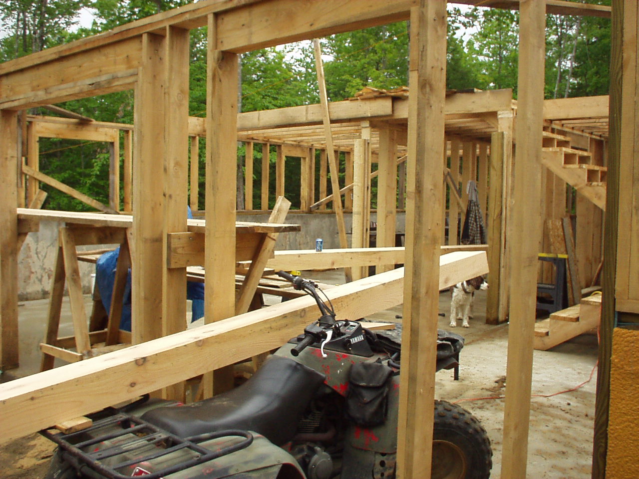

Actually Paul, they weren't that bad. one man on each end and I used a 12' 2 x 4 with 16d box nails protruding to 'stick' and push the top of the truss up. The last two were a pain, we had to slide them up under and between the last ones coming from either end of the house.
Kind of like the beam-on-the-wheeler picture.... I had to get it from the trailer to the back and then inside. I put one end on the back rack, one end on the front rack and drove it around the house and into a window opening. Then one end up on staging ... then the other. I could only lift one end at a time so I had to find a way!
