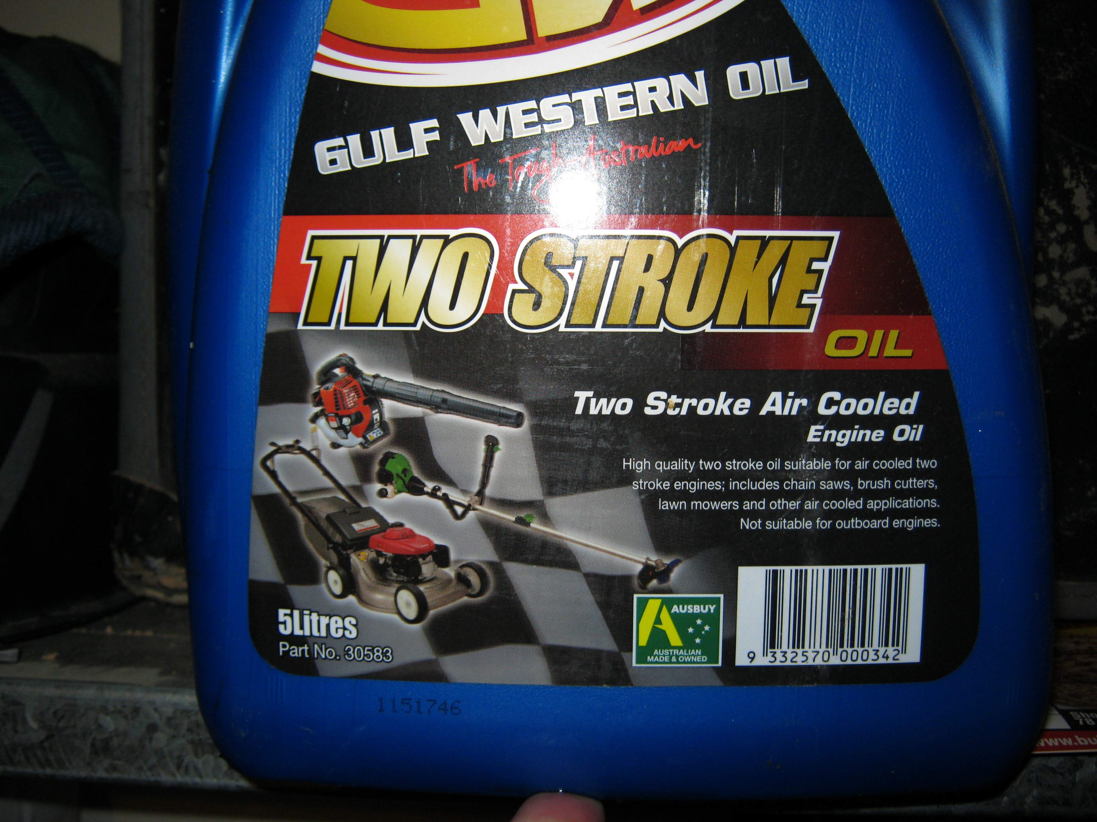

Neat 1500, what do you mean by "non-marine type?" How did you come up with 300:1 as the mixing ratio? I'm just curious.
I should have said standard 2 stroke oil, not non marine:eek: as i have been told it has other additives( non corrosion and water dispersant detergents) in them as well which for the Landcruisers and Yanmars is not required or recommended. i was reading alot of literature from 4WD clubs here in Australia about the use of 2 stroke oils in ULSD some years ago after it was introduced and most agreed this was a good ratio. they were also speaking to some oil guy who really knew what he was on about, also there were some older guys who had been using 2 stroke oil in their old diesels for 20 or more years an reckon it has helped prolong the pump and engines life no doubt. my Landcruiser had a major pump failure in 2006 which was possibly caused by lack of lubricity, the pump ground itself to bits and over/under dieseled and caused a crank break, new motor and pump thanks:mad: and after that most recommended i run 2 stroke as it does not do many miles and i think it is also quieter in operation so i will stick with it i thinks:thumbsup:
   / off road diesel or regular diesel #16
heres what i have been using for a few years now,$18 for 5 litres. it lasts me more than a year.

Neat 1500, I wasn't trying to catch you off-guard or disagree. As I said, I've used a couple different types. The ratios I've seen in my very brief time looking into these things have spanned from 100:1 up to 300:1 or so. The test I attached seems to be one of the standard references in these sorts of discussions.
Their test used outboard motor oil at a ratio they describe as "rationally chosen" of 200:1. I haven't ever seen where that came from "rationally," it seems tough to mix in American units (128 ounces equals a gallon, so this ratio is 1 ounce of oil to 1.56 gallons of fuel).
The TC3W oil they tested worked pretty well, but I wonder what it would have done at 128:1, or 300:1, or some other ratio. Neat 1500, you recommended a non-TC3W (non-marine) oil, and clemsonfor recommended exactly the opposite. I respect both of your knowledge and experience, so was wondering how you each got to your positions. I didn't know if there were different rating agencies in Australia for 2 stroke oils. As I said, I've run both types, mostly because of what was available and simple for me to do. I wish I had more empirical data. Sorry to take the thread slightly off-topic.

I would not really say i recomend a tcw3, sorry if it sounded that way. I was just saying in my mind it would make more sense to use an aircooled oil. Neat explained that there were some additives on the tcw3 that were not needed or wanted, i can go with this. Again i really have no experience here.
