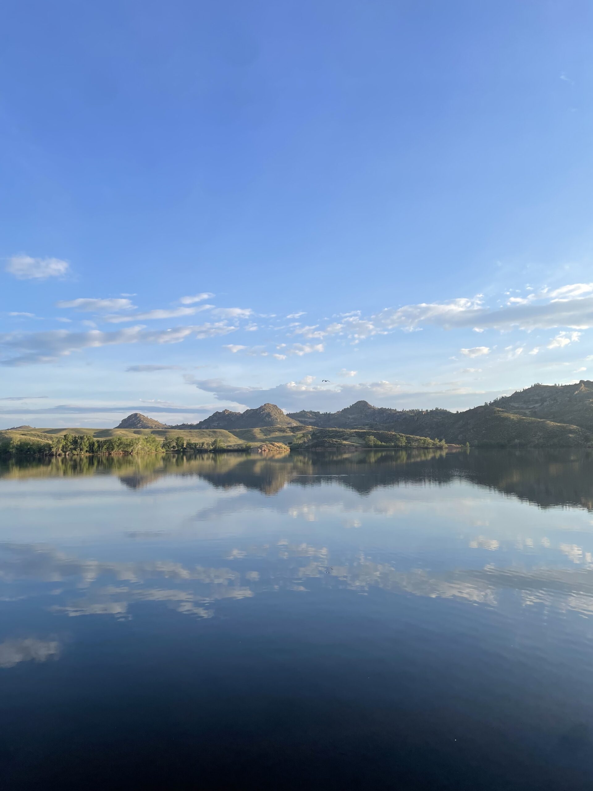

My lake varies drastically between spring and fall. It also varies drastically between wet and dry years.
Haven't you guys been dry lately?

That's a very nice looking lake!!!!
The state is pissed I have senior water rights from a hundred years ago for it. I swear, I keep an attorney pretty much employed full time defending all the various people that want the water.
It's crazy how valuable water is in the west...
   / Offered another unusual project #68
Is that Wyoming? I always thought that was a good state for ranchers.
