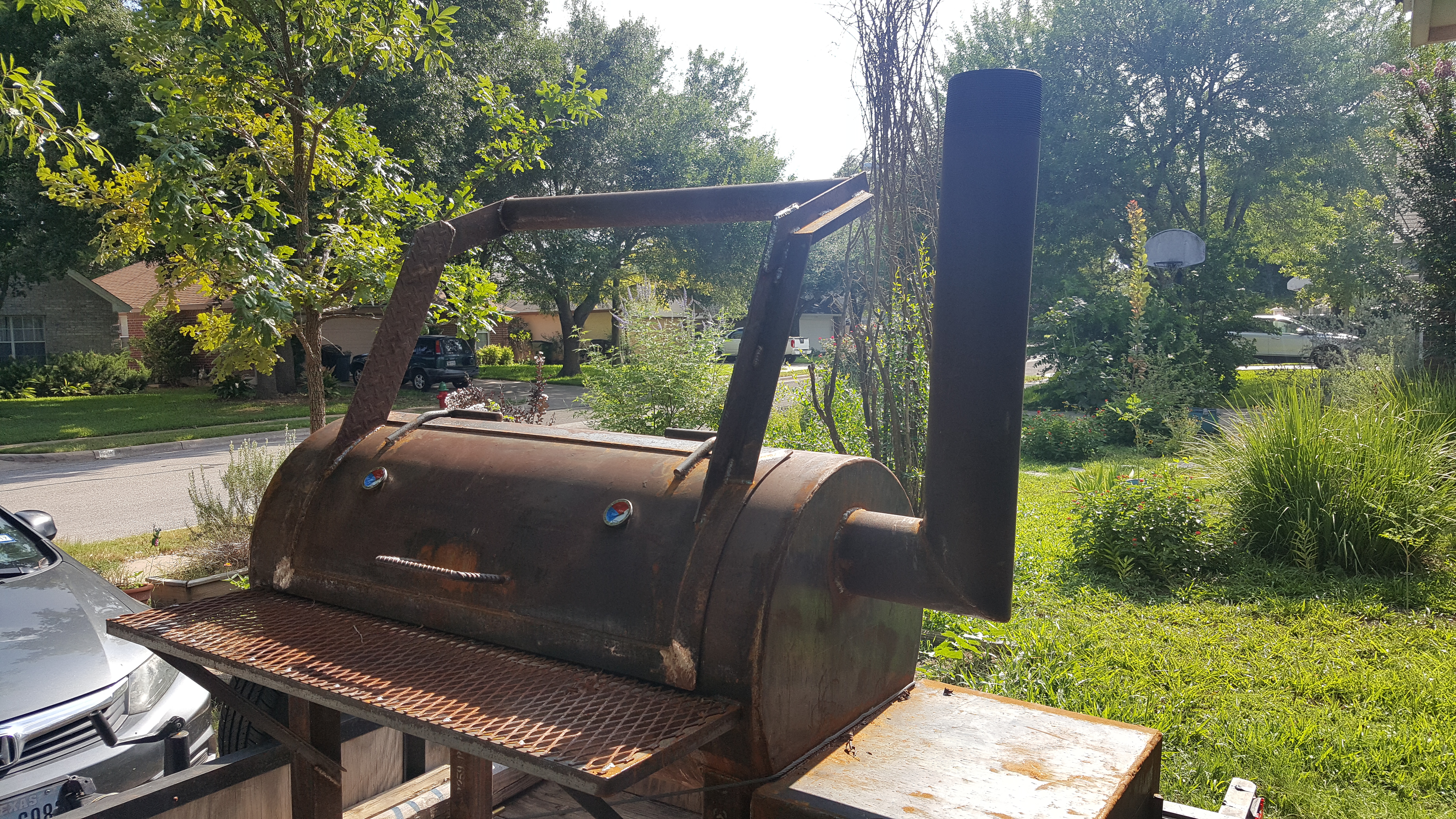

I've always wanted to make a smoker. It took a lot of hours but the first brisket made it worth it.
3/8 x 24 x 48 pipe and a sheet of 1/4 plate

You need to install some counterweight on the back to help with opening that lid. A little high temp paint would look nice on it too.

Looks good. I have built a number of reverse flow smokers over the years.
The most useful feature I have added was automatic temperature control.
These are two of the methods I have used.

I kept track of my labor hours and material cost as I built it. I think if I ever sold it or similar the price would have to be at least $2200.
I might paint it, but I see so much unpainted farm stuff from my grandfather built 50 years ago that has only surface rust I'm not sure it is worth it.
I installed a counterweight and opening is much easier.

Maybe a hi temp baked finish would be slick and I would probably give it a try just to 'finish' it but certainly not needed.
