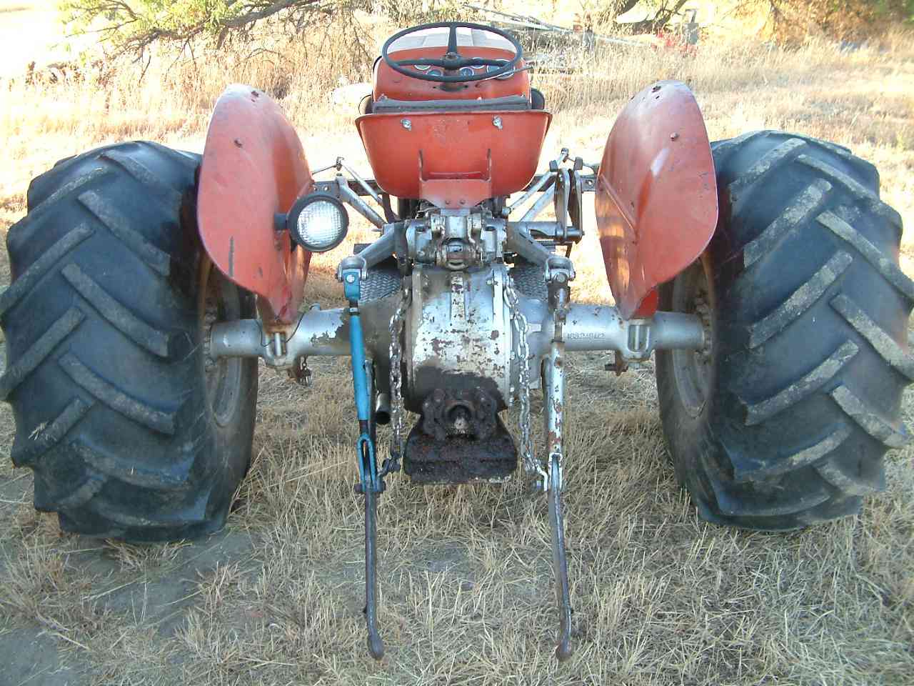

Here's my rear tire setup. Someone remarked that they look like the front tires from an MF combine.

Looks like your stay chains are pinned high on the banjo. On my 135 they were attached to a bracket on either side of the pto stub. Some creative solution to adjustable stay chains may help you offset your drawbar to drag your harrows where you like.

Sorta wondered about those chains myself. It looks like maybe someone rigged up a way to control cutting height on a mower using sway chain mounts to attach the to the draft arms. On a 135 with standard tires/wheels, offseting the draft arms far enough to meet Flushers needs would get them into the tires. I'd suggest returning to the ORIGINAL sway chains, then carrying out the offset on the drawbar. I never like to deviate from O.E.M. unless that is the ONLY way to achieve a goal. Things have a way of working better and lasting longer when I follow that criteria.
