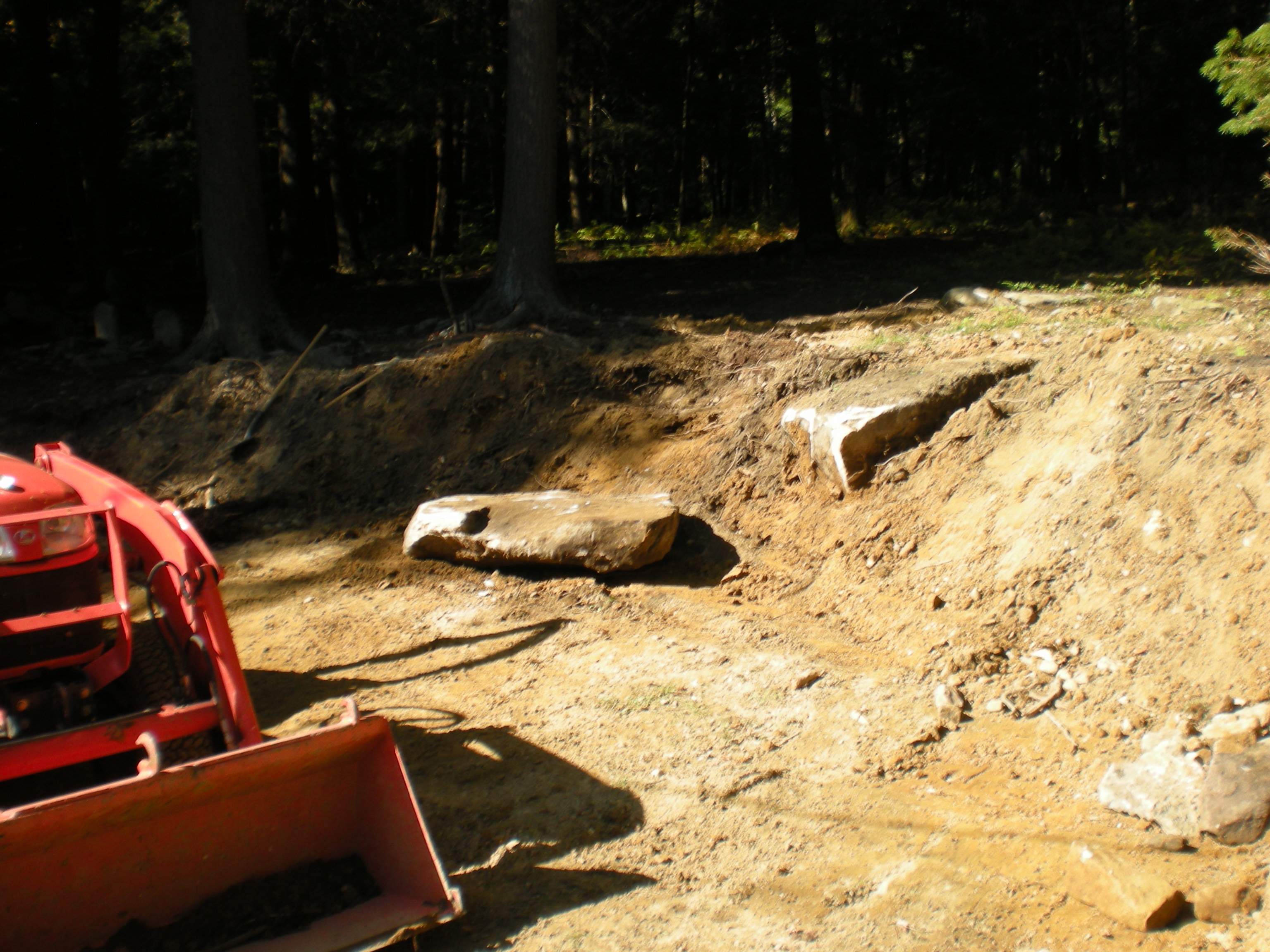

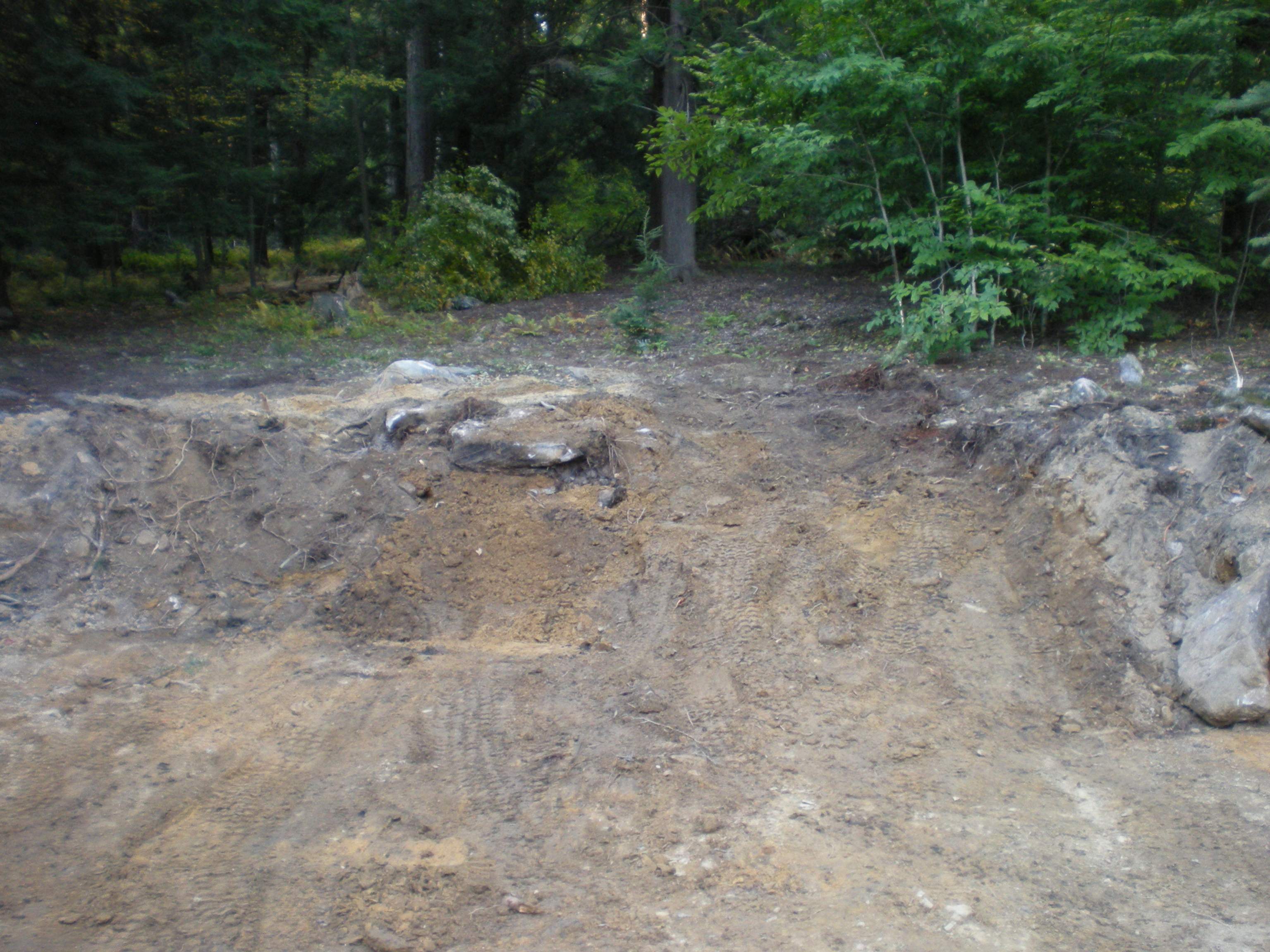

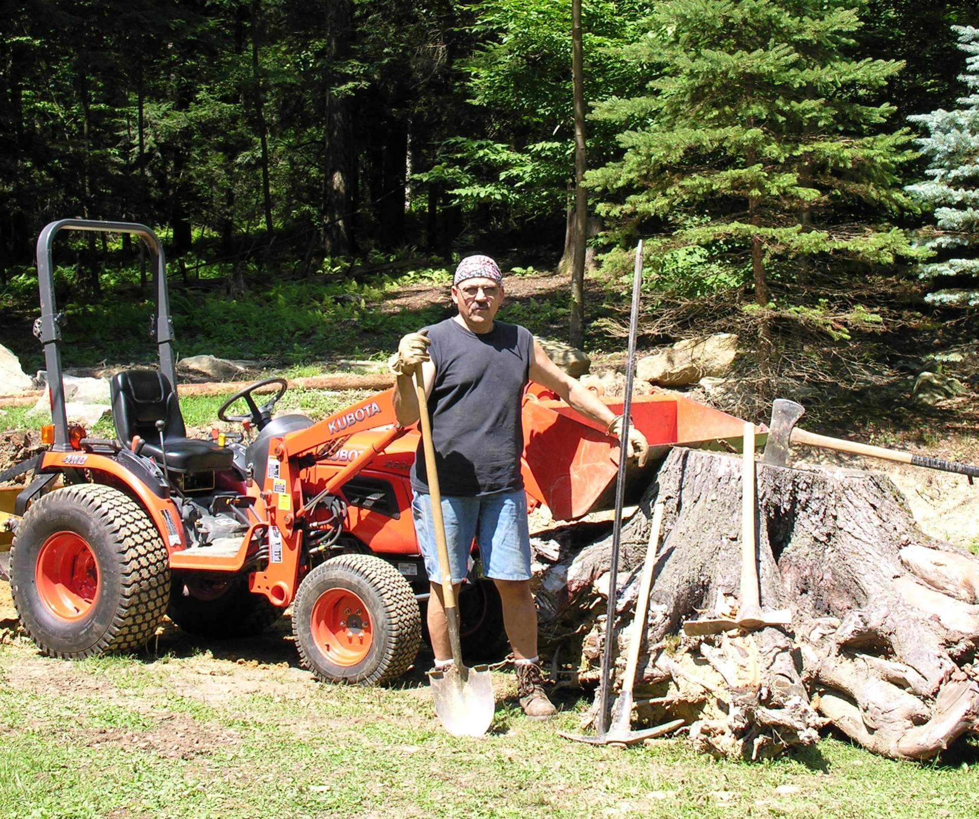

Thanks to all for the replies. I am now the regular may be my best bet because as 300UGUY stated it can be removed. I am digging out a bank where I plan to build my barn and where I am moving the dirt will not require any back dragging that needs to be smooth. The two trees in the second photo are down now, so there are a couple more stumps to remove. Fortunately there are smaller than the one in the third photo.:thumbsup:
