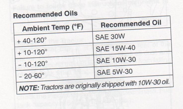

   / Oil change help? #17
Here is the NH manual recommendations. Notice that new tractors are shipped with 10W30.
