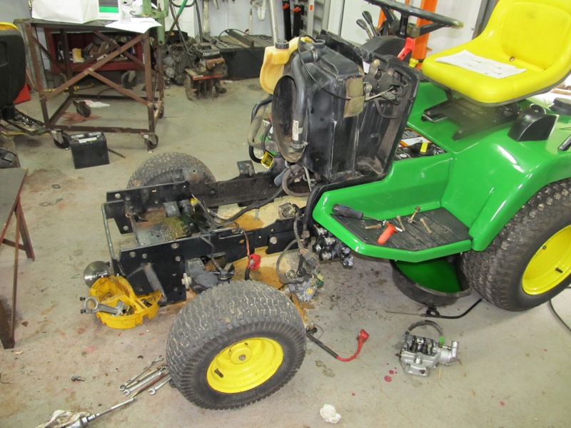

That valve is someplace in this picture of the engine end, but I am not sure exactly where.
I paid someone about $650 to put the rings in.
The other picture is what it looked like as he was tearing the engine apart.
   / oil coming out of breather tube in carburator #20
Thay picture of the motor. That little valve is in the top part that looks like a box in the bottom left corner I believe.
