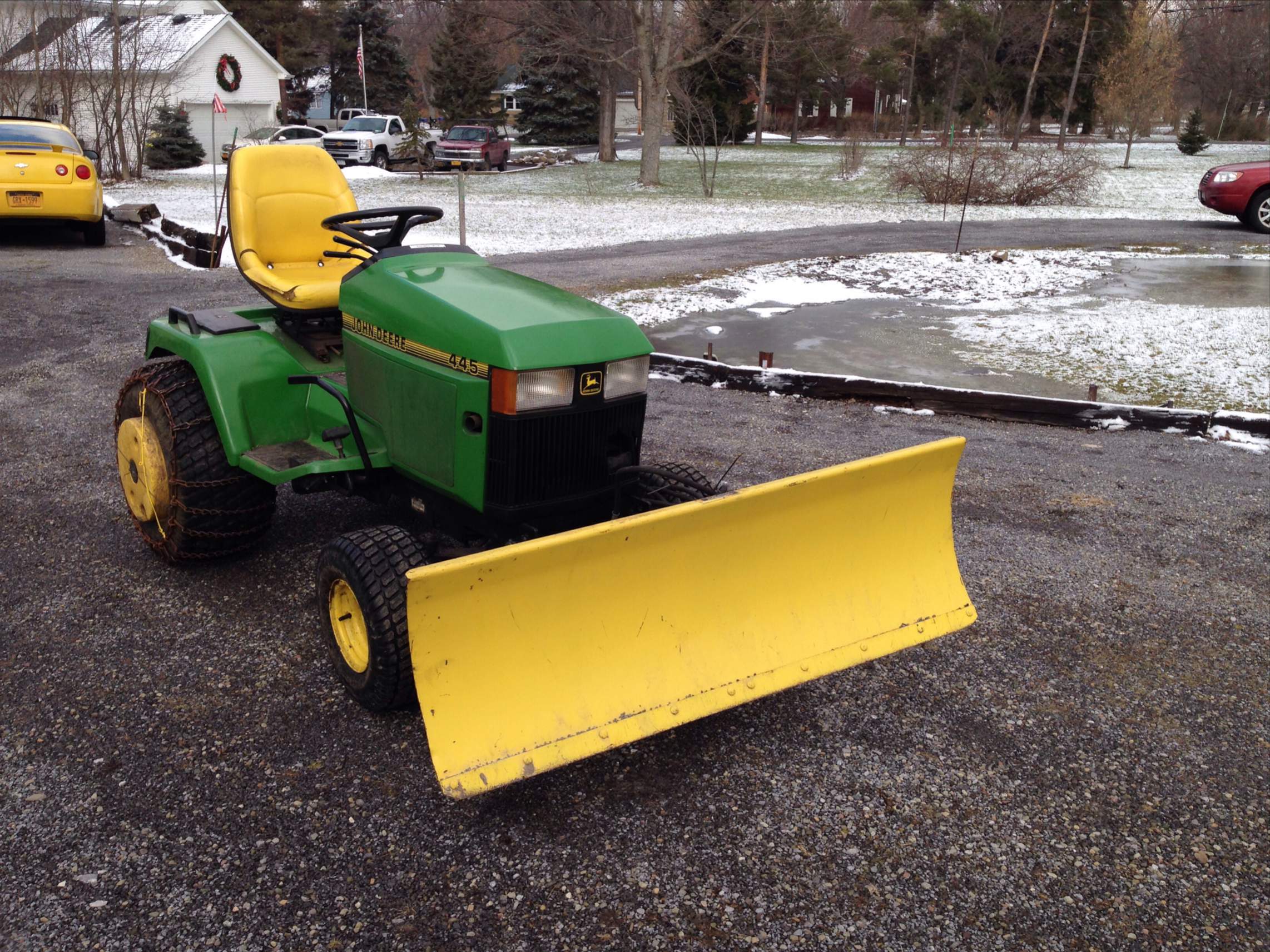

didn't want to do it, but I can see it is not an easy fix. I will use it a few more weeks before getting into it, still need it for snow. todays high... 8 degrees, Sunday's high -1 degrees. sure don't help buffalo's reputation. on November 11 we got 78'' snow. no choice, had to use the massey on that one. I can use the massey with the loader, but it's just easier to use a plow in a stone driveway. by the way, I forgot how to add photos to this, can you tell me how to do it again

that was my first massey, had 1,100 hours, I put a 61'' bucket on it for snow, sold it and bought a newer massey with 100 hours, I will use the 61'' bucket on this one toojohn deere 445 3.jpgjohn deere 445 2.jpg

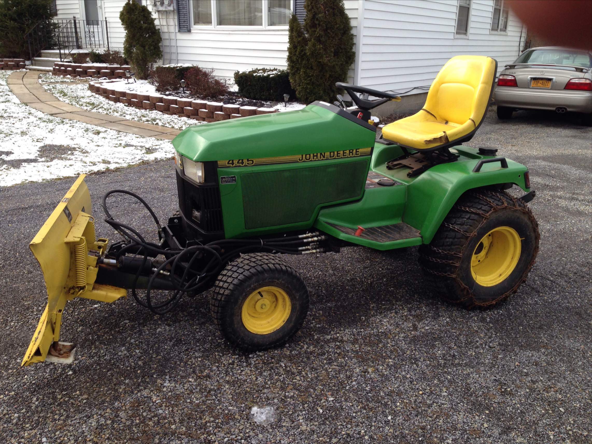

thank you yellow fever, being so cold, i finally was able to look at the tractor. i checked the compression 190 and 170, 170 being on the one that has the more fouled plug. i vented it to the bottom of the motor till spring, put in a new air filter. i am hoping that the dampness in the garage ( from snow and salt from the cars) partially plugged the air filter ( along with the oil on it), hoping when it gets dry out, the problem will get better. i still used it all winter for plowing, and it did a great jobjohn deere 445  6.jpg

thank you yellow fever, being so cold, i finally was able to look at the tractor. i checked the compression 190 and 170, 170 being on the one that has the more fouled plug. i vented it to the bottom of the motor till spring, put in a new air filter. i am hoping that the dampness in the garage ( from snow and salt from the cars) partially plugged the air filter ( along with the oil on it), hoping when it gets dry out, the problem will get better. i still used it all winter for plowing, and it did a great jobView attachment 414960
