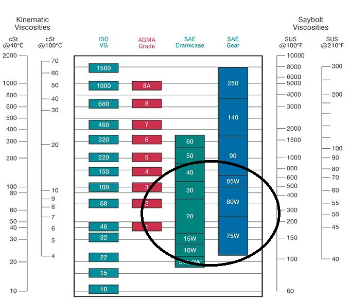

I've read through lots of posts and still don't see answers that fully address my questions so I figured I'd just post.
1. My manual states 5W30 or 10W30 for engine oil. I have been using Rotella T4 (mineral) and want to switch to T6 (synthetic). However, T6 that is specific for diesel has 5W40 or 15W40. To get 5W30 or 10W30, I have to use T6 multi-vehicle. I'd prefer to stay with the diesel-specific and with the manual specs of 5W30 or 10W30.
2. Because of issue with #1 above, looking at AMSOIL 10W30. Definitely more expensive but it's once a year and so not too worried about the cost if it is really worth it. One of the members offered Preferred so I reached out to him and the cost will be lower if I get that.
3. For Front Axle and Hydraulics/transmission, MF manual states to use Permatran 821XL but doesn't specify viscosity. Specs on the 821XL state it is 10W30. AMSOIL alternative is 5W30 so I'm comfortable with that, especially because the manual doesn't specify. It's quite expensive but again, once a year.
Based on the above, what are your recommendations.

T6 Multi-Vehicle is fine. As is Mobil Delvac and Chevron Delo and many others. Use what ever you are comfortable with and be happy.

Still a little confused. The manual stats to use Permatran 821XL for both the front axle and transmission/hydraulic. Specs for 821XL state it is 10W30. Isn't the front axle more like 80W90?
   / Oil (Engine and Hydraulic/Transmission for 2019 GC1725MB) #9
front axle and transmission/hydraulic oil are the same on my machine
   / Oil (Engine and Hydraulic/Transmission for 2019 GC1725MB) #10
Comparing apples and oranges. Motor oil and gear oil use 2 different classifications. 10W30 motor oil and 75W85 gear oil are the same viscosity, but different applications, so the additive package is different.
