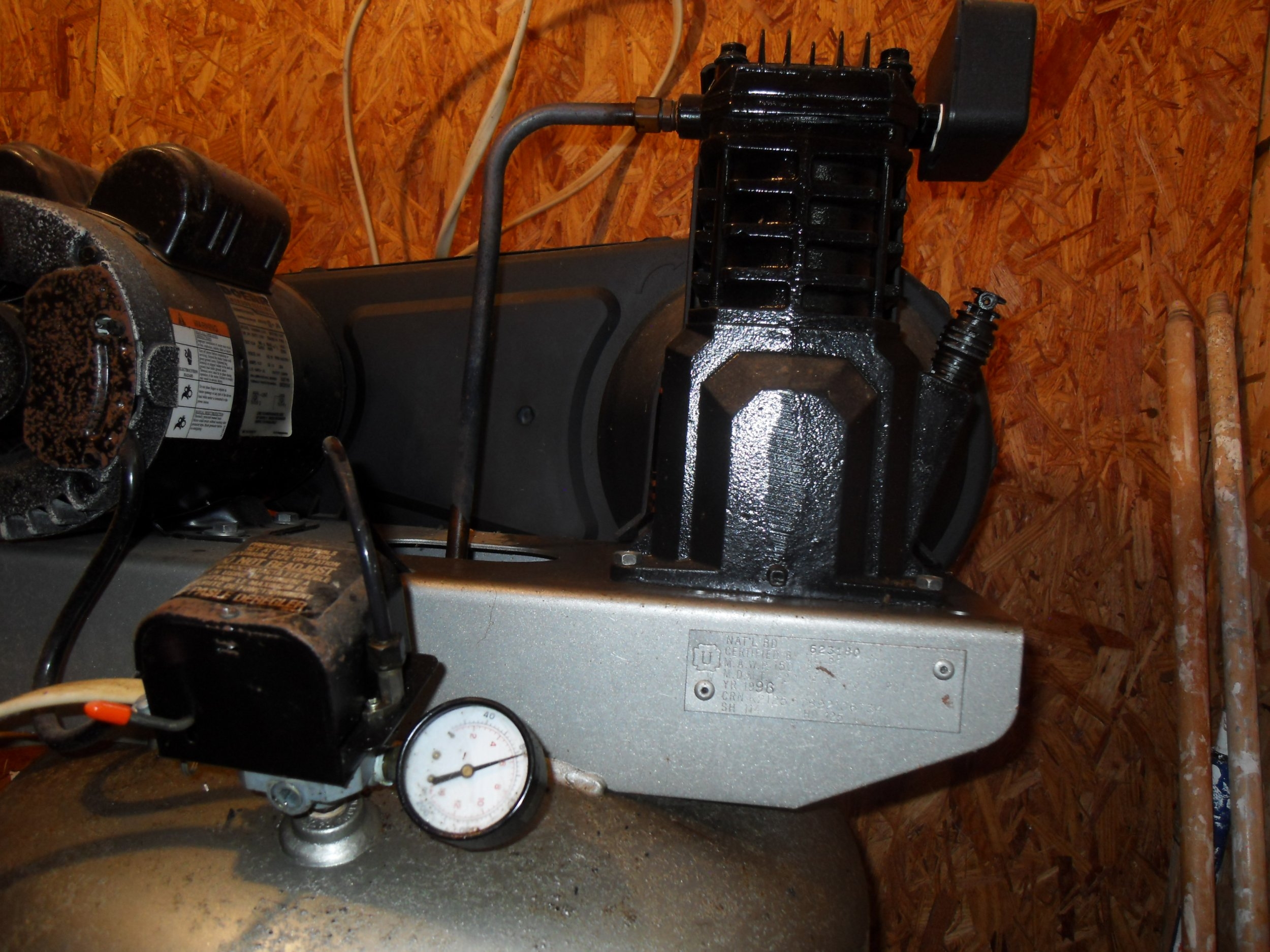

I have a tall(50") air compressor, Farmhand Cast Iron, Campbell Hausfeld, that keeps kicking on. Had a neighbor stop by, he said it was probably a loose end connection, tho I doubted that. I noticed some clear fluid coming out the top of the compressor, the neighbor then checked the oil level and said it was low and I should add some. That will not remedy the problem of losing air but I need to get some oil. I do know it should be non-detergent and 30 weight. Should I just go to an auto parts store and get it, and does the container need to say Compressor Oil?

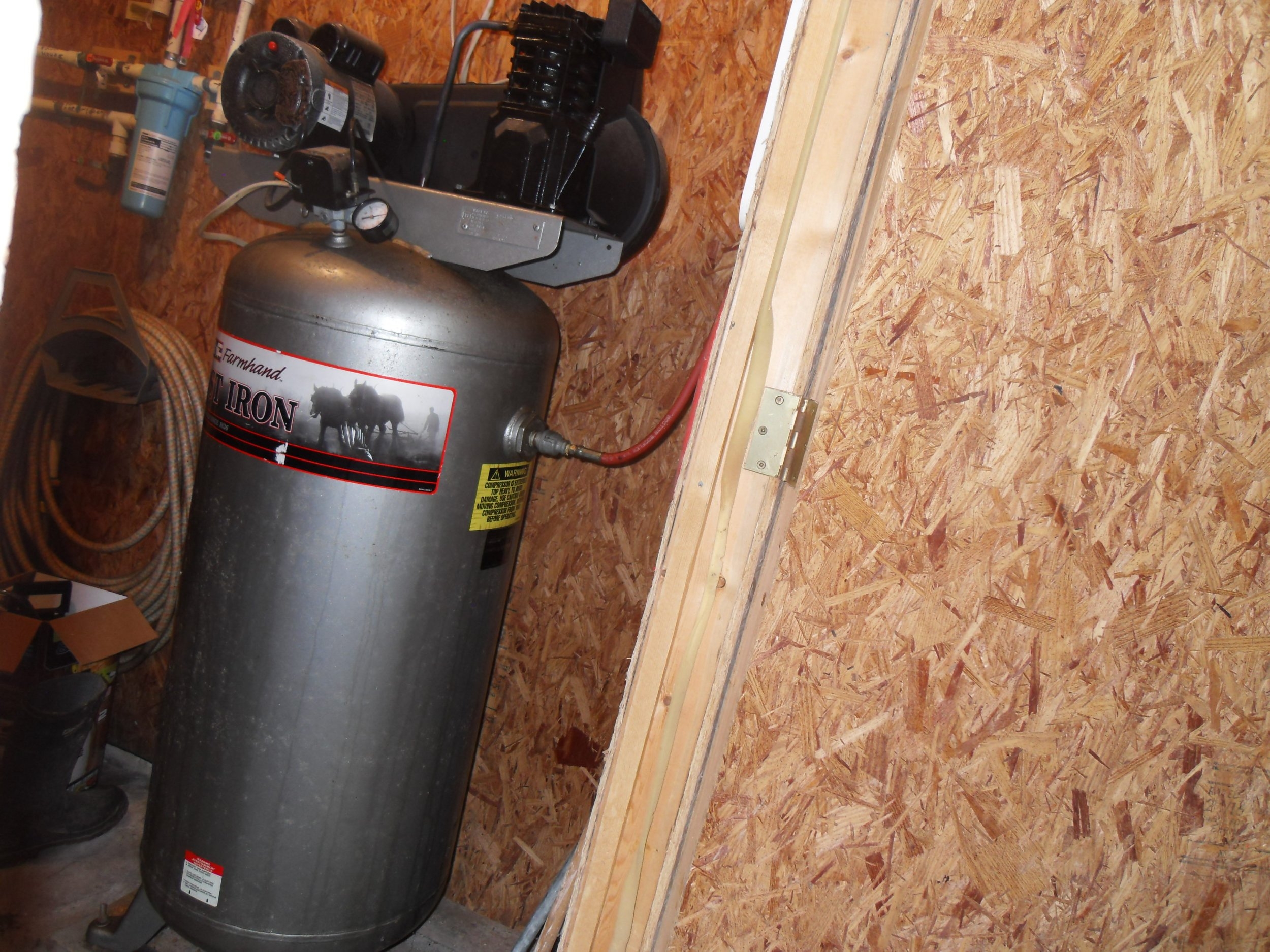

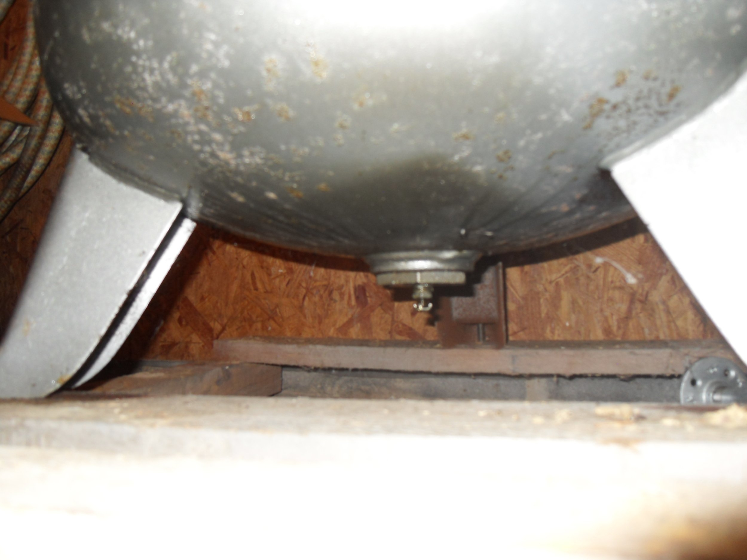

I see a valve under the tank, first picture. Not sure if I want to fiddle with that. Second and third pictures show the tank, the fluid(appears to be a clear oil-like substance) seems to be coming from the black part on the top right of the tank in the third picture.

Yeah. That first pic is the drain valve. Turn the tee handle to drain & re-tighten when the water/moisture stops. Lefty-loosy/righty-tighty. If you're ambitious, replace it with an elbow/ball valve/extension to make future draining easy & you can redirect the moisture with a hose. You seem to have an oil leak at the connection between the compressor & the fill pipe that feeds the tank (might seep air there as well). Let all the air out & turn it off before opening that connection, then see what you need to replace to seal it up. Long as you're there, change the oil/refill & you should be good to go. That fill pipe will get hot when the compressor is running, so don't burn yourself. Shut her down/let her cool off if there is a doubt.
less than 30 seconds on the drain valve should take the moisture out of the tank, unless you've never done it before.

It is common for a lot of crud to collect on the tank bottom. This crud can clog the drain valve. It is tempting to use air pressure in the tank to blow this crud out. Doing this can lead to all sorts of crud being blown all over the place and under your skin. If the tank has not been drained for a long time then the safest thing to do is vent all the air from the tank, then remove completely the old drain valve. After removal poke a stiff wire into the hole to loosen the crud. And instead of putting back in the cruddy stock drain valve install an elbow, and an extension about a foot long, and a ball valve. After doing this the tank will be much easier to drain. Also, if air pressure is needed to blow crud out, the ball valve is the much safer option. The drain valves that come stock in virtually all consumer grade air compressors rely on a tapered valve seat and valve. This seat is easily prevented from closing completely by the tiniest of particles, particles which are common in consumer grade air compressors, which is what you have.

If that drain valve has never been opened, there is probably a huge amount of water in the tank. Spray it with penetrating fluid before you try to open it. With a little persuasion it will probably open. Although these valves are meant to be operated by hand, you may need to put a wrench on it the first time. A compressor that is only used occasionally should be blown down and left depressurized until you need to use it again.
/ oil for air compressor #19
^^ What KennyG said. Don't force the valve, spray with PB Blaster or some other penetrating oil & let it set for a while to let it creep up into the corrosion. Work progressively, as if you break the valve, it will be a bear to remove the stub piece left behind. A little back & forth with leverage as needed to remove the old valve. Can't remember if mine (elbow/ extension/ball valve) was steel or brass ... whatever home depot had in stock at the time. I think mine was 3/8 npt thread on the male end of the elbow when I replaced mine.
