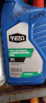

my Campbell Hausfield compressor states, yes, non detergent 30wt, but also mention that Mobil1 10-30 full synthetic will be fine as well. good luck

I found this recently at walmart and met the specs of my compressor.
