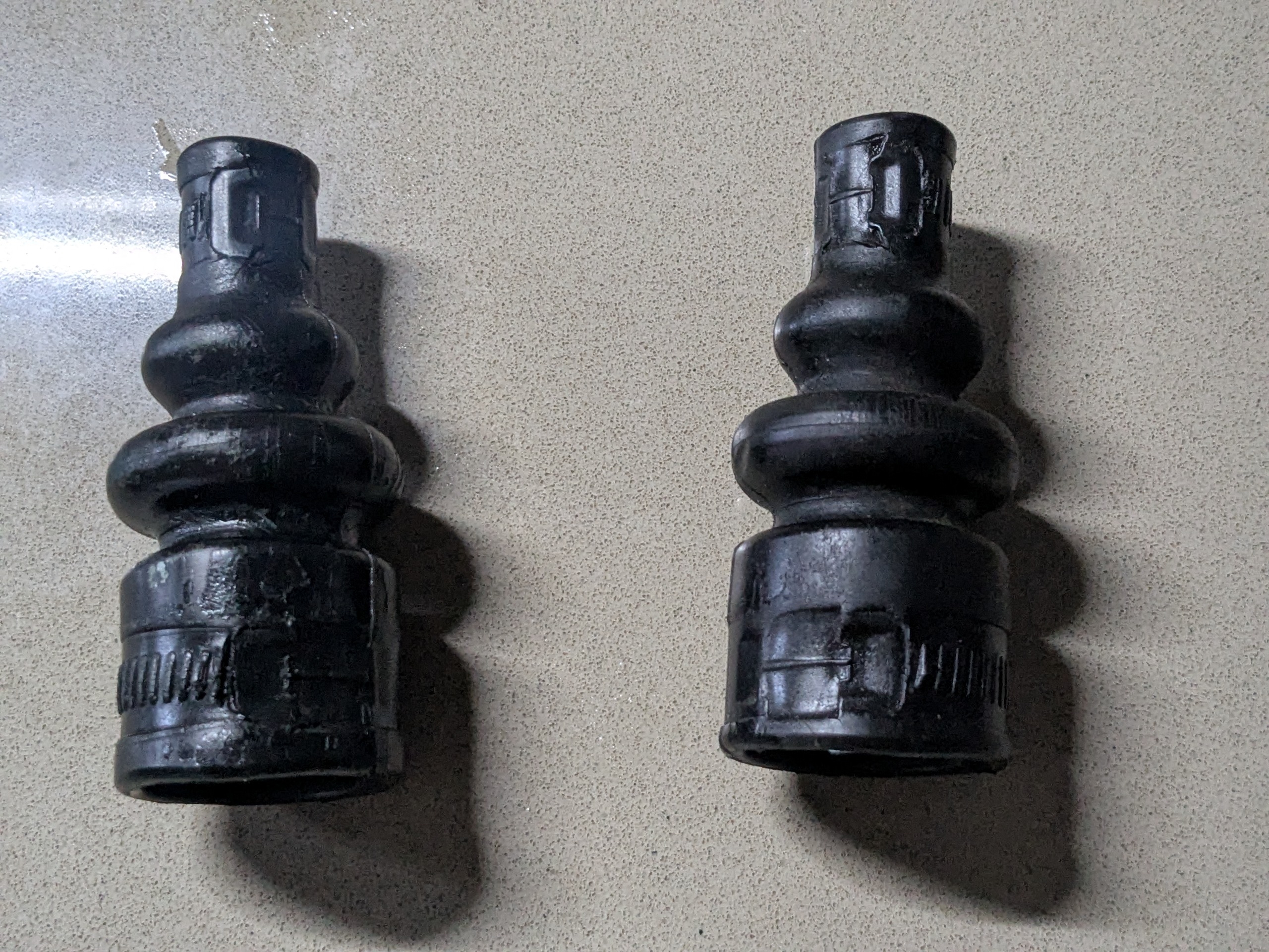

I have a Yanmar 1610 DT that's leaking oil from both brake dust covers.
Where can I find this spare part?
What reference do I have to search for it online?

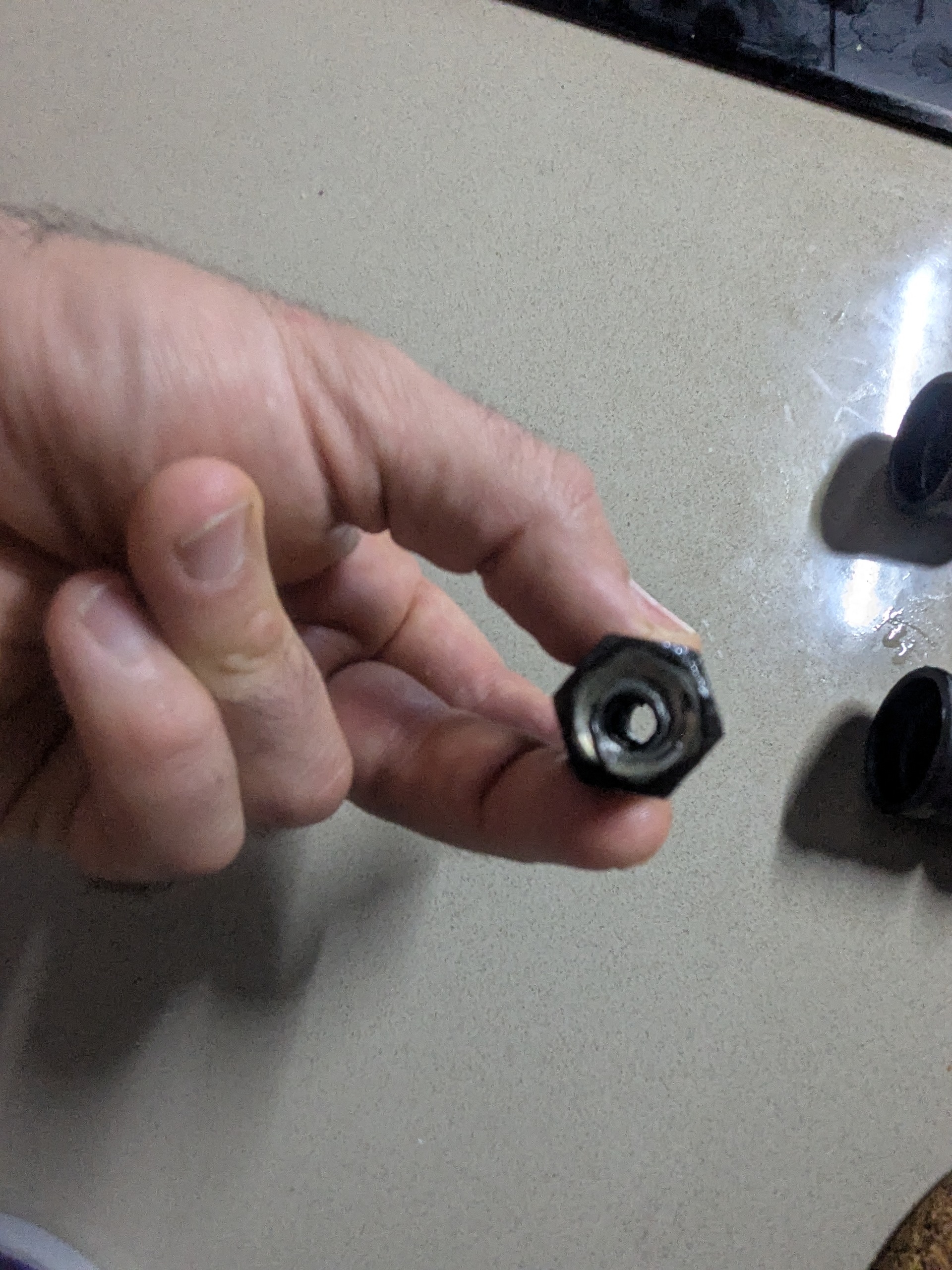

When I disassembled it, I broke a screw inside the spacer.
Where can I find this spacer for sale?
What is its reference?
Thanks.

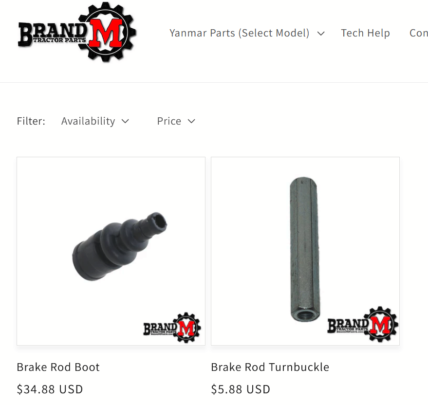

This is a new one on me. Parts manual doesn't show dust covers for the 1610 that I can see. Here is part number and one place to buy the turnbuckle. YM3810-REAR AXLE & BRAKES
   / Oil leaking from brake dust cover #5
Yea I think the YM1602 might be the only "YM" series to use that style brake rod boot. The YM1610 has dry brakes so there is no boot.

Per @AaronM suggestion that your machine is possibly mis-marked, I went to look for those brake boots. Nothing listed for a YM1610. Yet, they do show up for a YM1602.
Brand-M has them in-stock, down in Texas. (y)

In the end, I bought the brake rod boots from this online store:
The stores you mentioned either don't ship to Europe (I'm from Spain) or their shipping costs are very high.

That fluid amount is not unusual for wet brakes. If you have a 1602 that is what you have. There is no eternal seal at the brake rod exit point. That boot is the seal.
