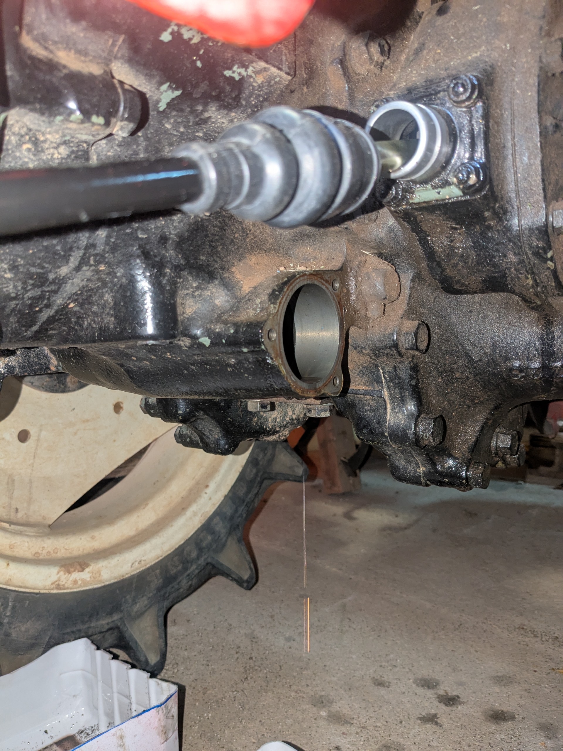

What condition was the fluid in? Any idea about last fluid/filter change? If not then yes, change both.
I do not have access to a 1602 parts manual but here is what I think. I circled what I believe might be the flange that covers your internal suction screen. That screen would need to be cleaned. If no knowledge of last screw on filter change then it likely should be changed. No idea what condition your used fluid was in so I can't really advise a flushing. If everything was pretty clean looking I probably wouldn't do any flushing. A universal transmission/hydraulic fluid is recommended. No idea what you have access to in Spain, maybe Maverick will help you with that.
I removed the filter you mentioned and cleaned it.

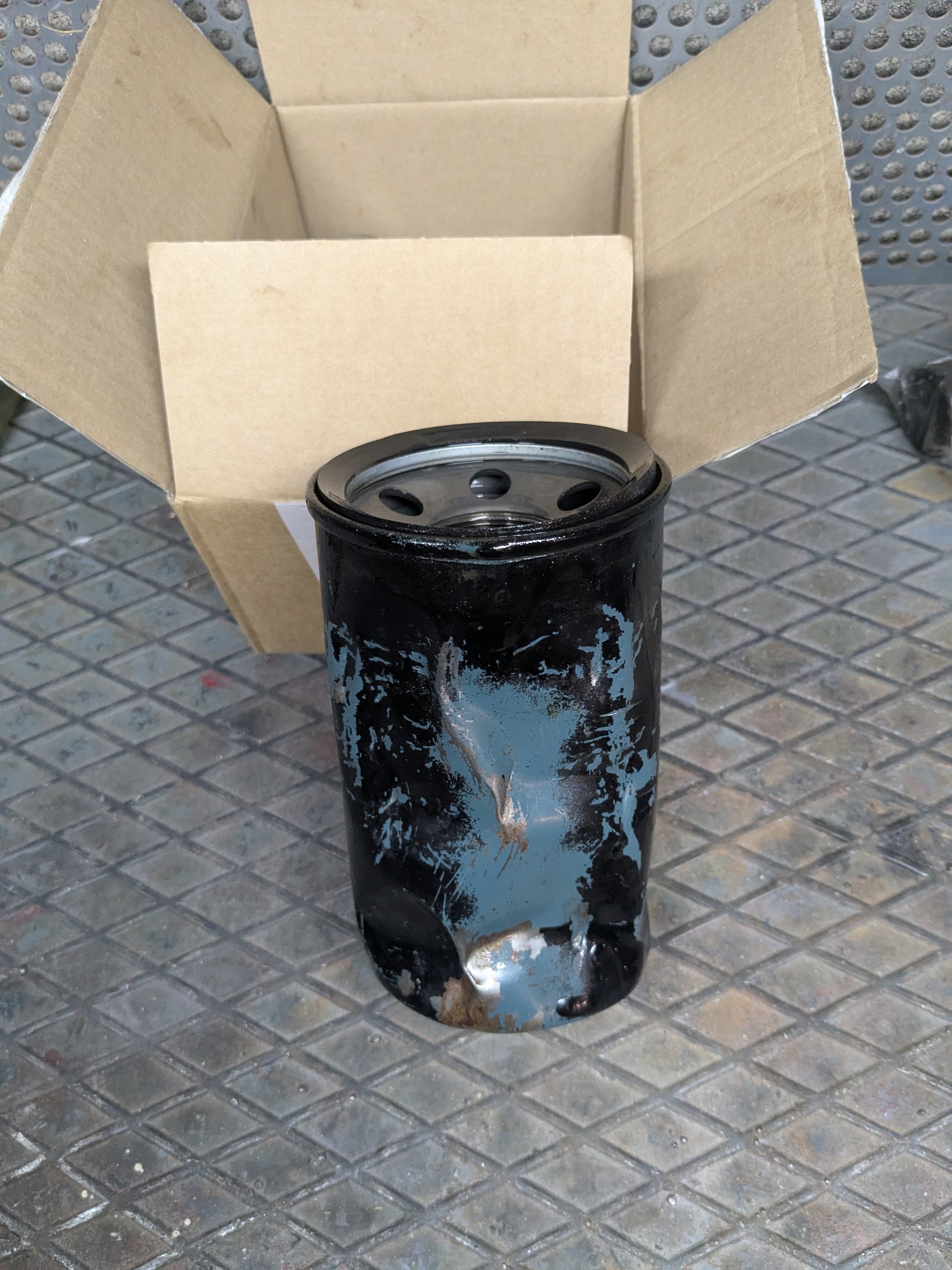

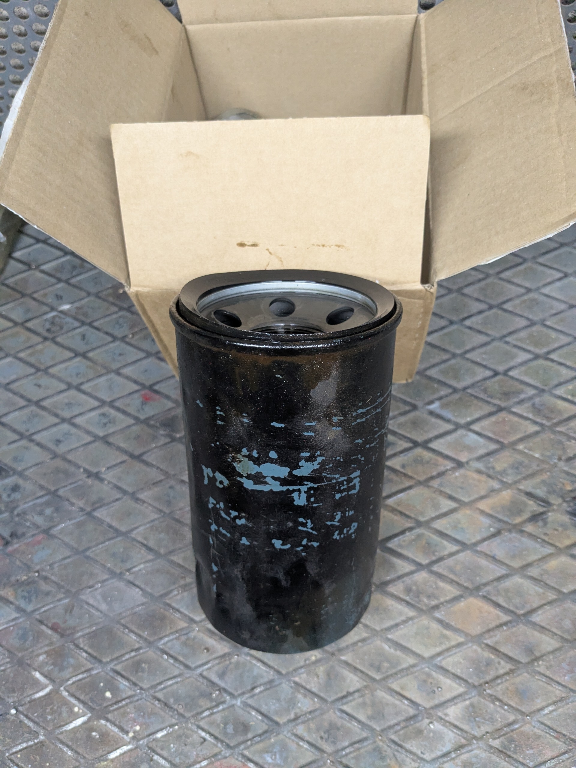

I also removed that filter thinking it had the reference number written on it, but it's completely painted over, so I can't see the reference number.
Can you tell me the filter reference number?
What system do these two filters I removed correspond to?

the strainer and spin on or both for the transmission/hydraulics. This is the filter I used on my old 2002D. I have no way of knowing whether it would fit your 1602D or not. I can only suspect it would. If you could compare the part # for the 1602 and 2002 you could know for sure. Just make sure you get a filter with a good flow range.
This information says they use the same filter. Yanmar Tractor Hydraulic Filter, Spin-on Replaces 194250-48310
