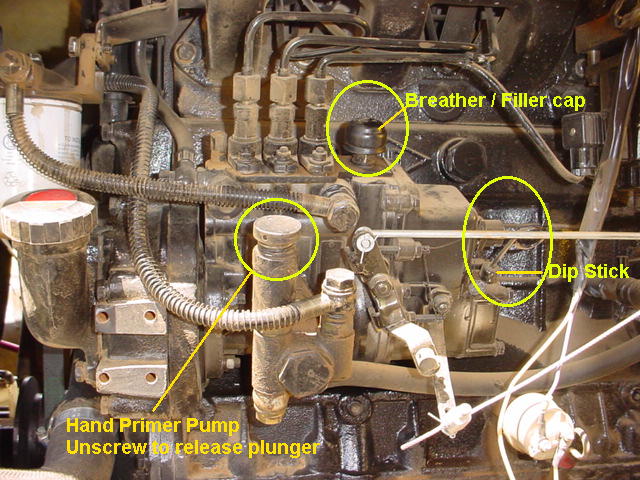

"I have the TY395T engine." - Me too
Attached are photos of the Injector from my 2005 Jinma 354LE with EPA engine.
Picture 1

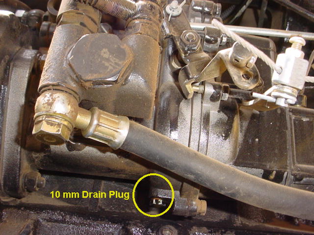

Picture # 2 showing the 10 mm Drain Plug.

That is it. Thanks!!!
My thanks to all who contribute to this board.
Phil

<font color="blue">Attached are photos of the Injector from my 2005 Jinma 354LE with EPA engine </font>
Hey GuglioLS,
Those photos are absolutely superb. A+
Get you Tractors Running &
Have a nice day,
Joe /forums/images/graemlins/cool.gif
