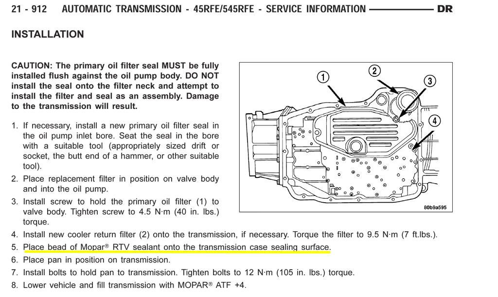

I had the auto transmission (2500 Dodge Ram Cummins - 47RE) serviced about a year ago and had the repair shop install a new OEM transmission gasket (which i was thinking was rubber-ish)..
It appears that the pan is now leaking so I may need to drop the pan and do something with the gasket so it stops (after I check to make sure the bolts are not loose)..
Do you recommend using a new gasket OR making my own gasket with Permatex High Temp Red RTV gasket maker?
Specs call for 13/ft-lbs for the gasket but the RTV says something like - outline pan edge and around the bolt holes, let it set up, tighten until it oozes out.. Wait an hour and then tighten another 1/2 to 3/4 turn..
I have never used RVT before and not so sure about the bolts not being very tight - which method would least likely leak?
Brian
A cork/rubber gasket is the best type gasket because the cork is just a better sealer and after oil gets near it the rubber swells up and helps keep the gasket under tension.
With that said RTV is a better sealer on a tin pan. Just pound out the bolt holes backwards slightly with a tap hammer so the hole pulls in to the case. Clean the surfaces with brake clean real good and try to make sure the trany is done dripping when you do this add a light even smear RTV on the case and the biggest portion on the pan (like sticking 2 pieces of tape together) but remember you dont have to put more than 1/8" thick and just tighten it about 1/4" ratchet tight and leave it overnight if at all possible. hth also I use hi temp gray or black not the super high temp red stuff for what that is worth....

I would go strictly by what the manufacturer recommends, not the counter man at xyz auto parts or this is the way we always did it. Attached is the Factory service manual for current model Dodge truck since about 2002.
The 47RE is the same basic transmission.
