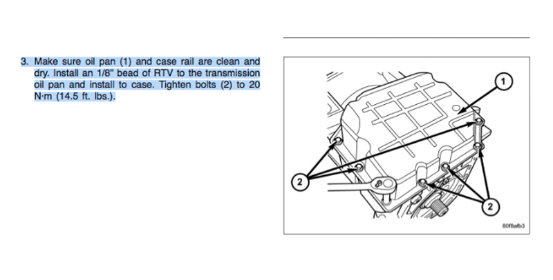

Gee, it doesn't say anything about cleaning the surface areas. If the manual doesn't say it, I guess we don't have to do it. So much for the manual.
I thought that that would be obvious to even the most amateur mechanic so I didn't post, but here it is for those who need it.
