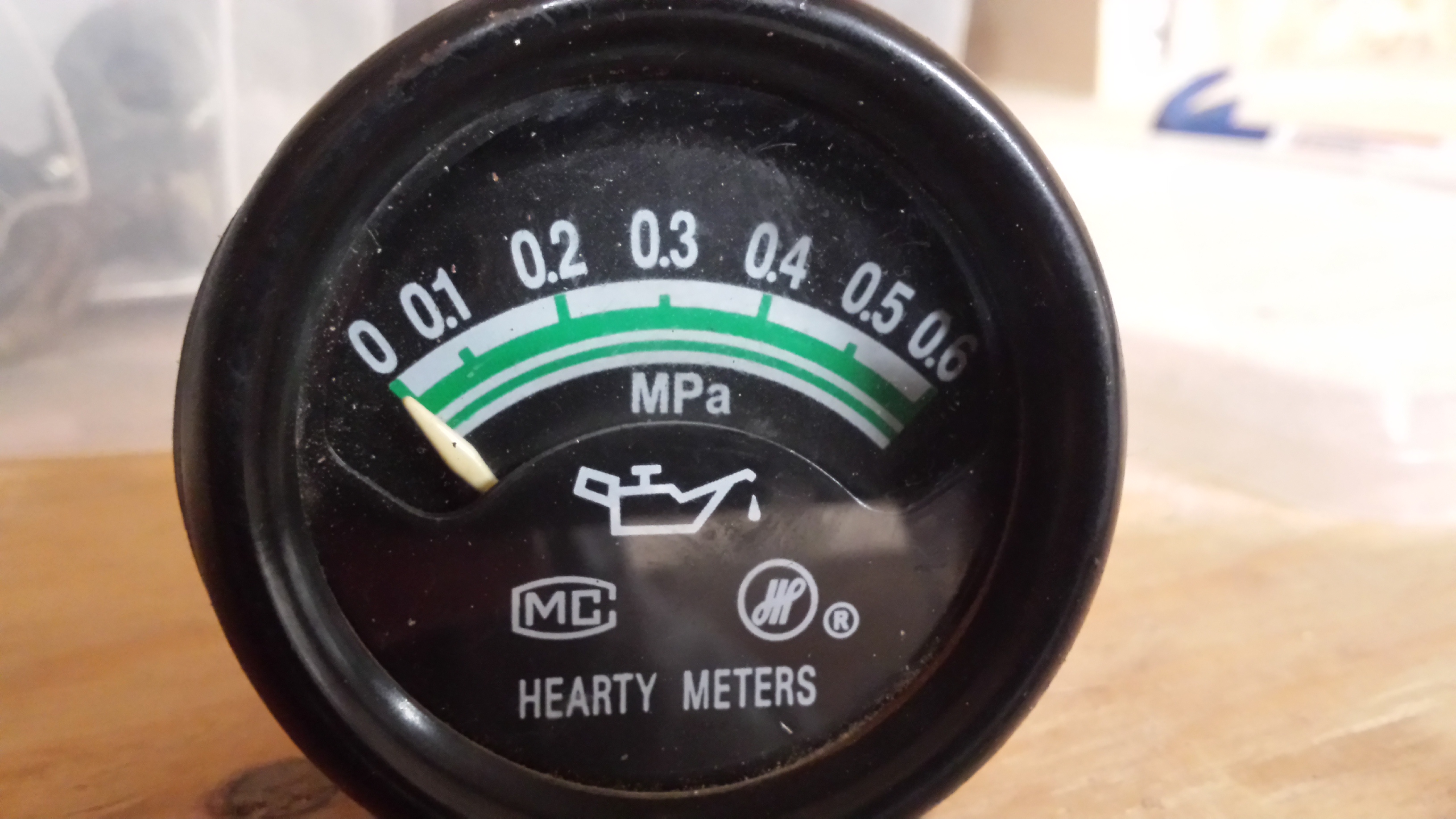

This is a Chinese oil pressure gauge.

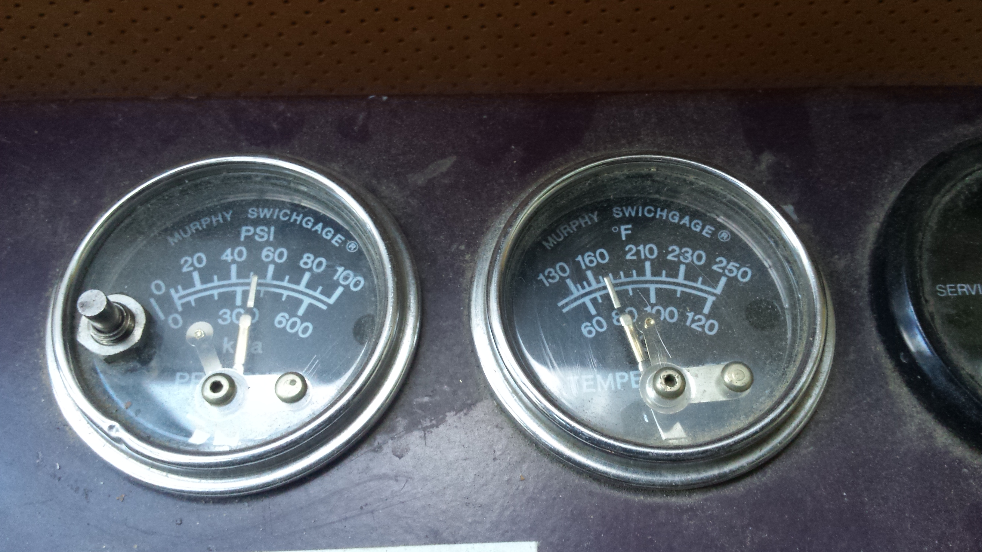

These are Murphy Swichgages connected to an alarm system that I installed on the excavator. It has a Mitsubishi 4K (40 hp) diesel engine with 1,296 hours on it. It is idling at operating temperature.

No continuity there. It must be .02 and .04mpa (20 and 40 kilo Pascals) ~ 3 and 6PSI. Sounds like pressure has always been low. Also, based on quicksandfarmer experience it appears there is a higher volume pump available ... or else one having tighter rotor clearance hence much less internal leakage.
