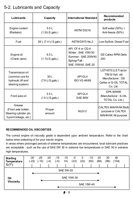

Hello LS enthusiasts,
I am doing the first oil change on my LS 3038. And I am wondering what you guys run for Oil? Is a 10w-30 better then a 15w-40? Or visa versa? I’d like to choose the Oil that has the best engine protection.
I know In my older tractors we ran 15-40, but I’m unsure about the new type engines.
Looking forward to your guys/gals input.
Patrick
/ Oil question #2
The weight is based on temperature. From your manual:
You need to ignore all the "this is what I use in other engines in who knows what climate" and refer to the manual. I put it into the above post.
There's no one size fits all answer, which is also stated in the manual. It is based on the operating conditions. Don't use what Joe Blow in this thread uses because you don't know if (s)he lives in Toronto or Phoenix. Use the excerpt from the manual and get the correct oil for your conditions. As for brand, dino vs blended vs synthetic, you'll have to decide for yourself on that. Anytime you ask about those specifics, you're going to get 100 different answers based on a sample size of 1 person.

I would not run a 15w in the winter in New Brunswick; not good for startup and oil flow before it is warm. As was mentioned; check your manual for the viscosity for cold weather. I run 5w 40 Rotella year round; I think a lot of guys do. The first number being low (5w) is better for cold weather starting and faster oil flow in cold weather. The second number (40) is the viscosity when the machine is warmed up to operating temperature. It is important to know what your manual say about these two numbers and not deviate from them too much.

Actually if that is also from his manual... it seems that 5w 40 is a one size fits solution according to the manual; which is why a lot of guys run it.
