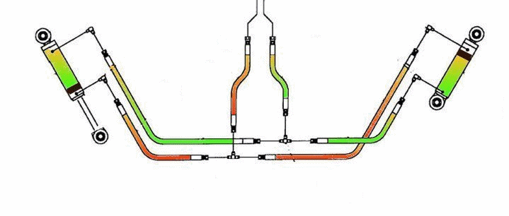

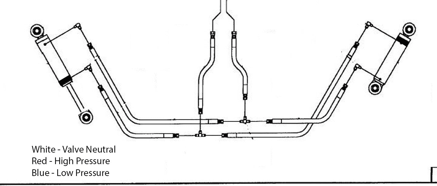

It was obvious in the pictorial in post 94 which way the machine would turn with the front at the bottom.
The machine would be in a continuous left circle.
Very few people display pictures from the view of looking up.
Anyway, I hope everyone knows where the fluid is going, and how the cyl are configured.
Black fluid? No one has every said anything similar. Milky colored maybe.

Okay, so I decided to take a break from the heat and figured I should learn how to make one of these GIF's (I hate MossRoad). Took way too long but now that I have it figured out, I could make a nicer one in much less time.
