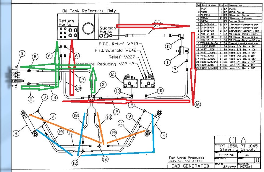

I've added some flow to the chart... hahaha.....
Red is the flow that feeds the steering pump.
Green feeds the FEL valve from the power beyond port on the steering valve.
Orange and Blue are steering.
See how the push on one cylinder is tied to the pull on the other cylinder and vice versa?
The oil never leaves that circuit except for a very little bit in the hoses near the steering valve.
Its like pouring a drink back and forth from glass to glass, the oil just goes back and forth between the cylinders.

So here is the diagram I was given. The thing is I don't see really any place for the oil to return on the steering pumps.
I don't feel sitting in the dirt has any real effect on the quality of the oil. But IMO it really looks like they have no way of getting fresh oil without a deliberate draining.
Item #3 is your steering valve.
Item #20 is your steering return to tank.
/ Oil Recirculation in closed loop system #30
The engine turns the aux pto pump.
The aux pto pump feeds the steering valve.
There is a power beyond port on the steering valve.
The power beyond port feeds the FEL/aux pto valve.
The oil flows out of the FEL/aux pto valve back to the tank.
Is that the path you're looking for?

Ken and MR: I don't know if this helps, but...
As I see it, the video is correct, although a bit pedantic for my tastes. His simulation of the volume changes due to weight are exaggerated to make the point. For all practical purposes hydraulic oil does not compress, and steel cylinders do not bow outwards. Technically, yes.
On to MR's diagram and the specific case of PTs, at least those with dual steering cylinders; imagine trying to turn. As the diagram illustrates, the two cylinders are connect crossways. If you look at the flow carefully, I think that you will see that when you are trying to steer that oil flows into both cylinders and it flows out of both cylinders to the tank during the operation, but in an "X" fashion, i.e. FR&LR are tied together, and FR&LF are tied, so that to steer, one pair drains to tank, while one pair gets applied oil at high pressure. In detail:
For the steering, the cylinders are tied front one side to back side on theater, i.e. the left push is tied to the right pull and vice versa. To steer, you just swap where you are applying the power. i.e. High pressure in left front half, is tied to high pressure into right rear that combined will cause the left cylinder to contract and the right cylinder to lengthen. (At the same time, oil flows out of the left back half and the front right half to tank.)​
Hopefully, this isn't as clear as mud.

Moss, In your description, what provides the driving force? It has to be the pump. That means there has to be flow back to the pump or to the pump via the tank. If it just goes back to the pump, then you can have a basically closed circuit with little exchange except due to leakage/makeup. But the flow can not be from one cylinder into another cylinder directly because you would have a lower pressure trying to outfight a higher pressure. As an aside, you would actually get some mixing though even with a 200 psi differential which I find amazing - we have pressurized systems that are O2 free that will get contaminated with minute traces of O2 from the air when there is the most minuscule of a leak. These systems are so sensitive to O2 that we can tell when it happens.
Ken
/ Oil Recirculation in closed loop system #36
Ken
The steering pump is always pumping. It never stops. It can't stop. So, when you are not moving the steering wheel, or operating the FEL or aux PTO, the full flow of the pump goes straight through the steering valve and back to the tank.
If you turn the steering wheel, the pressure becomes available to the steering rams. That doesn't mean much (if any) of the flow is going to the rams at all, just the pressure.

/ Oil Recirculation in closed loop system #40
I don't agree.
The steering is available at all times, and has priority.
The FEL get the PB fluid from the steering valve.
The fluid is flowing through the steering valve through the FEL, then to tank.
You always have volume in GPM, the hyd components develop the pressure.
