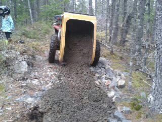

Test #3
I cut out the little gussets on the bottom corners, and tightened the hitch nut one full turn. Good news is that the hitch didn't come off when the trailer was dumped... the bad news is that at least half the load stayed in. I made sure to choose finer material just to make sure it wasn't anything to do with that.
Guess I'll stop in and get some hinges and sliding latches tomorrow. I really hoped to avoid this. :(

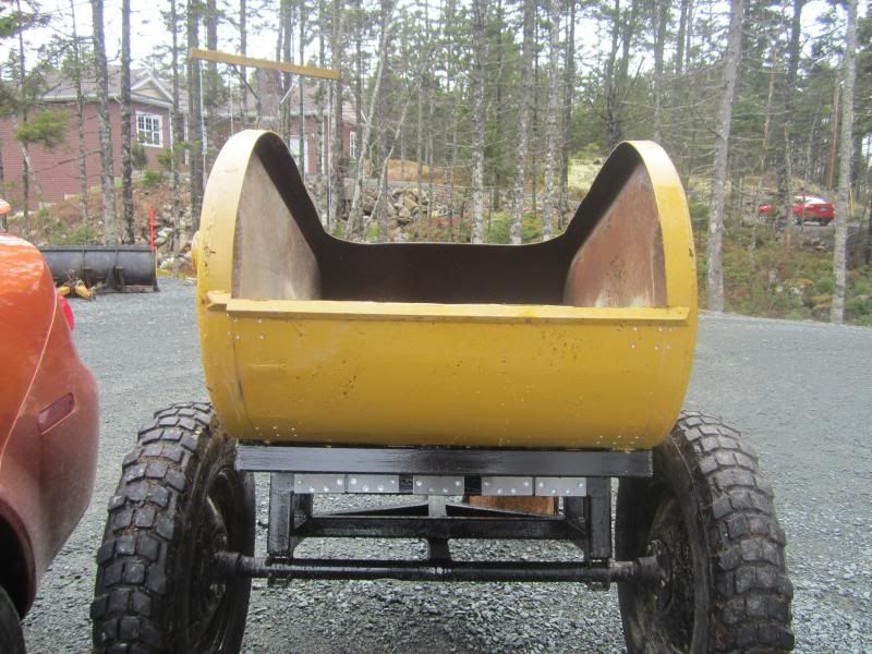

   / Oil tank atv dump trailer
#65

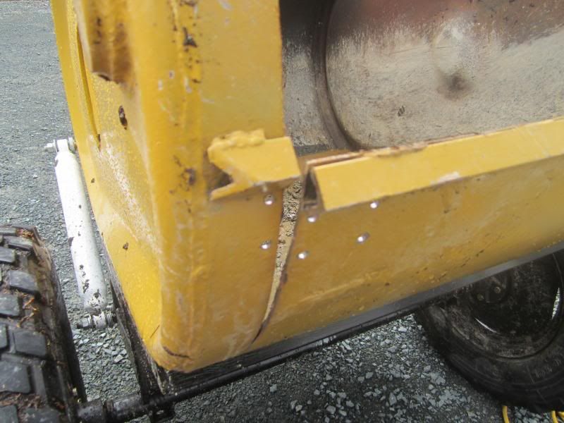

Before
So, started cutting, and as I suspected, there was some stress in the bend
Too wet to give the mods a try... hopefully sunday or monday.
   / Oil tank atv dump trailer #66
Looking good!
   / Oil tank atv dump trailer #67
I think you got it right now.
Looks good. Now go out and enjoy. :thumbsup:

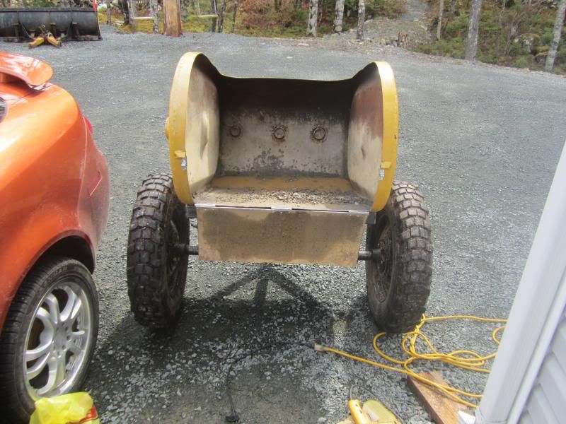

#68
It is working pretty good now... I'll have to try and get a vid.
Installed two pairs of tool holders;
They work great. Well worth having.
