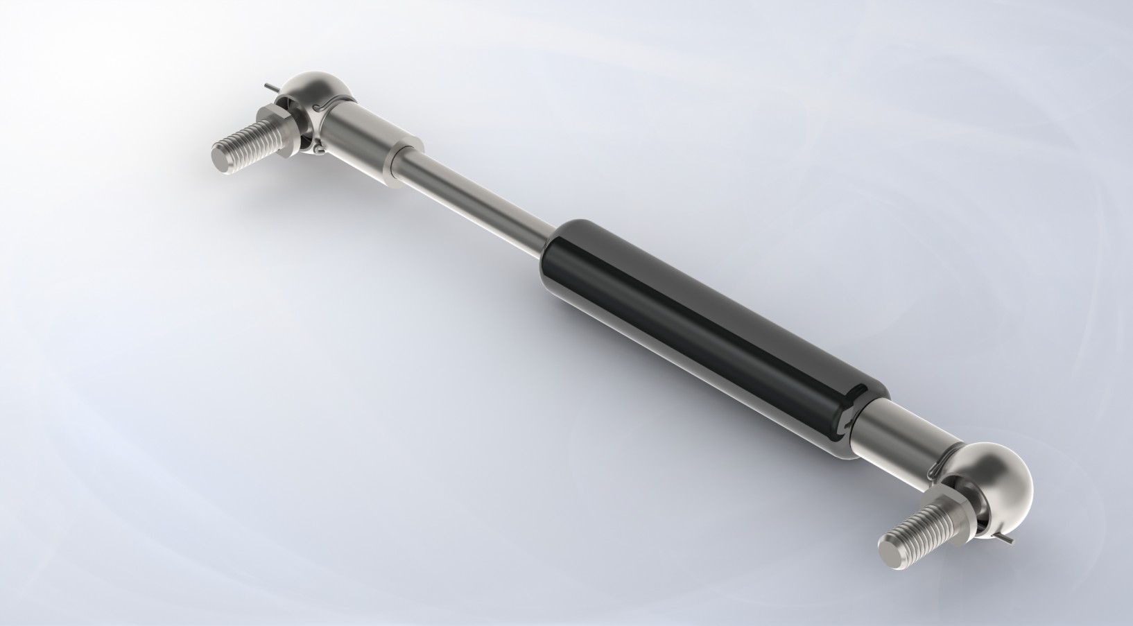

How about a piece of rubber where the frames come together?
The geometry doesn't look good for the shocks. My Polaris Ranger uses a gas strut on the dump bed.
