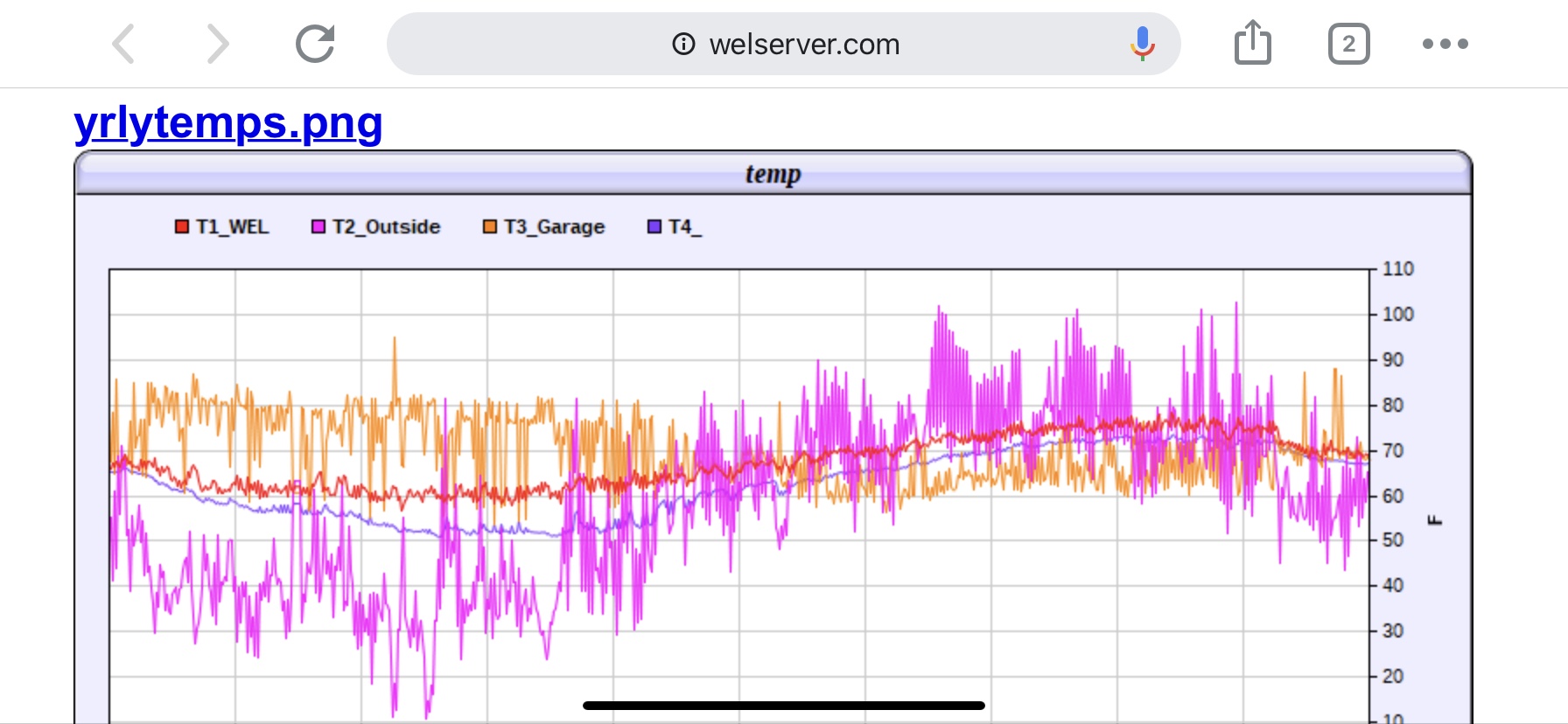

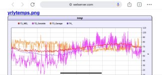

I also put in a monitoring system.
Welserver.com
I keep track of loop temps, runtimes.
