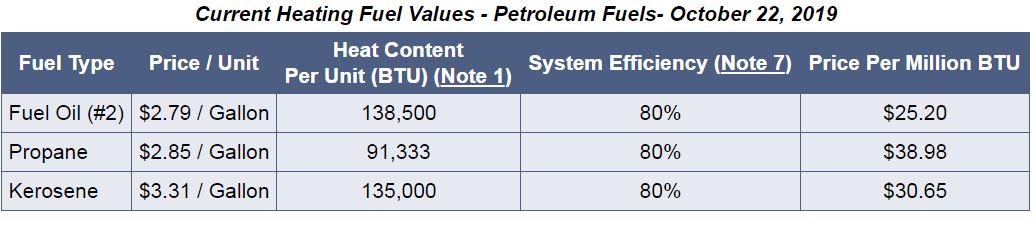

Maybe things are different where you are, but that's not how it works everywhere. I've had trouble getting suppliers to fill tanks owned by my last employer, and those who would had the highest prices. We finally got sick of the hassles and had one supplier drop their tank.
Prices vary a lot by region too, here are this week's average prices for kerosene, fuel oil & propane in N.H. As you can see, propane's no bargain here.

at a 35% consumption difference between fuel oil/propane it would be a wash with fuel oil costing $1.65/gallon. This is assuming you're comparing same efficiency furnaces. There are oil furnaces that are 96% efficient so you would be better off with an oil burner if you can't get that price all the time. My area sells fuel oil mix for $1.99/gallon and $2.10/gallon for propane.
At 100% efficiency you're producing the same amount of heat as an oil burner at 65% efficiency. My oil furnace is 88% efficiency rating so I would be getting 23% more heat per gallon of fuel oil.
but i filled my tank at $1.05 per gallon last summer. not 2.09
