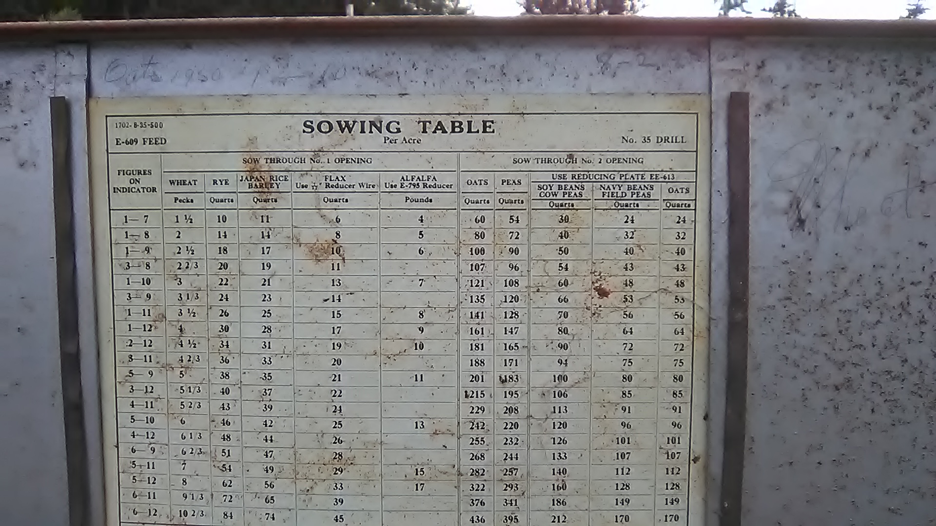

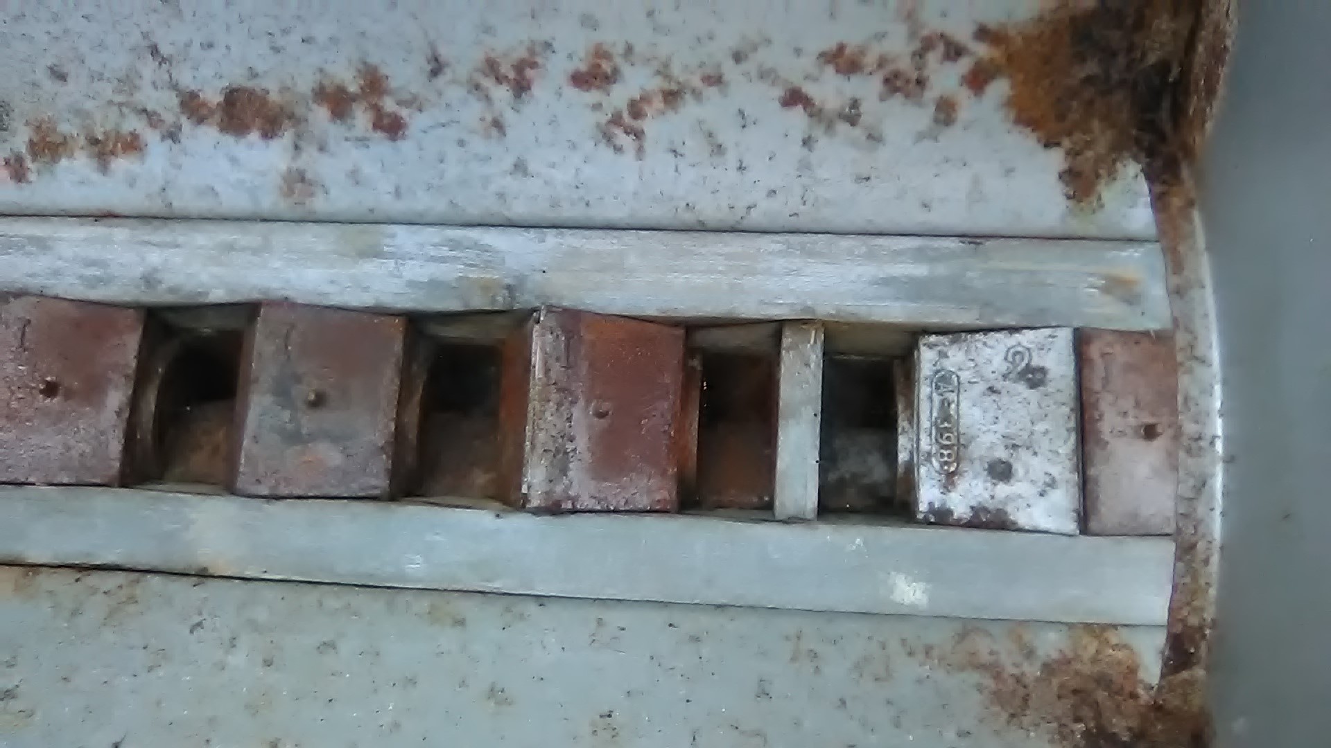

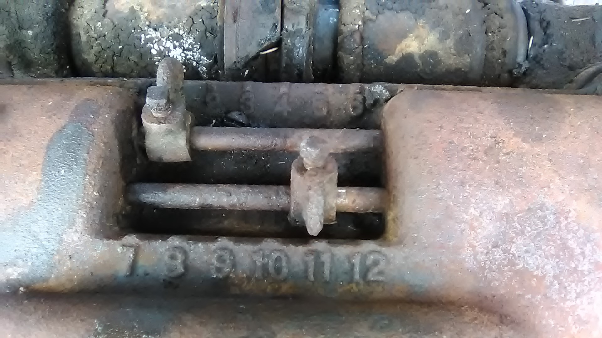

With the gear boxes filled with oil again, I think I am almost ready to start seeding, except for I am trying to figure out how it needs to be set as far as the seeding rate, and also the direction that the plates inside the seed bin need to be. I have 2 fifty pound bags of buckwheat to seed, and was going to plant 100 lbs. of seed per acre. I guess I can weight 25 lbs. of seed and measure how many quarts this is, multiply by 4, and use this figure to compare to the chart
The plates have a number 1 or 2 when facing up, depending on what direction they are flipped. There was fine seed in the grain bin when I got it and the plates were flipped so that the 1 was showing. I am guessing this means that if the 1 is showing, the 2 opening is covered by the flap.
I have never used a grain drill before, so would be thankful for any useful advice.
Sorry for editing the post. Needed to think about it a bit more.

I put the settings at 1 and 8. The grain drill worked as it should. I will know more when the seed comes up. It sure beats broadcasting the seed by hand, like I had to do before. I wondered what I had gotten myself into when I got it at an auction a while back, though it was all there, and just needed a bit of TLC.

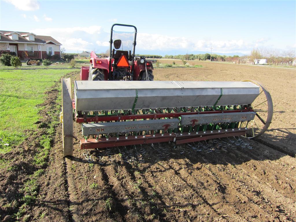

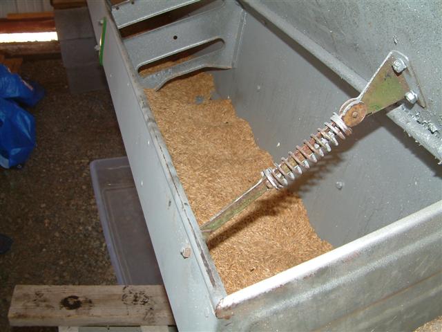

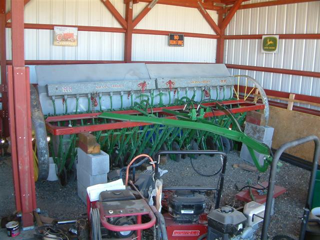

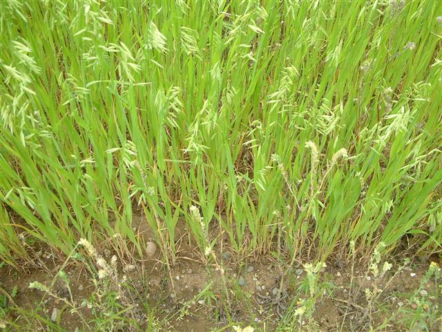

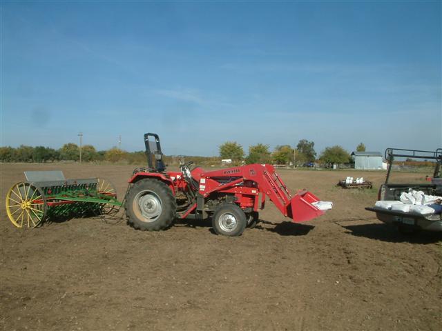

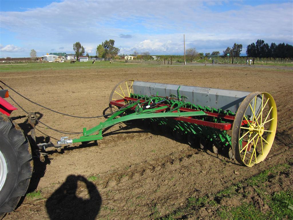

Here are a few photos of a Minneapolis Moline P3-6 grain drill I refurbished about 10 years ago. Bought two of these from a neighbor for $250. Both were restored. Parked one on my front lawn. It's 10 ft wide, 20 drops, single disc openers.
M5525 drill---3.JPGM5525  drill-1.JPGDrill-6.JPGDrill cal-3.JPGDrill cal-2.JPGDrill cal-1.JPGKanota oats-1.JPGKanota oats-2.JPG

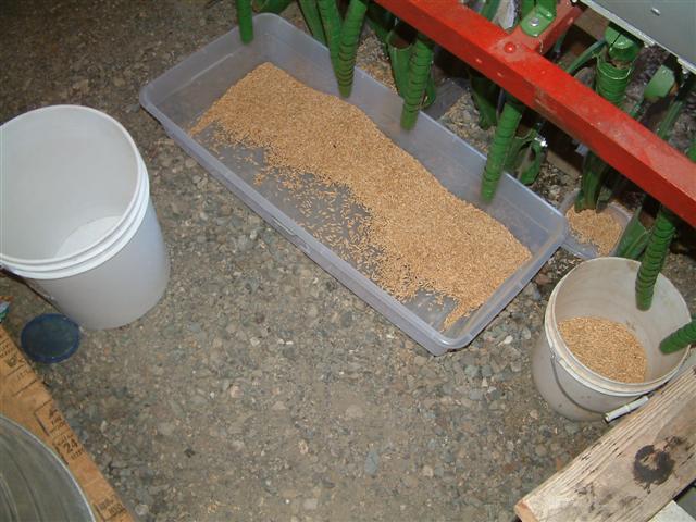

I calibrated the feed mechanism by jacking up the drill, putting a weighed amount of grain in the hopper and counting the number of turns of the drive wheel to empty the hopper. Knowing the diameter of the drive wheel (4 ft) and calculating the perimeter of the wheel (diameter X pi) and using the width and number of turns, you calculate the area and then divide weight of seed by area to get pounds per acre. There are other ways to do this, but I think this is the most accurate way for a drill like this.
The photos show the seeding result using Kanota oats.
The tractor is a 2008 Mahindra 5525.
Be sure to lift the openers before making a turn. I installed a hydraulic ram for this job. It has two trip clutches with pull ropes but that was a little too authentic for me.
Good luck

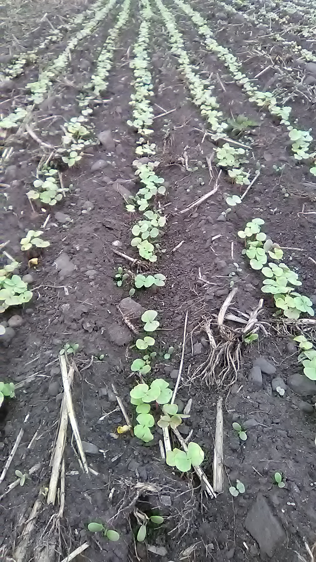

Here's a photo of the buckwheat seeding rate.
I would use the 1-7 settings I think next time. The seeding depth seems to have been OK.

I agree. Thanks for the followup pic.
