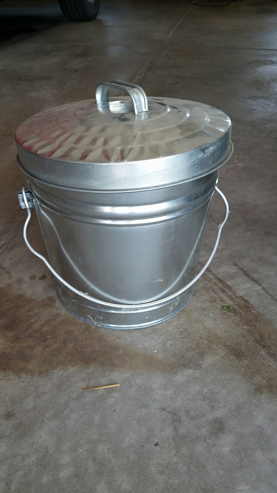

I've always been told bu various wood workers to soak your oily rags in water to prevent them from spontaneous combustion. But nobody ever told me what to do next.
I have about a dozen rags and 2 pair of disposable gloves, all soaked with Boiled Linseed Oil, soaking in 2 gallons of water. All this is in a tin bucket with a fairly tight lid.
Today is garbage-eve and I need to make room for more rags in the tin can.
Is it safe to toss the rags into the trash now that they have been soaking in water? What about the water? I don't think (?) I want to dump it down the floor drain, it dumps into the house sump pump. I don't thing (?) I want it going into my septic tank.
What is the smart thing to do?

All the official instructions are going to tell you to keep them in a fireproof container and then take them to a licensed hazardous disposal site. About 1% of us are actually going to do this.
I don't even bother with the water. I collect them in a metal container and when I'm done for the day, I burn them, either in a burn pit or my wood stove.

Perhaps just spread/lay the rags out on the driveway till morning? They usually only combust when all stacked together and where they can generate internal heat. As to the water, you can just use it to water the weeds you may not want on your drive or walkways...

I don't want them hot in a can, so I hang them in the open air until they are dry, then into the garbage. It is the drying process that creates heat.

I would dry them. I don't know if soaking in water will inactivate the oil, or if the water will evaporate, then the oil will still be liquid and can generate heat as it oxidizes. Why take a risk on setting the trash truck on fire?

i would dry them out first. Chances are that you have removed a lot of the oil from them and that oil is now in your oil/water mix, but I would still dry them out by spreading them out on some non flammable surface (like my gravel drive) until they are dry, then trash them or burn them.

And next time I will skip the water part. Actually, that is what I have always done but with small jobs and one at a time, it was no big deal to lay them out to dry inside the garage. It's windy enough here that I will almost need a pile of rocks to hold them down if I put them outside.
