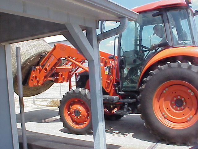

My M7040 & LA1353 loader with cast rear wheels weighs 7670#s
Same tractor/loader with bale on frt & rear 9630#s
Frt bale weighs 1090#s
rear bale weighs 870#s
Frt axle with bale on frt and bale on the rear 5380#s
Frt axle with bale on frt nothing on the rear 5990#s
I think rear counterbalance removes more weight from frt axles than I thought it would but I forgot to weigh the rear axle like I wanted to because I was getting distracted. I did the hard work Y'all do the MATH. My pawn shop camera malfunctioned and I only got one good photo. PS:I think my 79 year old tractor driver was asleep when I took photo.
