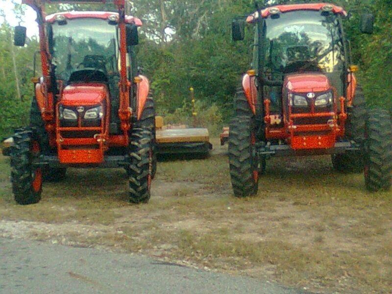

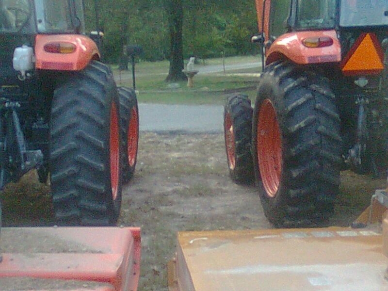

Load the rears and widen the stance some... 7040's side by side.JPG7040's side by side rear view.JPG
   / OK guys today was weight day to determine necessity for rear counterbalance
#30
I have a problem with widening the wheel tread. I'd then need to buy a wider tiller as my tiller is only 6' wide.
