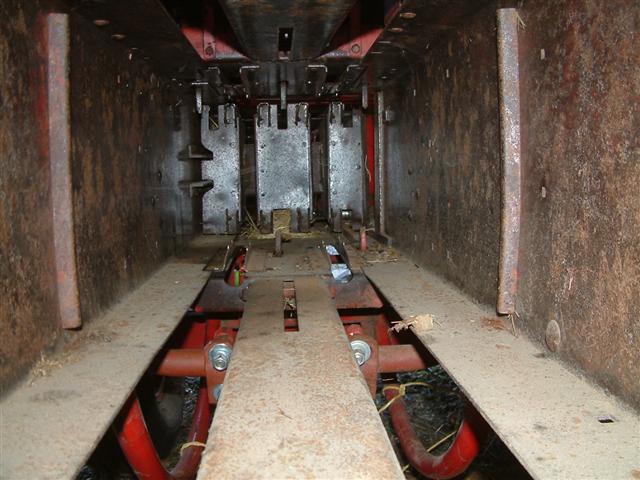

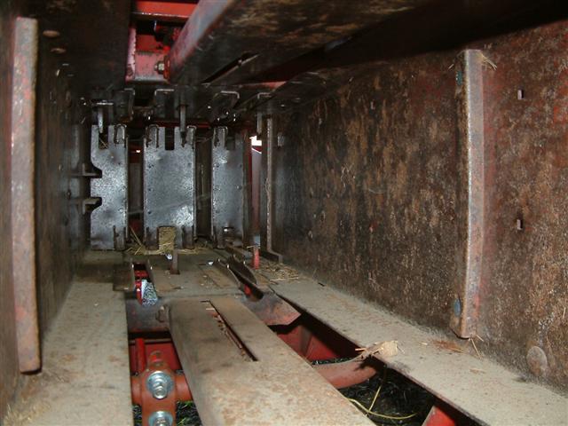

Also what are these wedges everyone is talking about?? why would you remove them and reinstall them? Is it depending on the hay your baling?
The wedges are installed on the walls of the baling chamber. Here's what they look like on my Massey Ferguson 124 baler.
Two wedges are in there now.

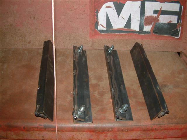

The 124 can accommodate 3 pairs of wedges. The baler only came with one pair so I welded up additional wedges using scrap steel angle and bar stock.
Wedges are handy when baling a dry crop that is not packing sufficiently tight. Usually you install the wedges in pairs.

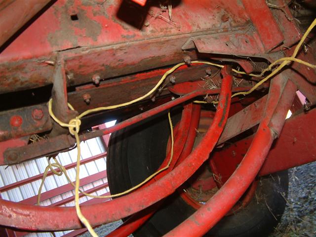

Ok that 1 stroke a second helps a ton to know, Now as far as running the twine it looks like the wrap it like 2-3 time around the needle or finger i guess ??? Does this seem right? It first goes through two porcelin eyelets before this ? Now I am going to try to bale a total of about 30-35 acres this year, does anyone know approx how many bales this will yeild? I want to make sure I have enough storage.Thanks Again

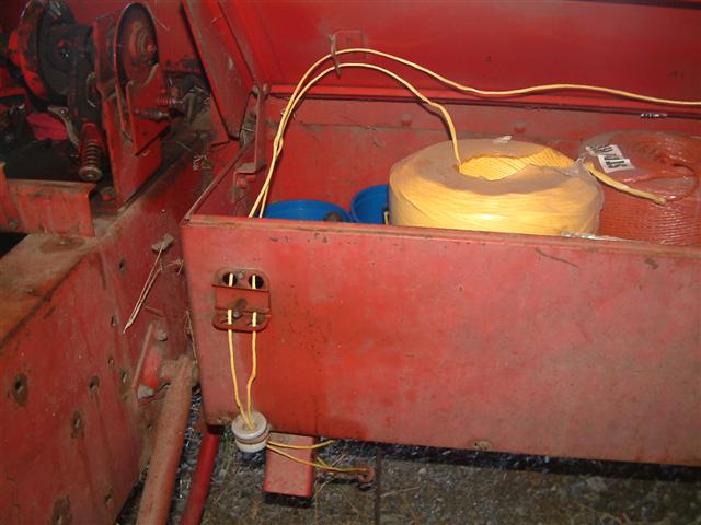

Threading the twine is pretty straightforward, but there are a few wrinkles.
Here's what it looks like with my MF124 two-twine baler.

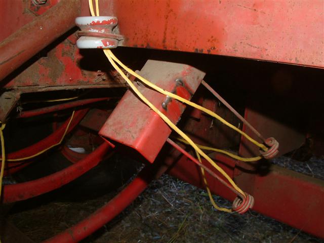

The two twines come out of the box and go through the twine tensioner (a simple spring-loaded clamp).
Then the twines go through those guides which are flexible. On the 124 you adjust the twine tensioner until those guides move 1.5 to 2.5 inches before the twine starts moving through the tensioner. It's a fairly crude adjustment, but it gets the job done. I know that the JD 14T baler specifies that the twine tensioner be set for 15 lb of drag on the twine.
Next the twines go through the eyes of the needles. You tie the ends of the twine onto one of the support brackets on the underside of the baling chamber.

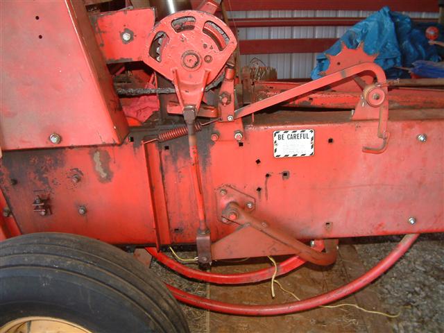

Then you go topside and spin the toothed metering wheel to raise the metering arm until it settles in the slot on the end of the arm (the arm is spring-loaded). This engages the clutch on the knotter drive shaft.
You then rotate the flywheel in the normal direction for baler operation. I do this by hand. The knotters will go through a complete cycle with the needles bringing the twine to the knotters which grab the twine in the twine holder, wrap the twine in the knotters and cuts the twine with the knotter knives (the knives have to be real sharp for this to work, so sharpen them if you haven't already). You end up with the knotters properly loaded with twine and two pieces of scrap twine under the baler. Untie the scrap and discard.
