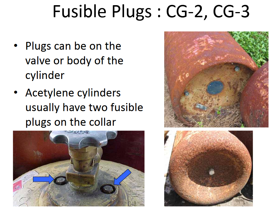

Bolted top plates are a standard feature. That is how they get the acetylene absorbent into the cylinder.
My suspection was correct, those are NOT bolts to hold the top plates on (not enough of them and they appear to be hollow with a lead core), they are relief plugs:
attachment.php
Source: https://trainex.org/osc2012/uploads/516/40_Sec 5 - Cylinder Identification 2.pdf (PDF page 24).

Boy, i am glad somebody figured out tanks arent bolted together! There's a disaster in the making!
Tanks are welded together. The porous mass is sort of pumped in on a vibrating table when it is mfg. Acetone is the liquid that acetylene is dissolved in. Swapping valves on an acetylene tanks is a ***** and involves a bit of danger. The tanks need to be empty to revalve anyway. Best not to monkey around with the things. I have seen the autopsy photos and damage from the "jobs gone wrong".
CGA 300 is still used in some places to keep cylinder fleets captive. Theres an obsolete british thread that looks like that too.
