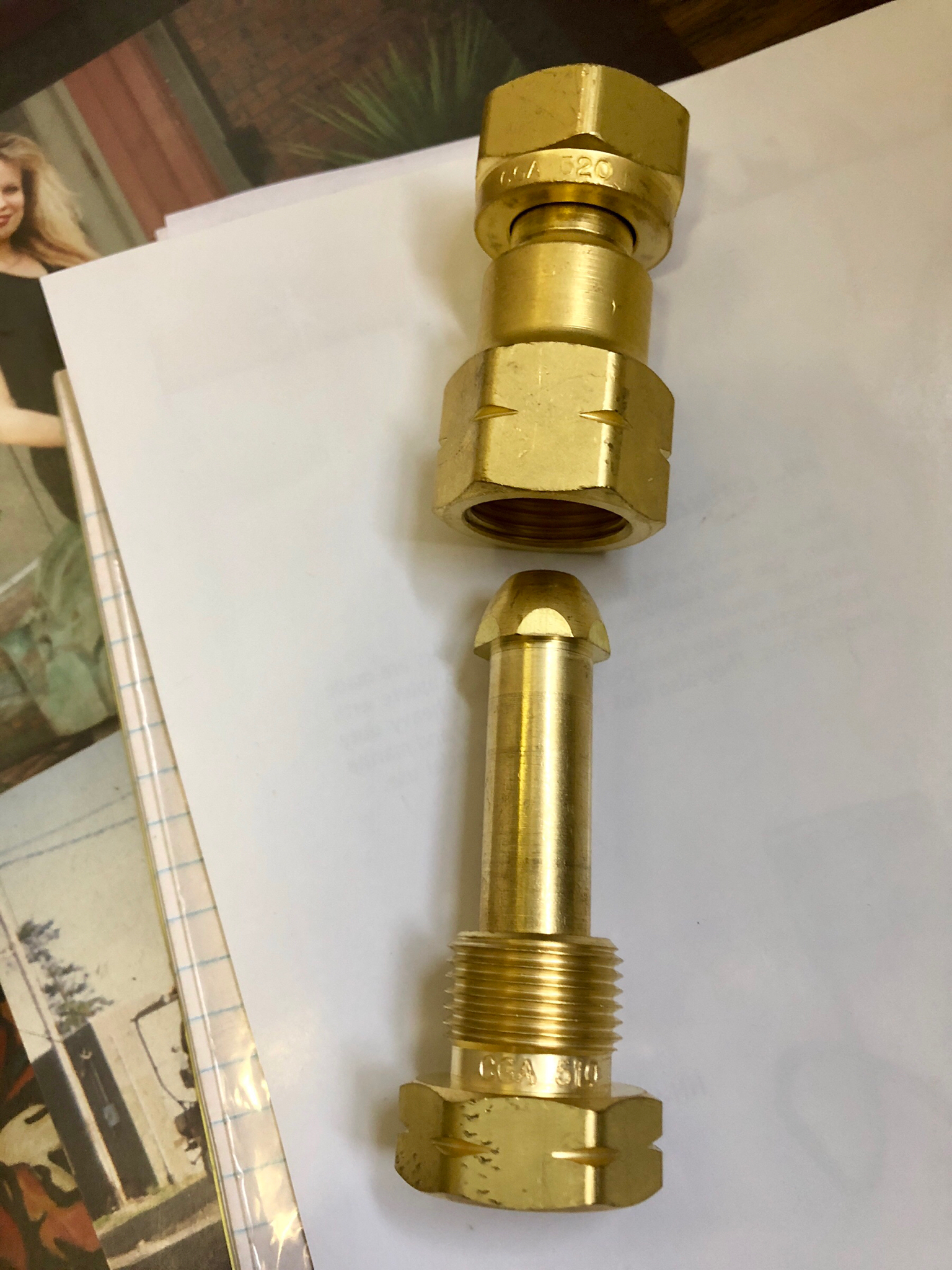

Just checked my stash. Here’s a CGA 510 Dale mentioned coupled to a CGA 520. IMG_2857.jpg

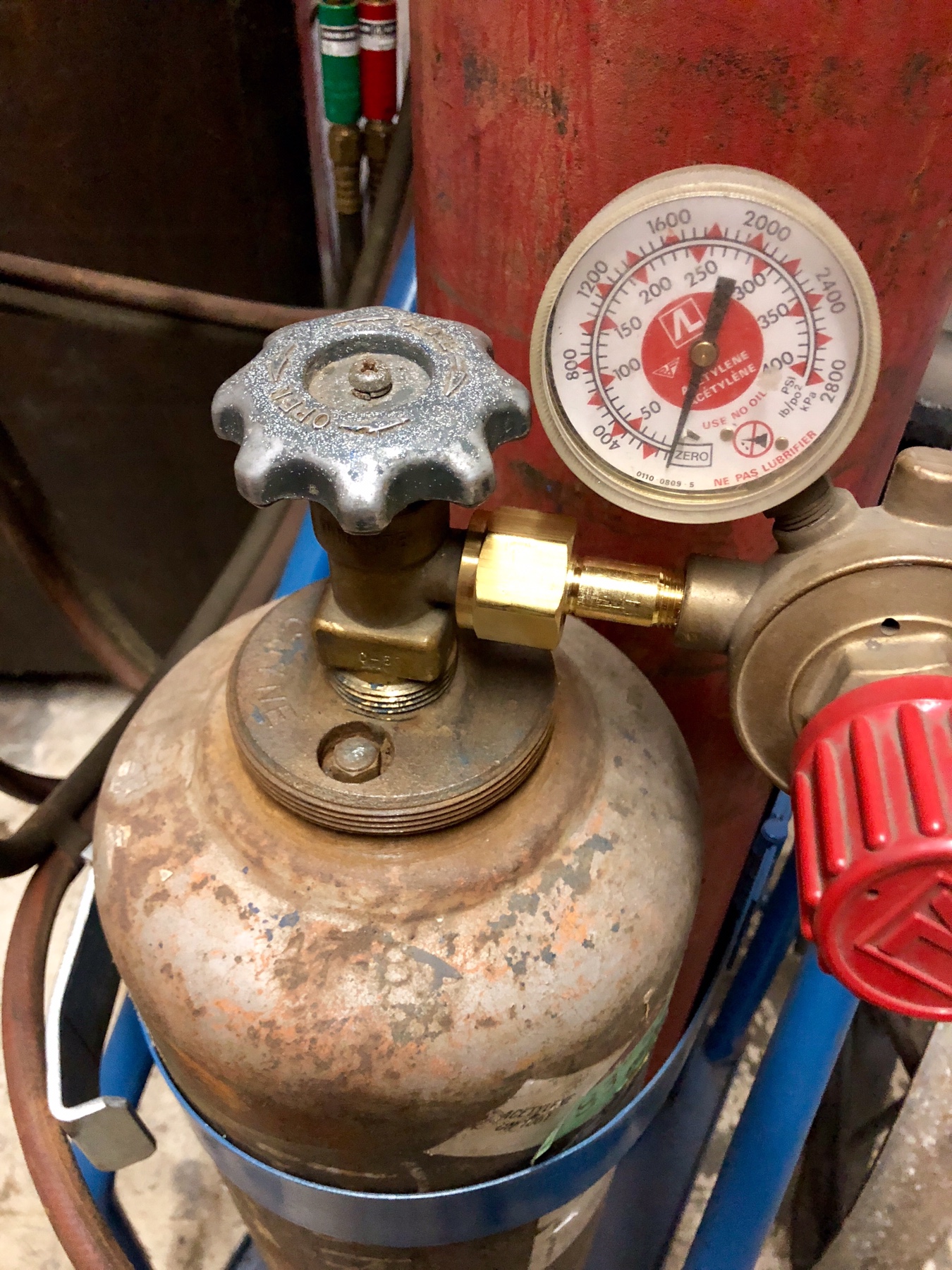

You might want to find out if you're going to able to swap this tank out for a full one or get it filled before you expend too much energy and money on it. It probably needs tested before another refill. I suppose if it's actually full it would be worth an adapter.
