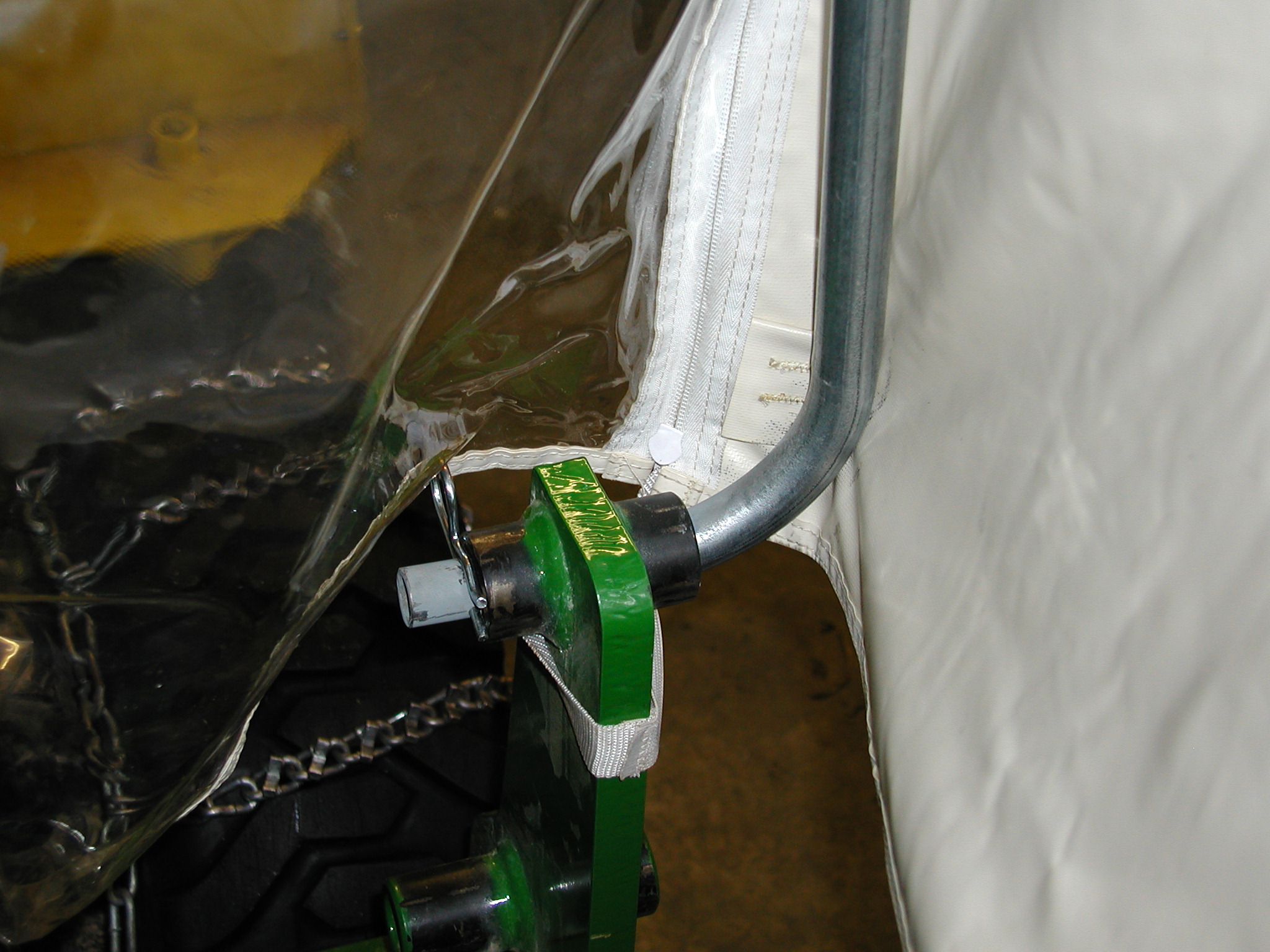

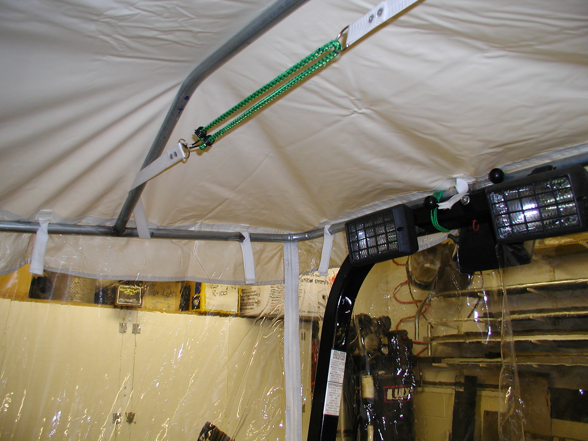

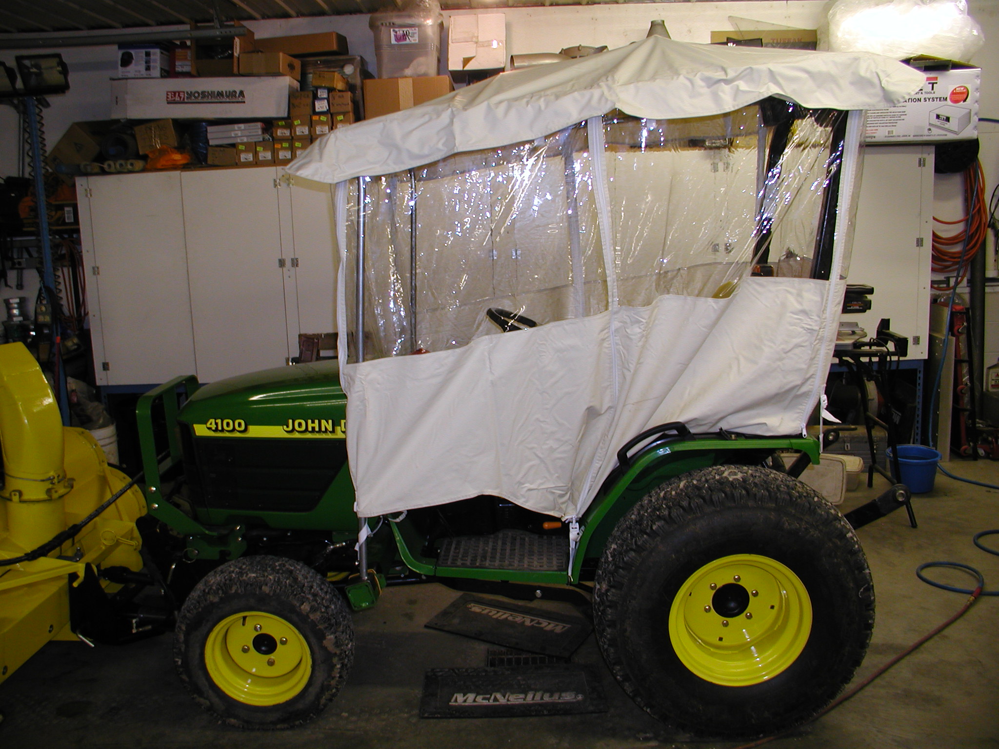

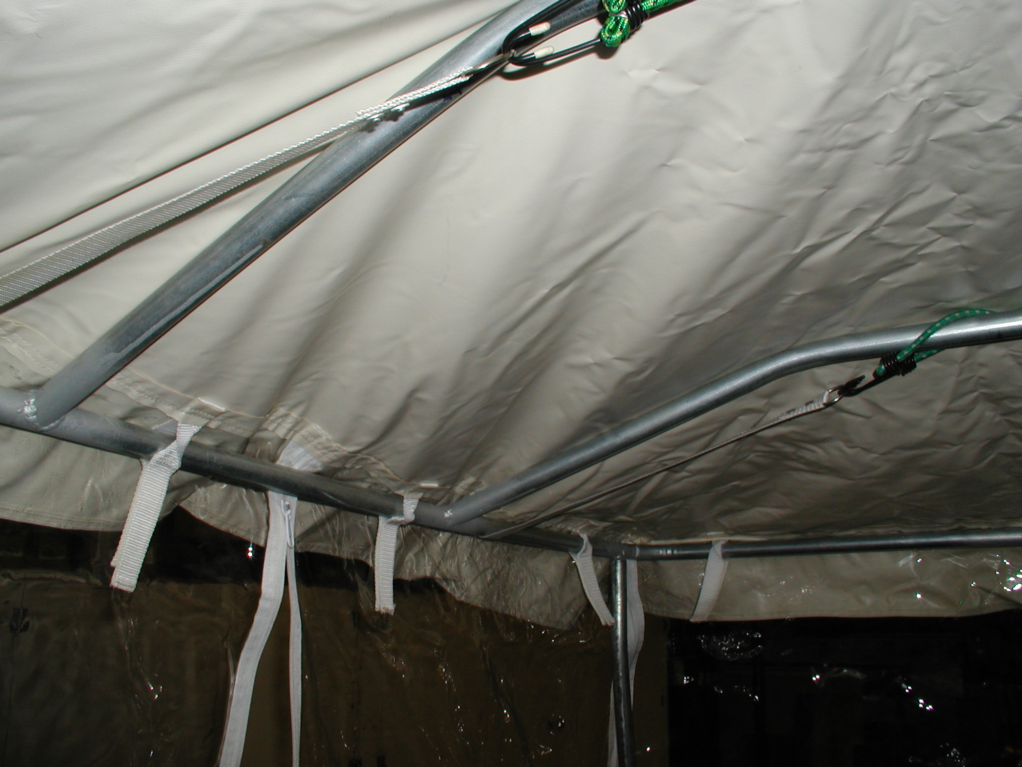

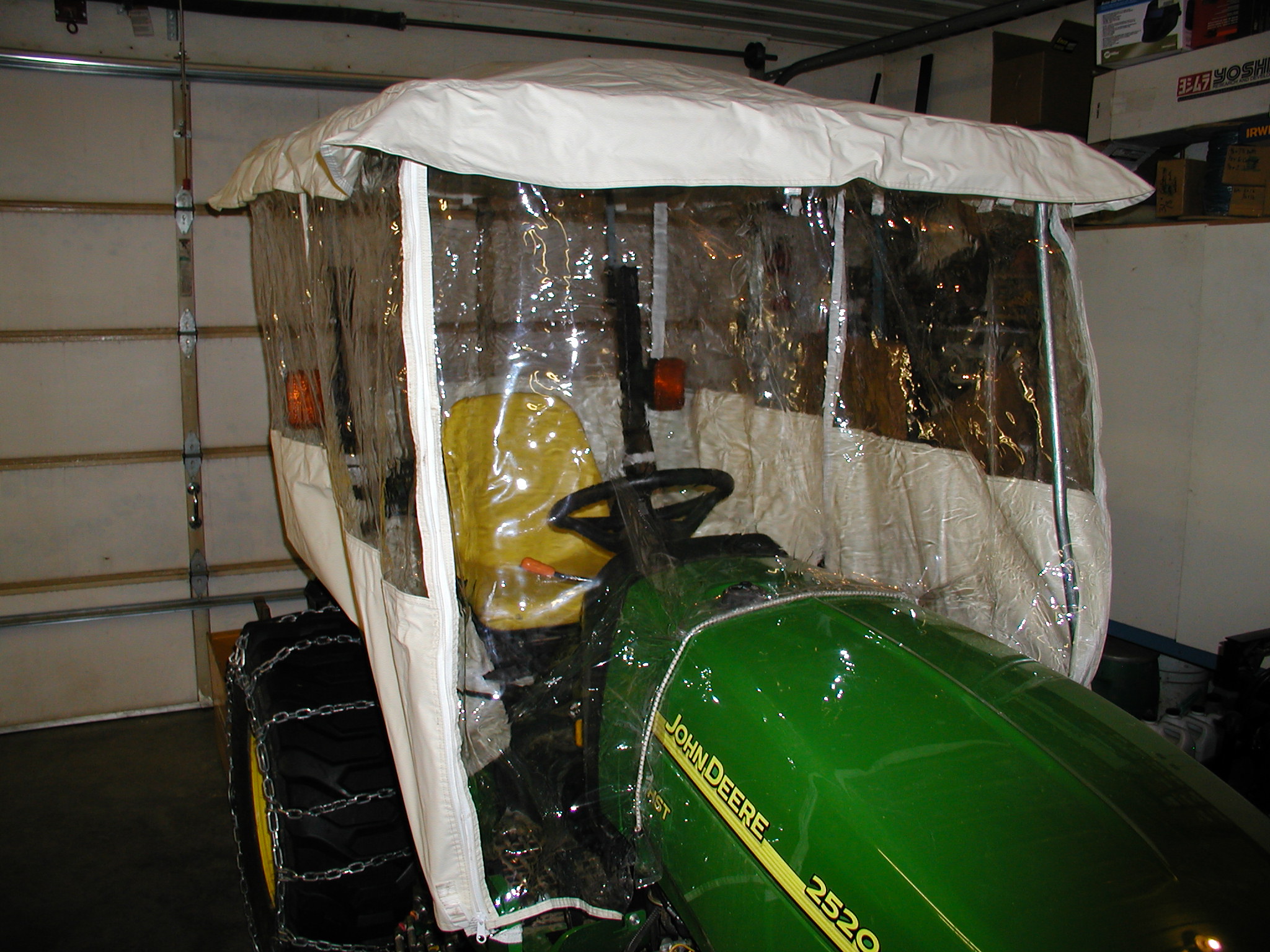

Joes vette: no cab, but added a quick and cheap golf cart rag top on homemade tubular framework. Will get some pics of that mounted on the 3720 soon for you guys. Meantime, I found some pics of the same golf cart cover mounted on first the 4100, then later on the 2520. Each time I adapt it, it gets less elaborate. I have learned that it doesnt have to seal up, just keep the snow from hitting my face and landing on my lap.
