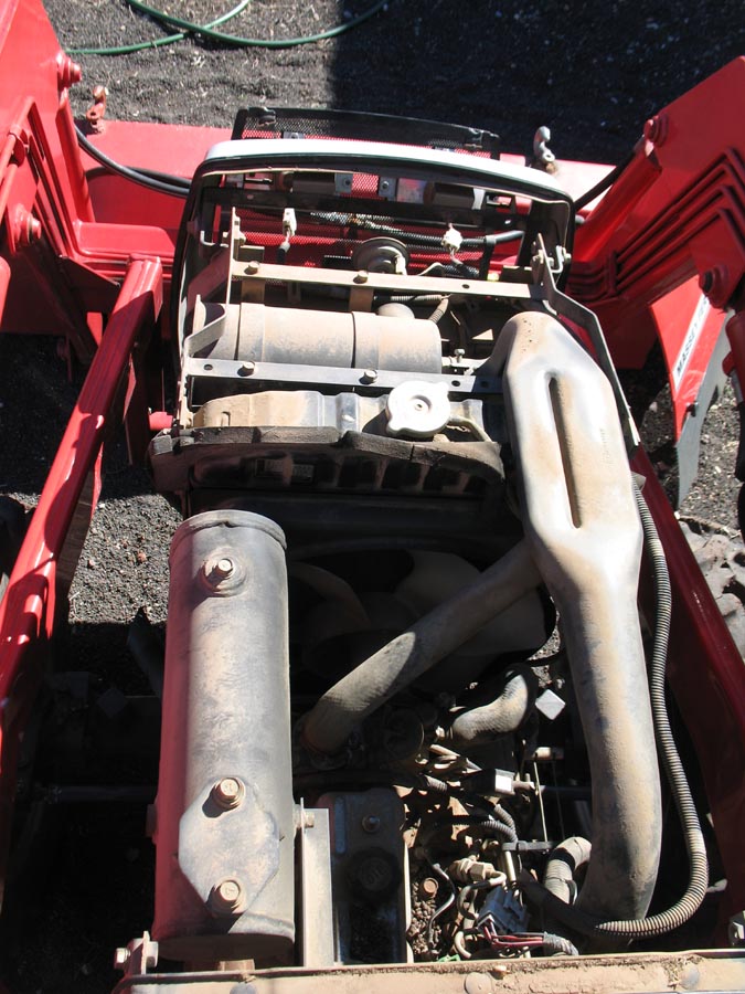

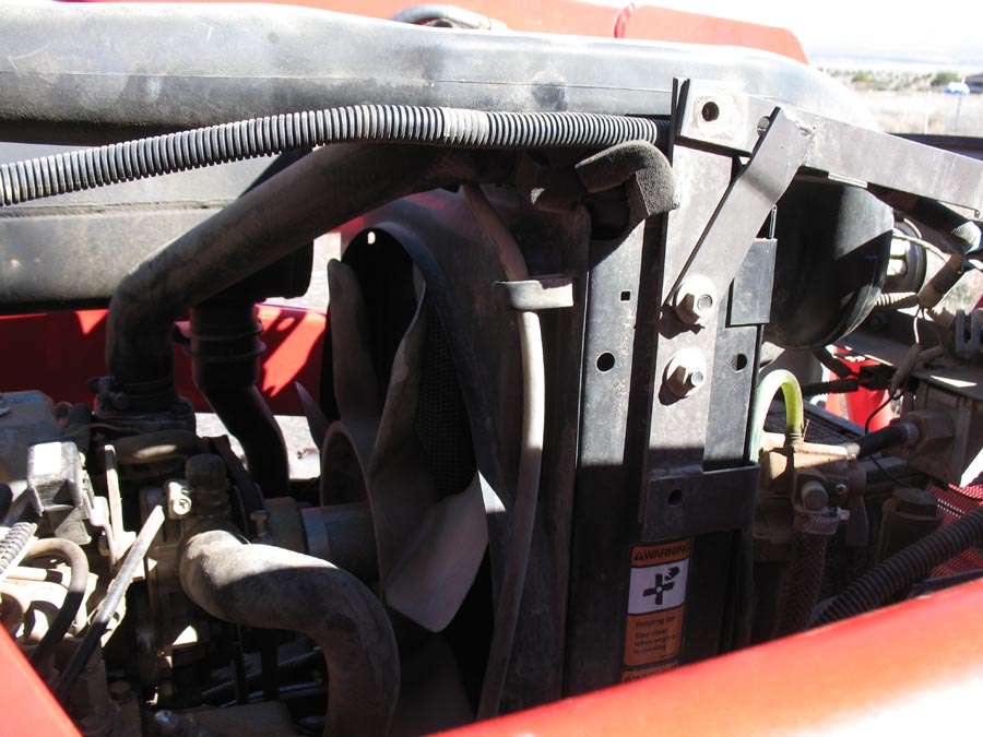

Had some time to delve into getting the radiator out. The service manual is about as usless as, well you fill in the blanks! Once I had the hood off, etc., here's what I was confronted with:
Nowhere in the manual does it mention the air cleaner tube and the bracket that holds both it and the radiator. Nor does it mention the fan shroud that has to be unbolted to hopefully give enough room to get the radiator out. There's also no petcock to drain it, so it's all going to flow out the lower hose connection.
What I've done so far is to remove the bolts from the air cleaner/radiator bracket, removed the air cleaner tube from where it goes into the engine (I covered the inlet hole very well so no dirt can get in there), and rotated the whole shebang up & toward the front of the compartment. :confused2: I have no idea if this will give me enough room.
It got real windy so didn't disconnect any hoses, 'cuz the coolant would have blown right passed the catch container and my nosey ol' chocolate lab would have found the puddle :licking:

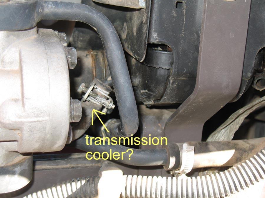

I found a small hose at the bottom of the radiator that I *think* is for the transmission? MF radiator7.JPG If it's disconnected, will all of the coolant behind it drain out? I plan on replacing all of it anyway, but need to know how big of a container to use.

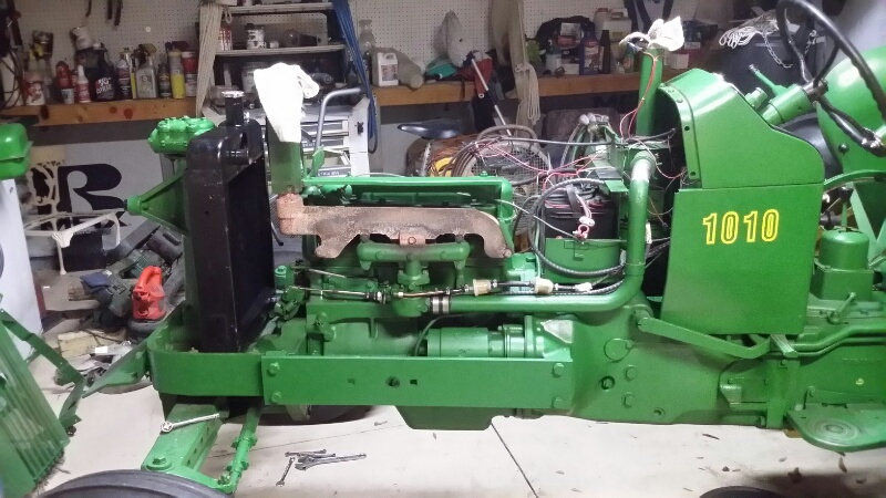

Sorry to hear about your radiator woes. I am in the process of fixing the kne on my old 1010 and I just got the radiator back from the shop yesterday. Total parts and labor with 1 yr warranty came to $297.00 unfortunatelly I did not have the option of buying a new one and the one recored one I found was going for $710.00:eek:
I am replacing all the hoses, the belt and thermostat like others have suggested. You might want to check the water pump, which I am replacing eventhough is working fine, it is so hard to get to it that I figured might as well get it done also.
Looks like you will have a few components to remove so you can get the radiator out but be glad is not as bad as mine, air intake, muffler, hood, gas tank, front grill and support brackets and even the darn steering shaft had to be remkved just to get to the darn radiator.:laughing:

I found a small hose at the bottom of the radiator that I *think* is for the transmission? If it's disconnected, will all of the coolant behind it drain out? I plan on replacing all of it anyway, but need to know how big of a container to use.
:D
If it is going to the transmission, there has to be another hose coming back to the radiator and will be transmission fluid in a separate core in the radiator, if it is done like trucks.
I have never seen it done that way on a tractor, but that only means that I have not seen it. :D
The oil coolers in my machines fit in front of the radiator.
