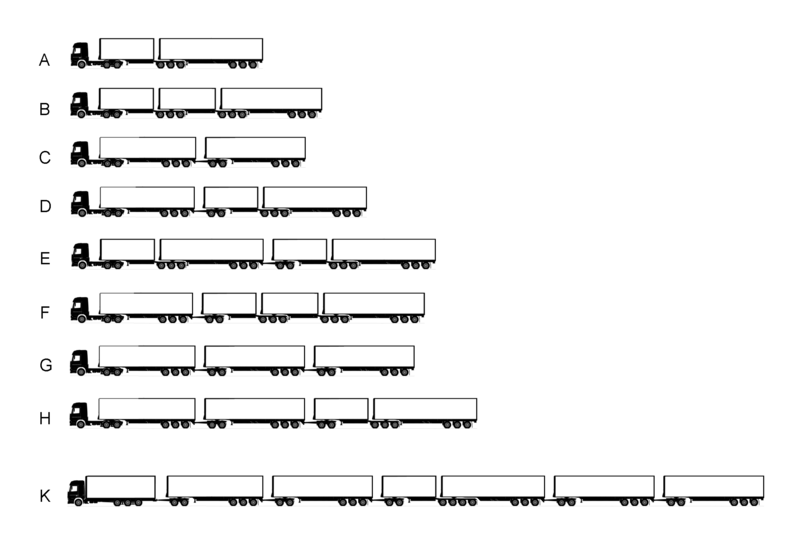

This is what the Aussie's can do (the "K" series is on private property only).
About the "K":
K represents the largest road trains operating in Australia, and therefore, the world. Called a "Powertrain" or a "Body and six", these machines operate at The Granites Gold Mine in the western Northern Territory, and are used in place of 200 t dump trucks, because of the distances involved on the haul run. A 600 hp 19 L Cummins engine powers the prime mover, whilst a 400 hp Cummins engine is installed in the rear trailer of the B-double, driving through an automatic transmission, giving a total of 1,000 hp. Weights of 460 t are achieved with ore loading in side-tipper bodies on a 62 mile round trip. As these trucks operate on private property, they are not subject to governed weight and length rulings, but instead are utilised in the most efficient way possible.

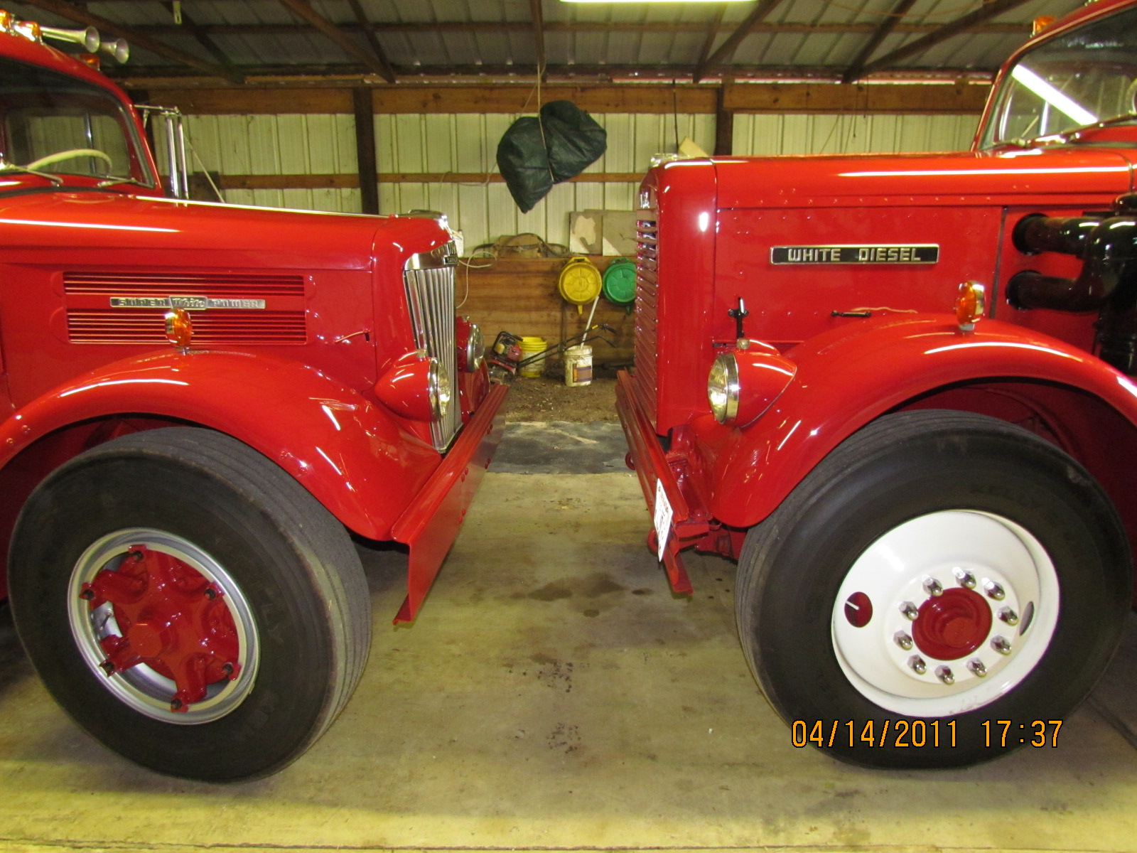

Those are called a Dayton wheel. Here's a comparison between the Dayton and Budd wheels. My '56 White WC22PLT on the left has Dayton wheels, the White 4400TD on the right has Budd wheels.

K represents the largest road trains operating in Australia, and therefore, the world. Called a "Powertrain" or a "Body and six"... used in place of 200 t dump trucks... A 600 hp 19 L Cummins engine powers the prime mover, whilst a 400 hp Cummins engine is installed in the rear trailer of the B-double
Is the second engine located in the trailer with four axles?
I hope their haul roads are wide! I've read that the Australian road trains whip around quite a bit. I can't imagine what it's like when two of the K-monsters meet and pass one another. How long are they?
I think a helper-engine arrangement was tried in Oregon a few years ago. Do you know anything about it?
Also - are the Australian offroad haulers the same giant trucks like were used for British Columbia log hauling on private roads? I saw those in BC long ago, and once saw one like those at a Chevron-Venezuela oilfield. No matter how long I stared at it I couldn't get my head around how big the thing really was. It looked at least half again wider than a road-legal truck.
