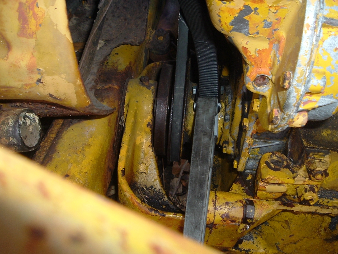

yes,I took the bolts out of the pump. the hub that bolted to the pulley is bottoming out against the thick frame. I will upload pics tomorrow. I don't have the grill in mine

I don't see any way to get to the pump shaft to un screw it even after removing the pump,no room
   / old MF-20 W/ mf 32 loader, alternator belt #9
Wow, I see the problems. Well, I guess unbolting the front end is the only choice. You might get some bolts that are a little longer than two of the buckle up bolts that hold the front end on. That way, you can just slide the front end out without fear of it flipping.
I don't see why there is such a gap on the crank pulley where you have your strap wrench. Usually, that gap is only about 1/2" or so. Yours looks like it is about an 1"-1 1/2". The crank pulley is secure on the crankshaft?

actually, after unbolting the hub from the pulley and prying it forward it's about 1/4" max. but I will double check the pulley to make sure it's tight on the crank
