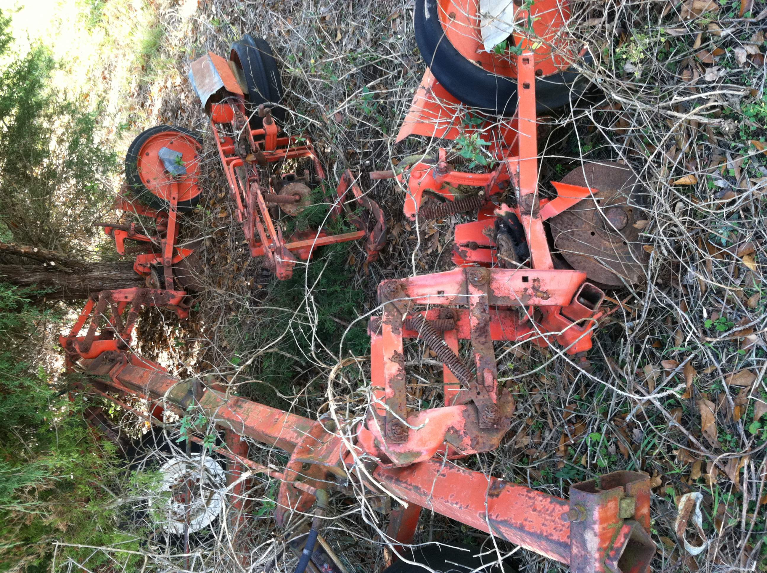

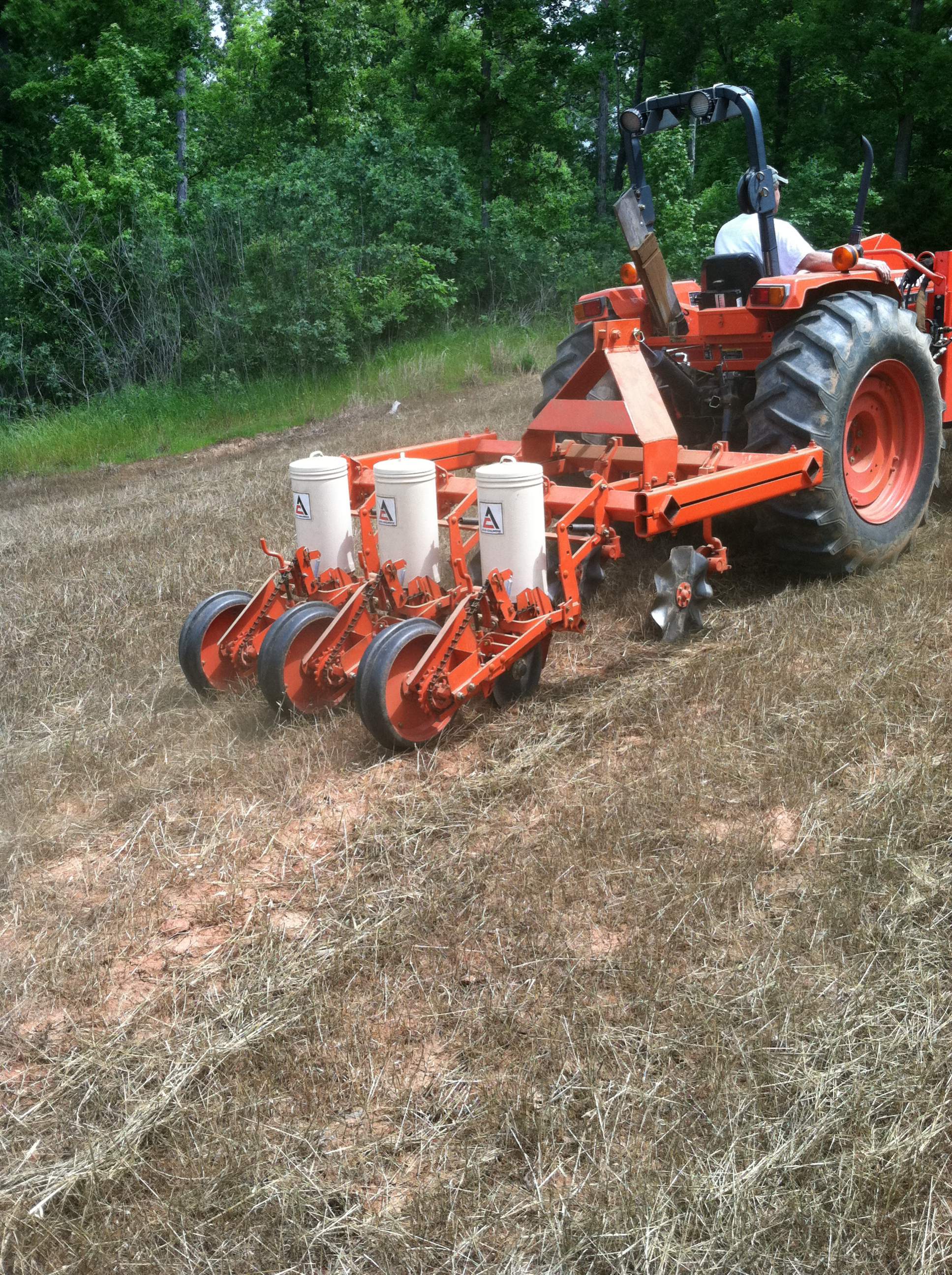

As you have read, I started with an old planter that had was parked for decades. After discovering it in the briar patch, I decided it had potential. After many hours of work, here is the end result! Works great. The no-til feature probably would have been a little better if we had waited for some rain to soften the ground, but considering how hard it was, it did pretty good. Planted soybeans and corn. We had to play with the depth and settings, and had some trouble with the old elasomeric dampeners breaking because of the age of the rubber, but we bolted them back together (which basically disables any "give" the coulters may have when encountering a rock) and they seemed to work fine. I wish I knew its history. The old farmer who owned it is dead, and his son has a big Great Plains drill, so he has no need for this. But I couldn't help thinking maybe the old farmer is smiling in heaven as he sees this old planter burying the seed, once again!

Wow! You did a nice job on thing. Glad to see you reap the reward of using it. Now you need another project!! ;)
   / Old planter hiding in the briars??? #85
Very nice! Love those action pictures. What corn variety and population did you end up planting? And yes, I agree with BrianR, you need a new project. :D Mark
