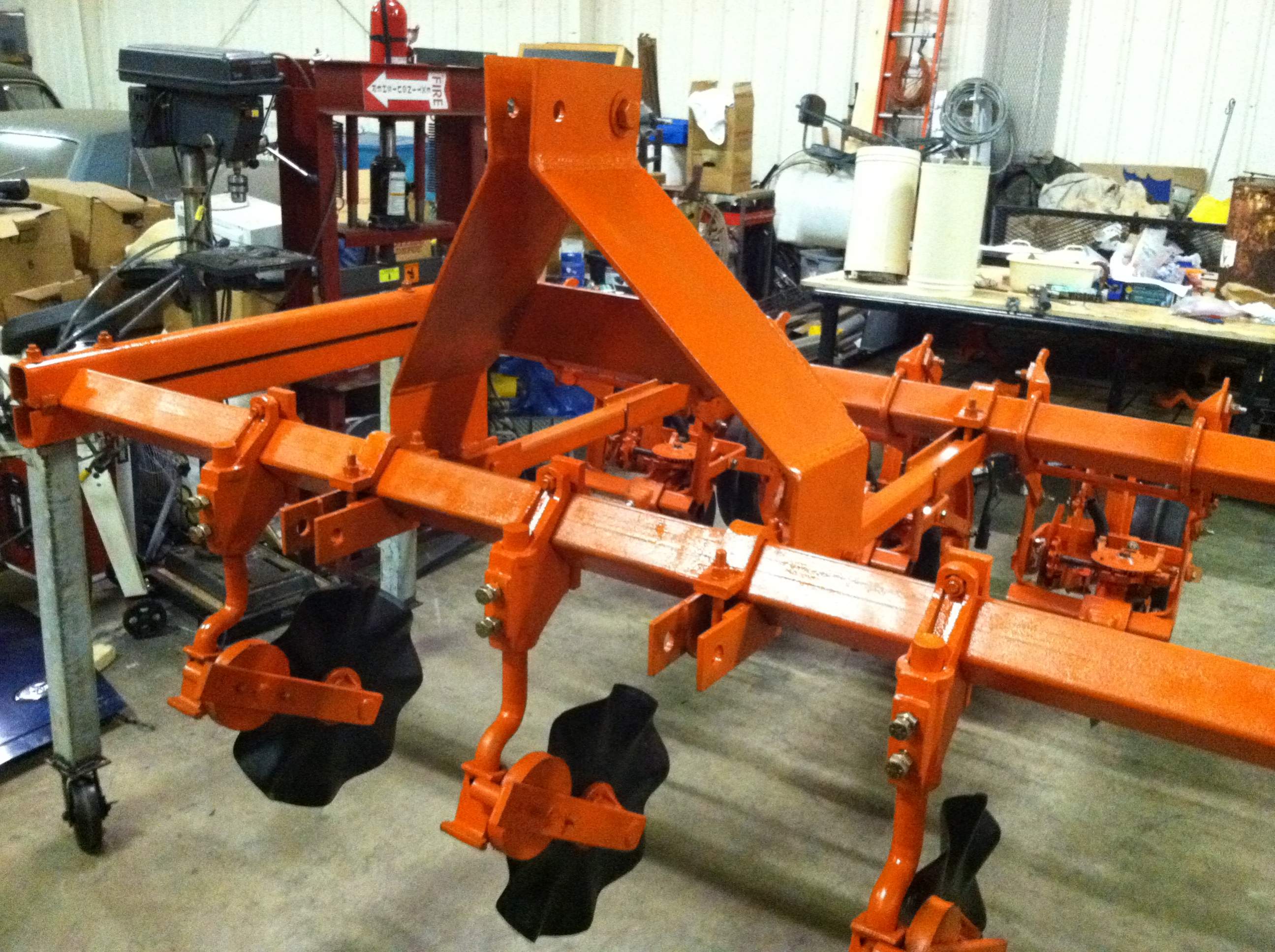

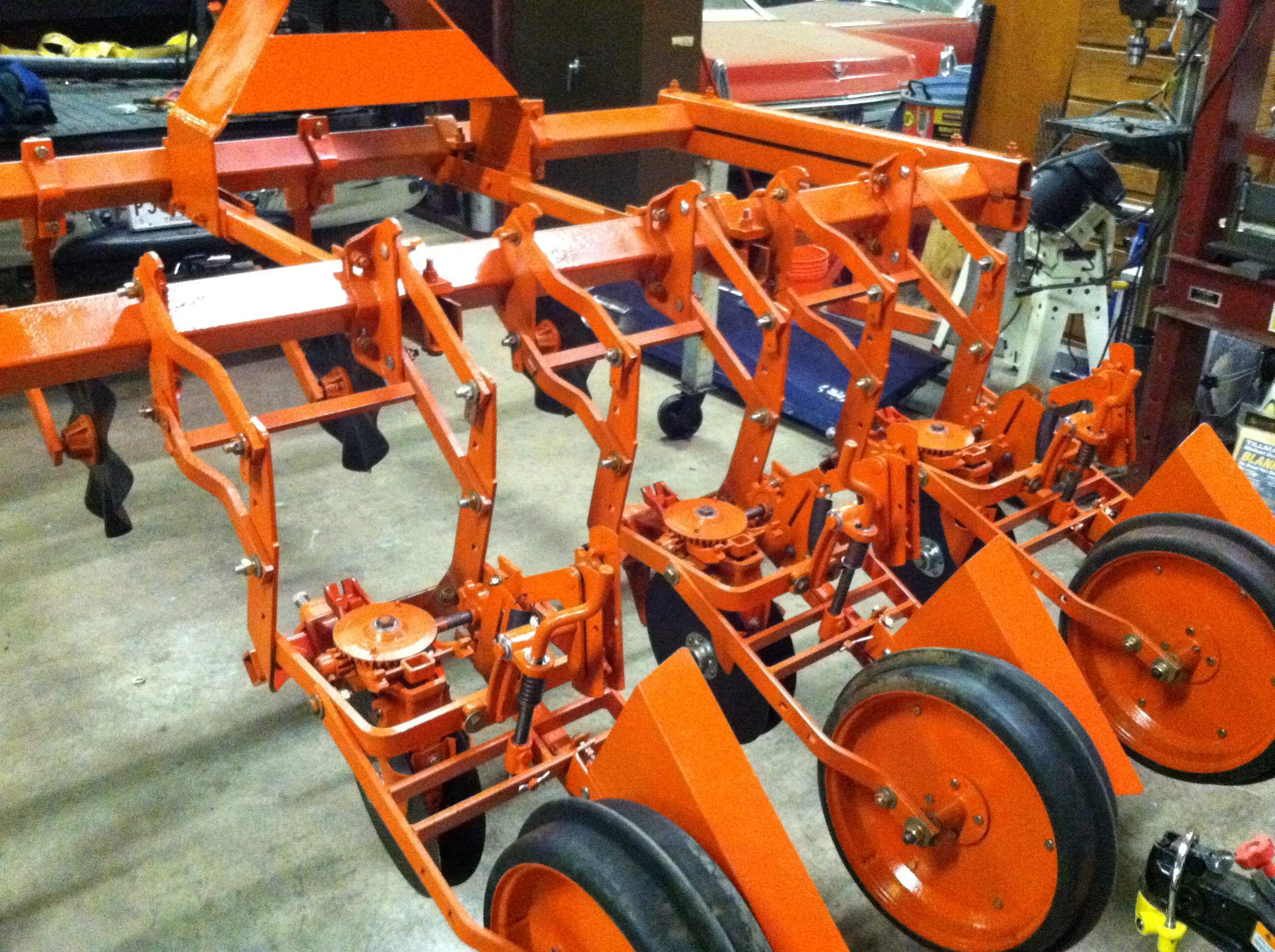

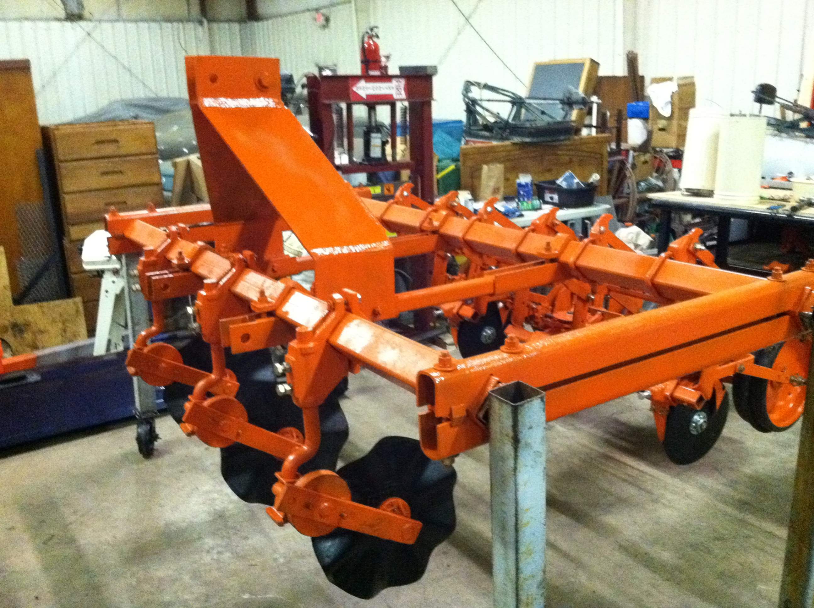

While I am here, these are the latest pix. I almost have the units complete and am mounting them on the reassembled frame. I am having second thoughts about making this a no till, as it really adds to the weight and makes the assembly much harder in terms of handling the weight. My tractor is not on site nor do I have a forklift, so its tough. But I have gone this far, so I think I will go ahead and use both tool bars and install the three coulters. I made the spacing 22", which I hope will work for corn and soybeans (at least well enough for plots) I can always change it. I cut my main frames at 8' width. I am still deciding how to make the three point attachment assembly. I am trying not to weld onto the frame as everything else is bolted on and I have plenty of U bolts and backing plates left over. Sorry bout the rotated pictures. They were upright in my file but transfered rotated and I could not figure how to correct. Just tilt your head!

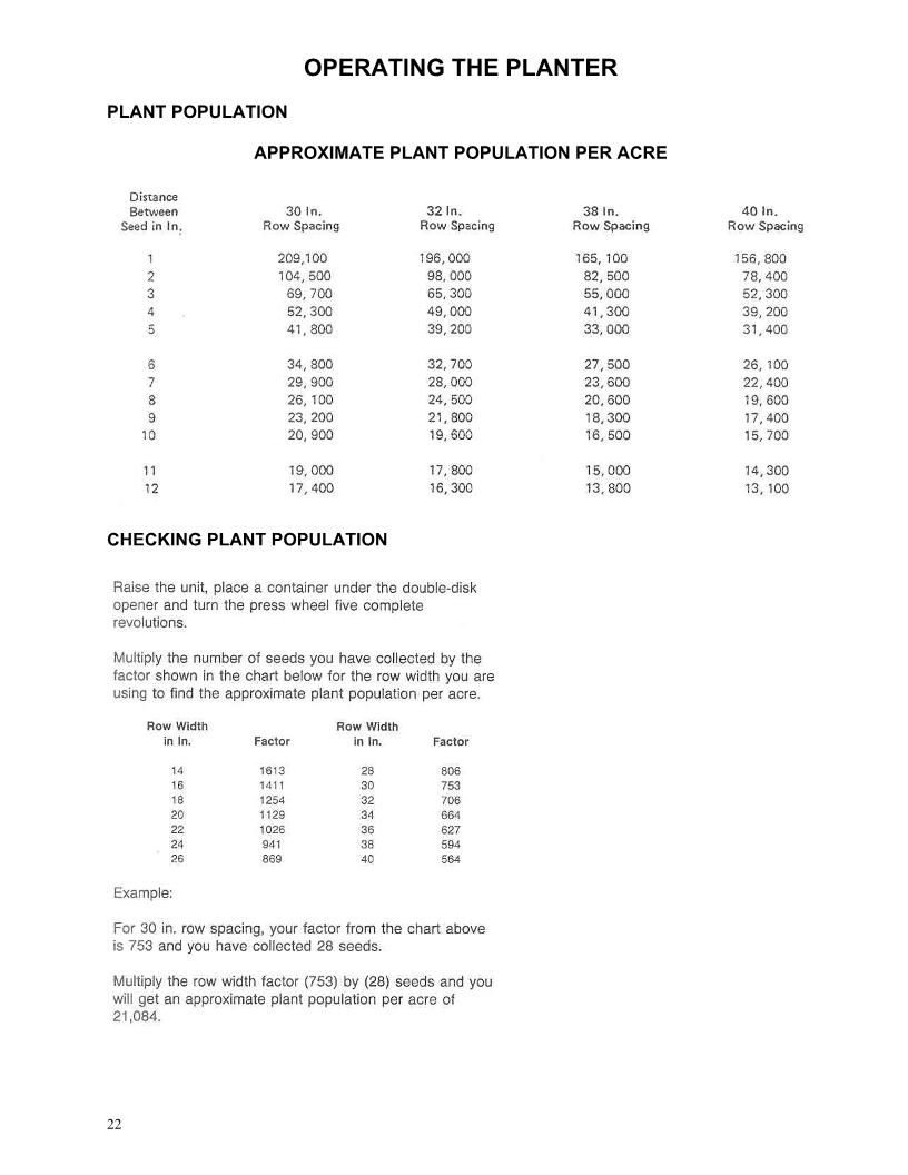

I am new to row planting. Explain what population means in terms of how I setup this planter. Obviously I only have one set of plates, corn plates, and that's good as that's what I plan to start with. What controls population? Speed or changing gears (my planter has two cogs in rear, but it seems the outer smaller one is what it was set on). I need some instruction of how to use this planter, as the manuals I have found don't address this.

Population is the number of plants per acre. It will be determined by the number of cells in the plates used to plant with, row width, and the speed the plates are driven. Higher cell counts and faster plate drive speeds will increase population. Plate drive speed is not ground speed. It is the result of the gear on the planter that drives the plate. Seeds plates were developed for a particular seed corn size. For greatest production yeilds, the particular seed needs to be spaced between plant and row so each individual plant has optimal growing conditions. You'll need to find the plate that most closely matches the seed you'll be planting. Then you can get 16 or 24 cell plates for that particular seed, and recommended population. The plates that came with your planter, may or may not work for the seed you want to plant. There are quite a few on ebay right now. If the plate numbers are listed, you can reference them here, Lincoln Ag Products . Hope this helps, and isn't confusing. In the realm of food plotting, it really isn't too critical. Mark

Here is a page from the JD 71 Flexi planter manual in regards to population. Population is a factor of row spacing and in-row (seed) spacing. Great job on those planters BTW. You have an amazing shop there.

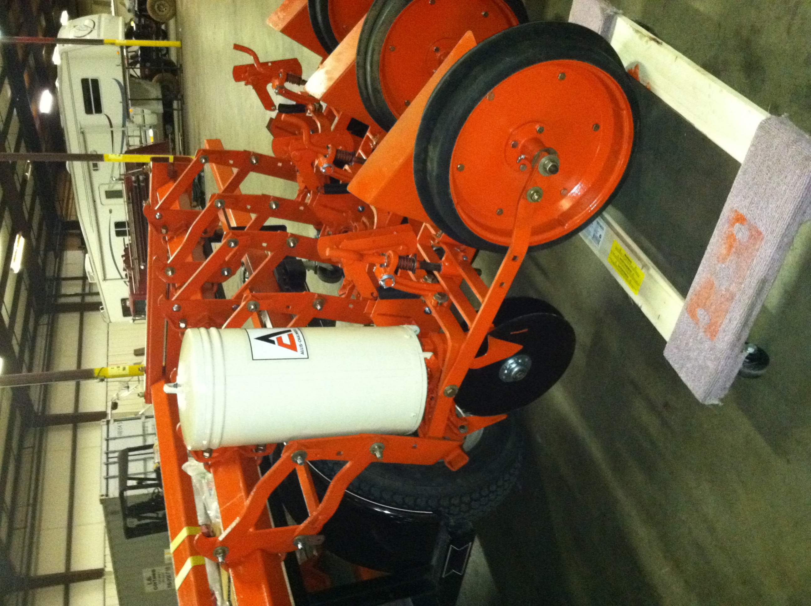

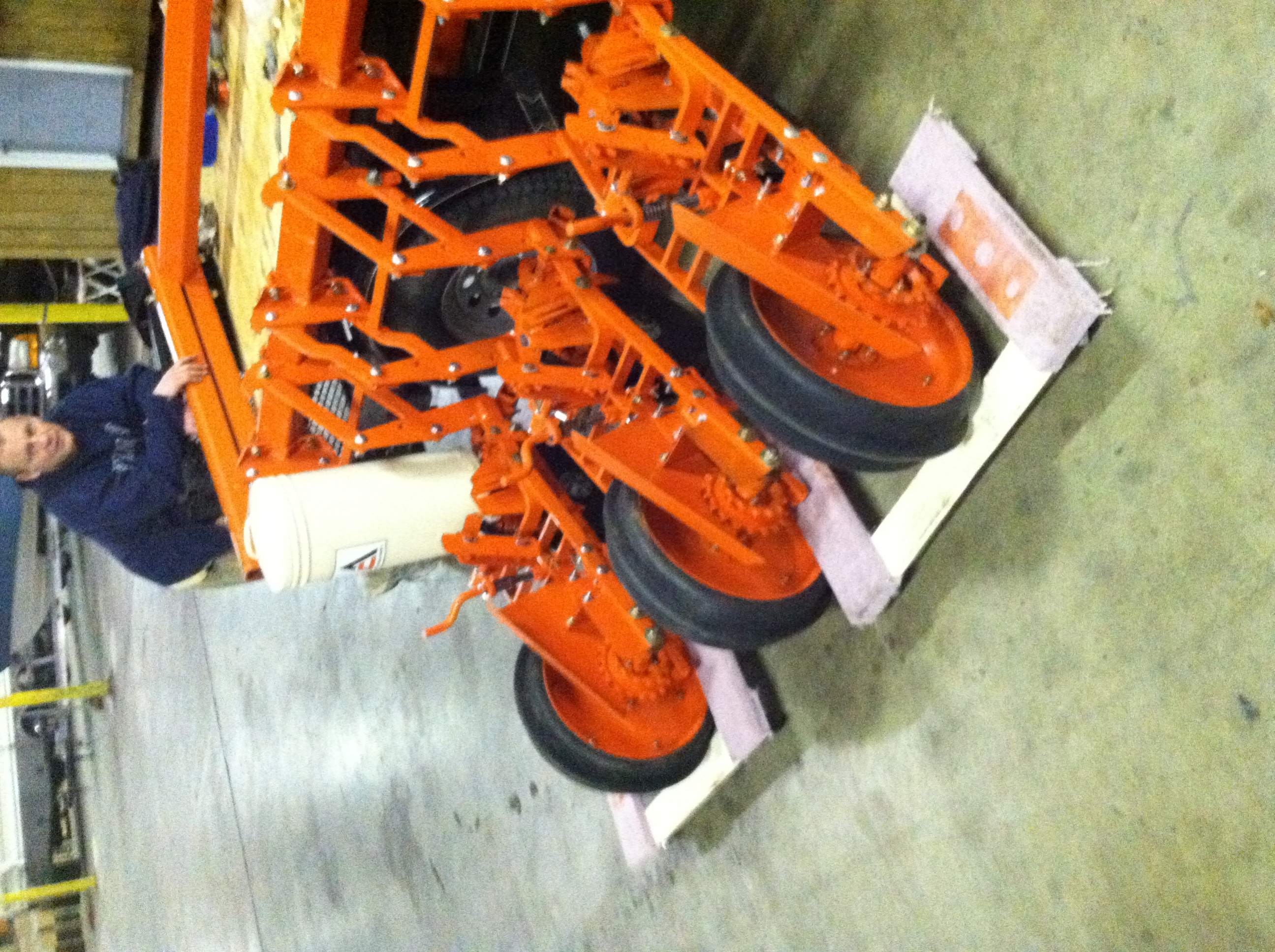

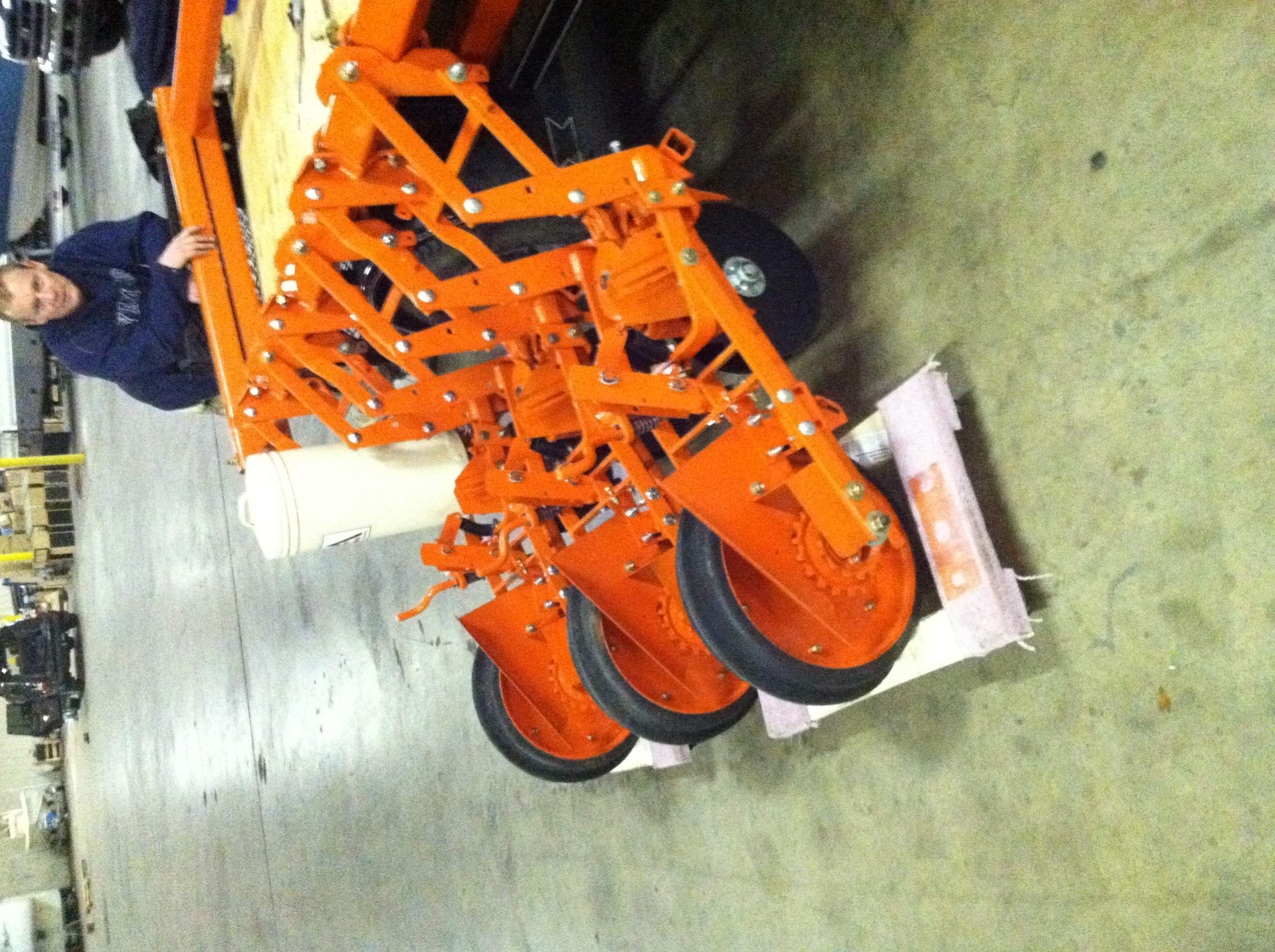

here is an update on progress. I fabricated a 3 point hitch attachment system as this was originally a pull type. I also made a "stand" with casters so I can move this around my shop, and which will double as a stand when I "park" this at my shed. This allows me to turn the rear wheel and try out the drive train and seed drop. Most of this I made from left over steel from the disassembly or scrap plate. Got to practice my welding skills (which are very limited!) THe spacing is about 28", as with three rows, the outside will be in my tire tracks regardless of spacing. I may cut the frame a little narrower (it's 8' now from the original 10') just to make it a little more manueverable.
