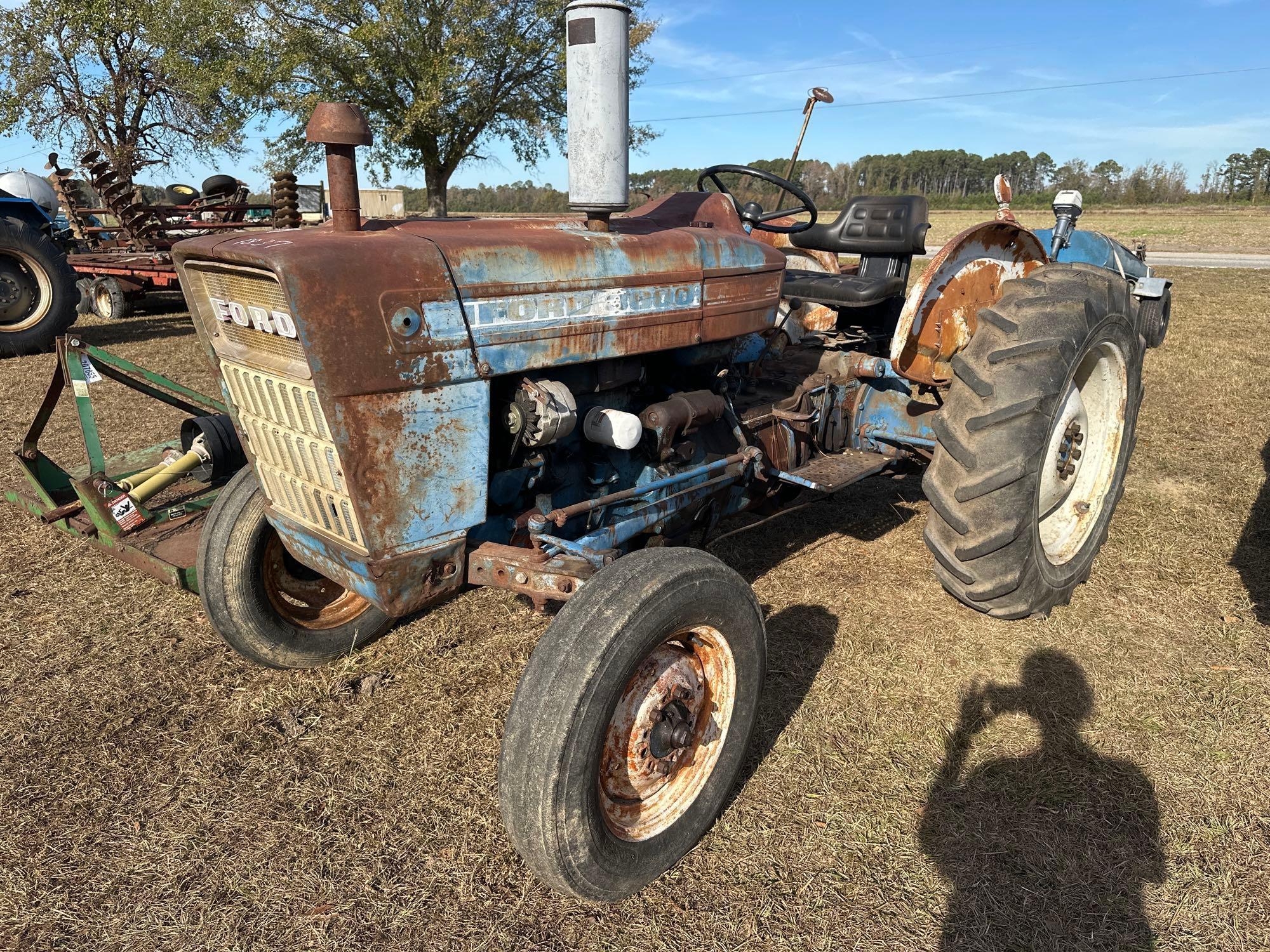

I did the old tractor thing. I bought nice looking Ford 44hp 340 Industrial with a front end loader off an old honest farmer. I am pretty mechanically inclined, I been around equipment my whole life. I paid $3000 cash and thought I was good to go. I plowed 4" of snow for a about 15 minutes before the clutch stopped working.
Turned out the fork broke. I considered having the $2500 clutch job done but then I started looking at the dry rotted front tires, the damp fittings, the hydraulic pump seemed to all of a sudden get louder, etc. So I went to the Kubota dealer and bought a BX25D brand new with a warranty and never regretted it since. Its has new tires, new hoses, new trans, new everything. Just put some diesel in and go. For the same money as my BX you can get a B3300SU with a FEL. Which should be plenty for your lot.

I don't see anything in your write up requiring a loader (you did say Dad had one, so borrow it if needed). A 3000 or 4000 Ford will do you well in the rough mowing, snow removal with back blade and tilling arena and would be about all you need. For the lawn, I would use the tractor for a while till the wife gets started with adding shrubs and flower, fruit trees etc and then you will need a good zero turn lawnmower. I know you said nothing in the way "right now" but I know how that goes. Wives hate an open field and will want to fill it with obstacles to mow around.
Get your used 2 WD tractor now with finish mower and back blade for what you have planned immediately, save your money for a good near commercial duty zero turn and get one when the trees and flowers get too thick to mow around with the tractor.
