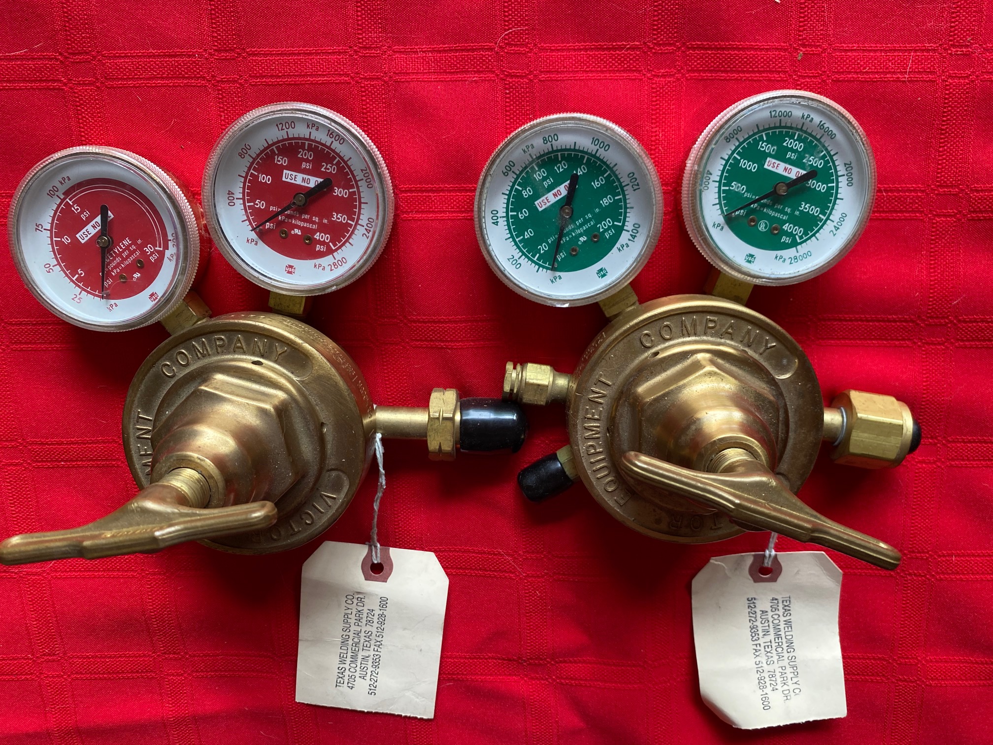

Here are my old Victor regulators. I had them rebuilt a while back. Every time they rebuild them they look like new when you get them back.
I need to buy new hose. Should I buy the T version or does it matter? I think they have 3 versions of the hose, the regulator version, the R version and now the T version.

Those Victor 450's are really not that old as far as genuine Victor regs go. Getting harder to find since Victor went to the Edge regs.

Which ones were the genuine victor regs?
The first regs I had back in the probably late 70s were Harris and then I sold them to buy Victor Texas made regs.
Maybe I did swap instead rebuild many years ago. Nothing comes to mind though. How old are the 450s?
   / Old Victor Torch #29
The 450's in your pic I would say are from the early to mid 2000's judging by the gauges and the newer style safety but the reg bodies didn't change much from the mid 80's on so someone could have put the newer style gauges on older regs. Fact is there really isn't much inside the regulators. You can spin the bonnet off and have a look. The 450's used a stainless steel diaphragm where lessor regs used rubber. This made them take pressure blast better without popping the diaphragm and they would handle condensation and cold gas better. ( other brands have SS as well on higher end regs). Other than the diaphragm there is a coil spring and needle and seat that's it.
