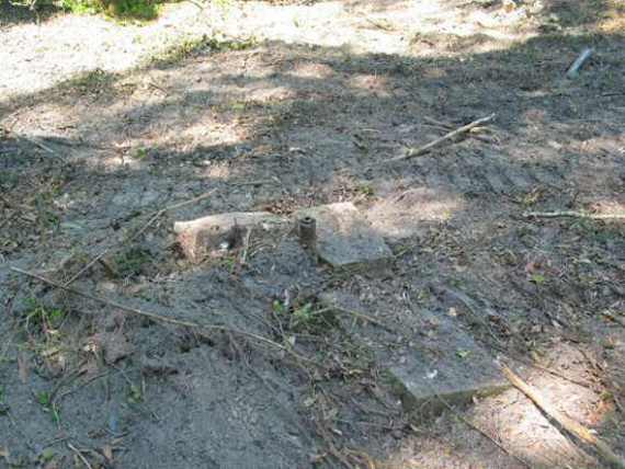

I came into this late so forgive me if I missed something, but around here modern submersible pumps have nothing more than a pressure switch to cycle them. You could use a breaker to activate it. Most are 220v so you'd want a dual breaker.
If there is no pipe coming out the top, you likely have a pitless adapter coming out the side of the casing. You can look inside the well casing and see where the pipe hangs on the side. The pump/pipe assy is lowered into the slot on the pitless where it wedges in seals to the pitless. The pitless typically has 3/4" or 1" F NPT threads. A "T" pipe is lowered into the casing and threaded into the pitless to pull it up.
I see no reason why you couldn't pull it up and try to power it. Water should stand sufficiently high in the casing that it should deliver water if the pump works. If not, keep pulling it up and take it out. All you need to do is cut or uncouple the pipes. Pump guys use a pair of C-grips vice grips with a plit pipe nipple welded to them along with legs so that it cannot fall in, They clamp these onto the standpipe to hold while coupling or cutting.
I can go further if you like. It is actually a DIY job...

OK. So I guess I'm back to the plan of trying it out to see if it works. We've had so much rain lately that irrigation hasn't been on my mind, but here in the middle of Mizzery it is sure to come a long hot dry spell later this summer. Thanks for all the information, folks.

Go for it! There's no mystery
Take a flashlight (on a lanyard around your wrist preferrably) and look down about 6' on the side wall and you should see where the water line exits. This is where you need to dig.
The only thing that I see is that yes, some require a controller (capacitor start) box, but the ones that I have done did not.
