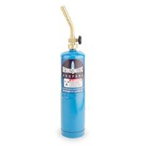

I have been known to use this on roof ice.
   / omg more snow #50
Already tried it. It works but much slower than I thought. A rock chipping hammer worked the best. I made additional channels today at lunch and I just ordered a 100' heat tape cable from Amazon. Don't know if that will work to melt the existing damns (some of the reviews said yes, some said no) but I will install it next year before the snow flies so I don't get in this mess to begin with, hopefully.
