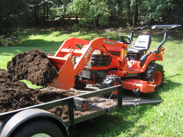

This is one way I unload my 6'X12' trailer.

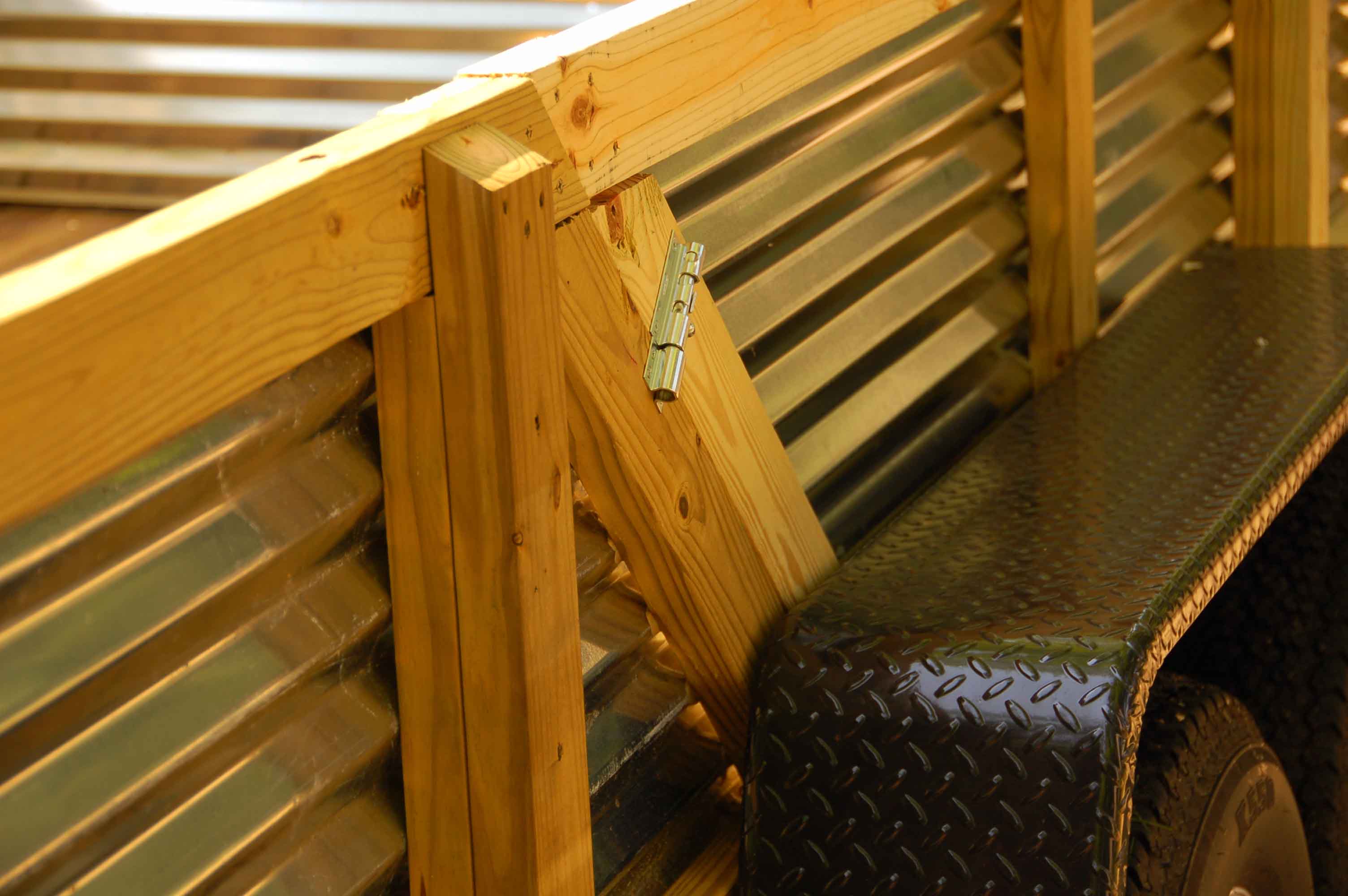

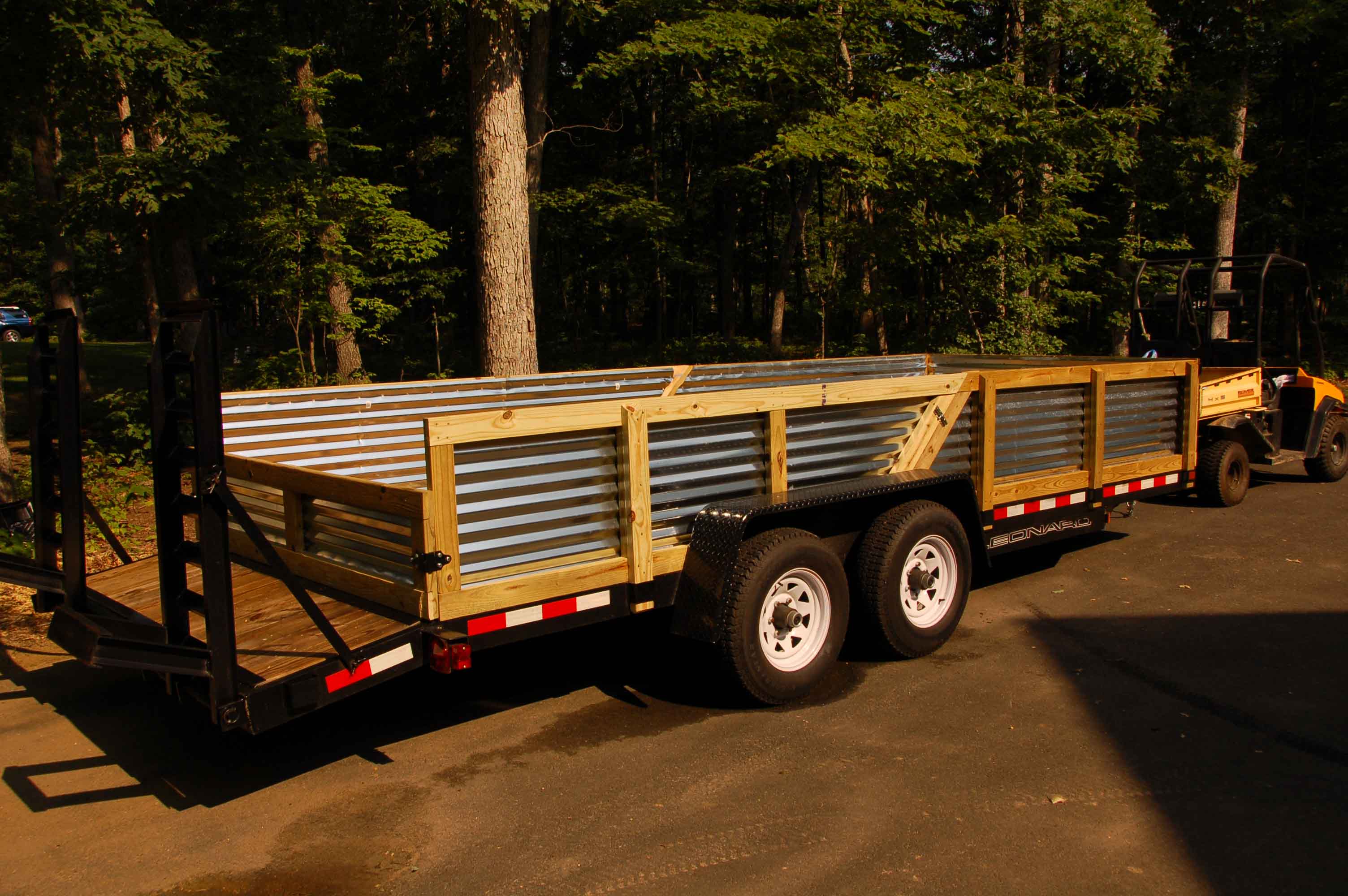

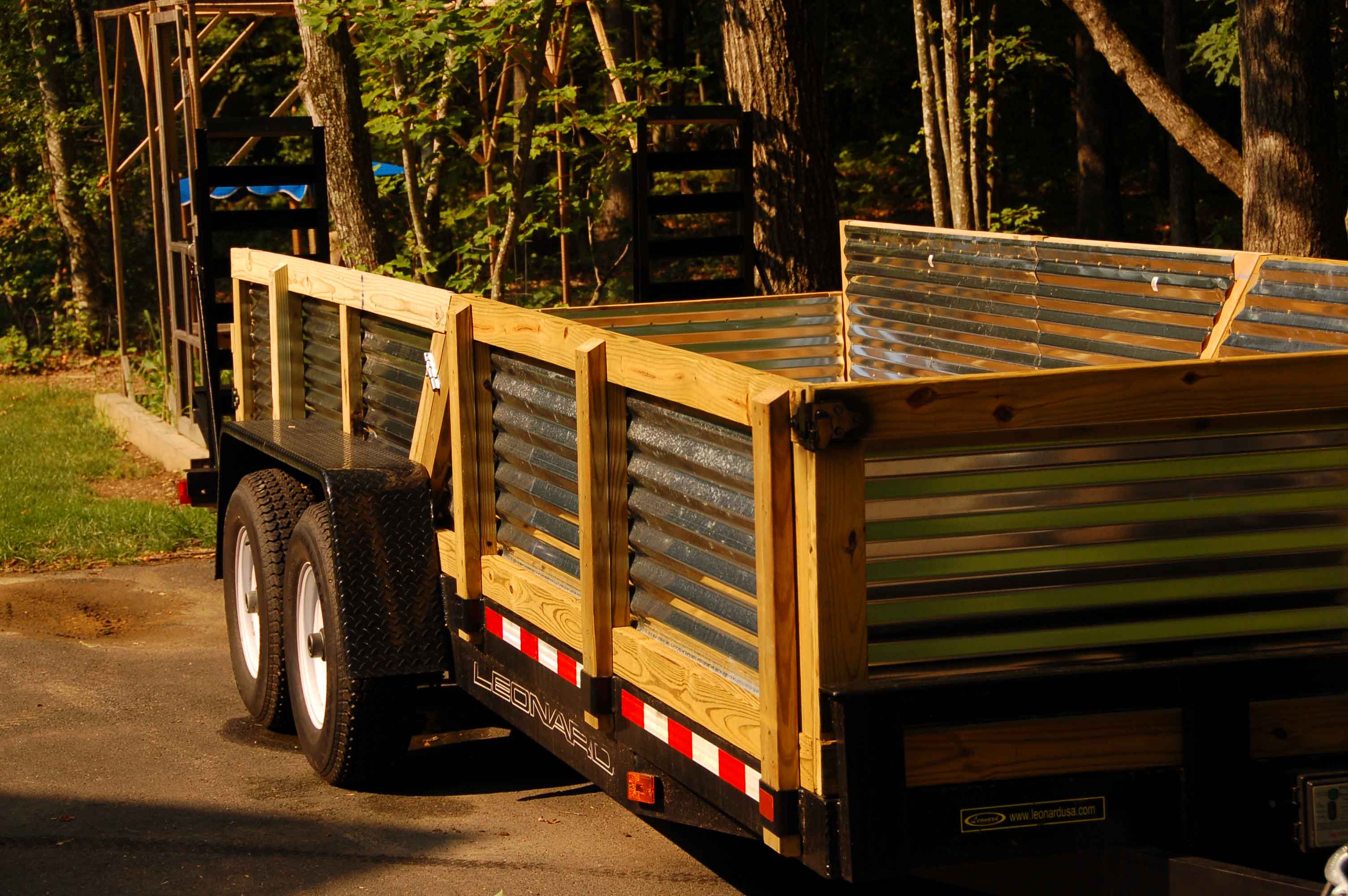

This is my trailer when I first built the stakesides. It's not quite as shiny now, but is holding up pretty well. The trailer is so large, I generally run out of weight capacity before I run out of room. 7 CY of triple-shread mulch weighs every pound of 3 tons and that fits in there quite easily. 3 tons of stone barely makes a pile in the middle. The nice thing is that each stakeside panel weighs less than 20#, so I can remove quite easily for whatever reason...which I have done. It all works pretty slick.
About my ramps, I doubled up on 2 x 12's...one 7' long piece with a 5' long piece screwed under it. That leaves 1' of 'single thickness' 2 x 12 at either end where it engages the ground and the ramp with the double thickness in the middle to resist flexing. I chiseled the ramp end so the end "nests" into the metal nicely, so there is actually a left and right ramp. I spray painted a big "L" and "R" on each so I don't have to think about anything.
I have it filled with whatever however. My FEL easily goes over the sides, but it is generally filled by skid-steer or quarry loader, depending on where I'm at. I had something loaded by forklift the other day, which made me feel REALLY good about the removable sides. And I plan on towing a car around sometime in the future. I have only unloaded by the rear (no pun intended).
And I would LOVE to have my small trailer sometimes. This one is just so big and heavy. I have towed it around without any trouble, but putting 2 things from IKEA on it just looks silly. If your trailer works for you, Mr. Volfandt, go with it. My 5' x 10' just didn't cut it, but perhaps I would have felt a little differently about a 6' x 12'. Not to say I don't love my big trailer, though.
