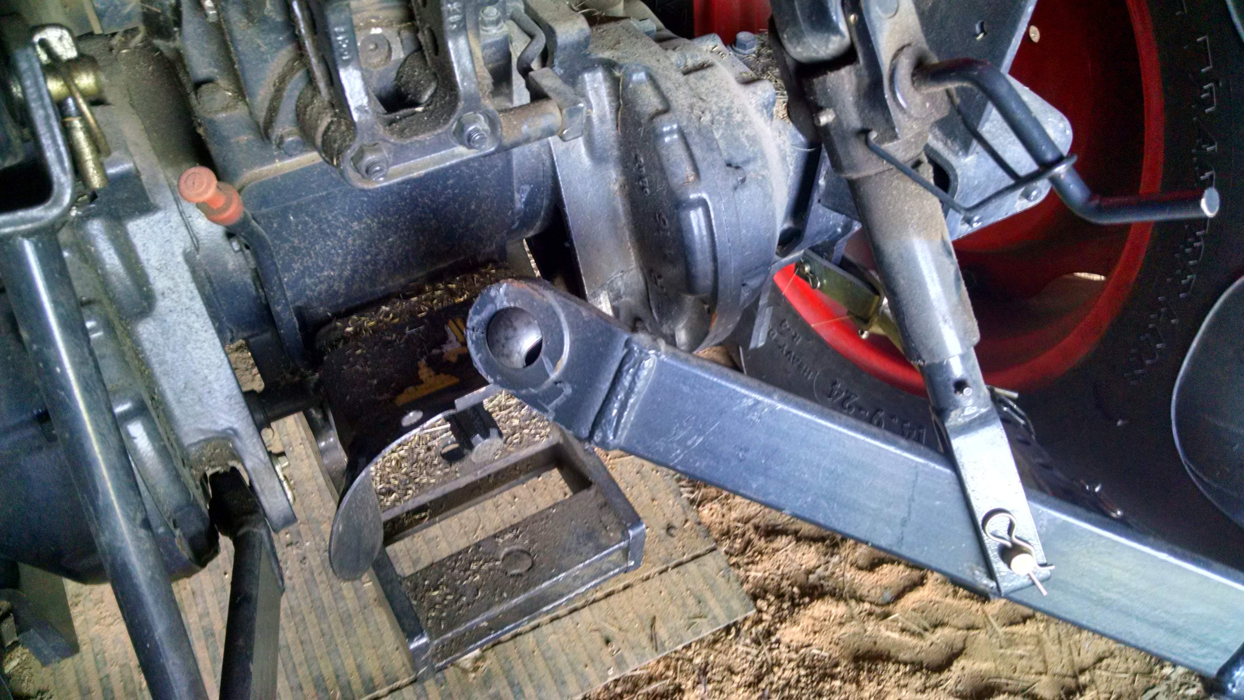

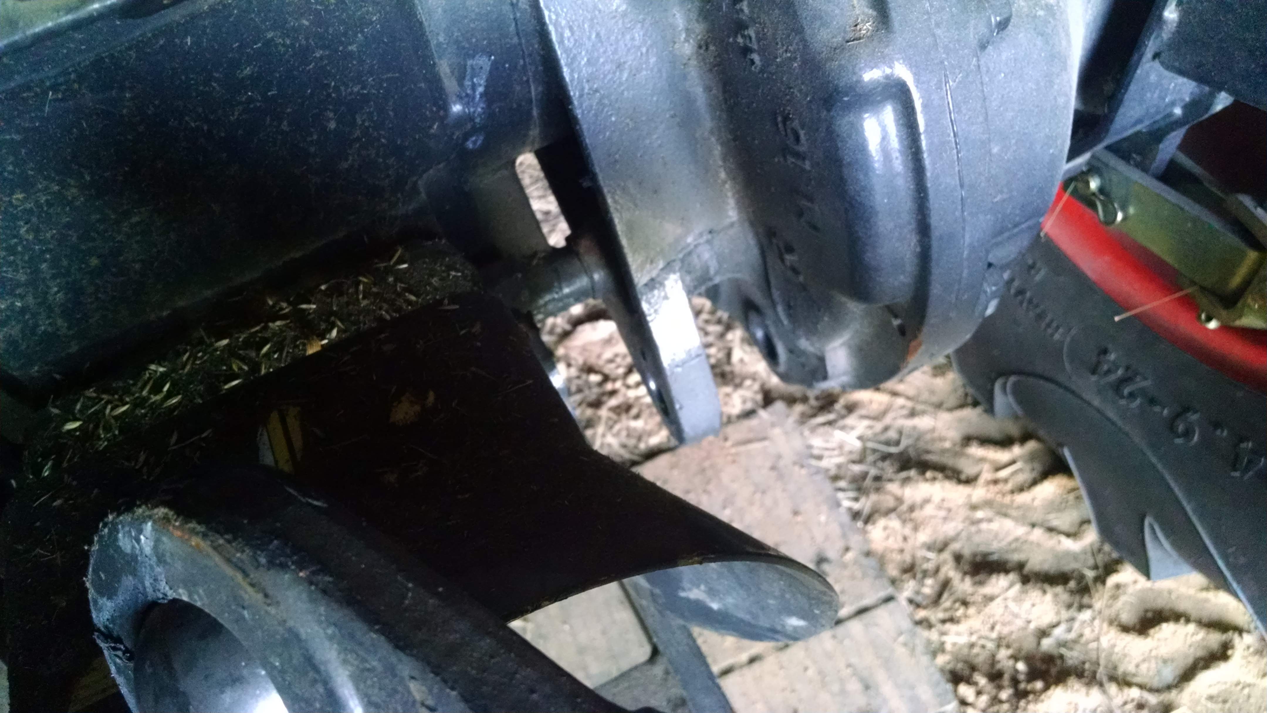

Anyone know the part number for the pin? I lost one on Sunday bush-hogging and while I'm sure it is in that field, not sure I can find it...
My dealer has taken 3 days and has yet to call me back.
I need my tractor!
Thanks in advance,
David

James,
Which piece is the snap?
Enclosed are the pics of the missing part...

David the part numbers I posted are the pin that holds the drawbar in and the "hairpin" clip which you can buy at any tractor supply store.. it looks like you have a different problem with the lower links being disconnected. go to Michigan Iron and equipment web site and look for what you need. I would stay and help, but I have to go to work..

James,
I lost the pin for the base of the 3-pt arm.
Not for the draw bar.
Sorry I was not more specific.
David

From what I can tell from your pics you need the type of pin held in by a bolt that is adjacent to the pin and fits in an oblong shaped metal housing.
Best call Tony at MIE, their number is located in the parts schematic KOua linked for you. I can't believe your local dealer would take 3 days to get back to you. I would ask Tony to ship it to you if they have it and then locktight it in place. It MIGHT be the same pin assy as is used in the FEL arm assy. If Tony can confirm this you could temporarily remove you loader and 'steal' the assembly until you get a replacement.
