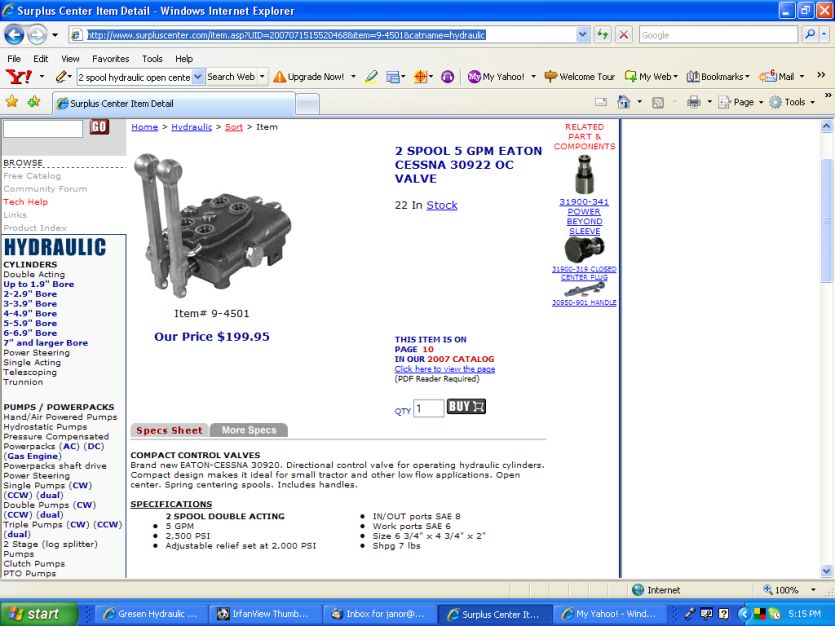

What a perfect T&T valve this is:Surplus Center Item Detail!
I'm taking it that the 17+" dimension shown for it is the height from bottom to top of handle, correct?
   / one more hydraulic question #22
I am sure the 17" inludes the handle-but they are very helpful on the phone if you call them.

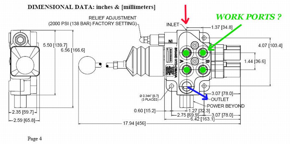

Ron & Mike, for this application, the B2910 is just like my B2710 and you do not need power beyond or a 7th hose to return to sump. You can see a picture of the valve I used in the photo section of TBN here. You can see the two hoses going down inside the fender which go to the hydraulic outlet that's been discussed. The four hoses going to and from the two cylinders are connected on top of the valve and you can also see those 4 hoses here. Six hoses total.
This has been an interesting thread.. Another newbie here that is looking into getting remotes.
I was thinking of getting a 3 spool valve. Two for TNT and one for ?? Considering I didn't think I "needed" remotes - figured I would add a third spool.
Silly question. The valve above has only one joystick but two spools. does this work just like a loader valve - vertical and horizontal for the two different work ports?
   / one more hydraulic question #25
Yes it does, left-right is one spool, front-back(up/down) works the other.
