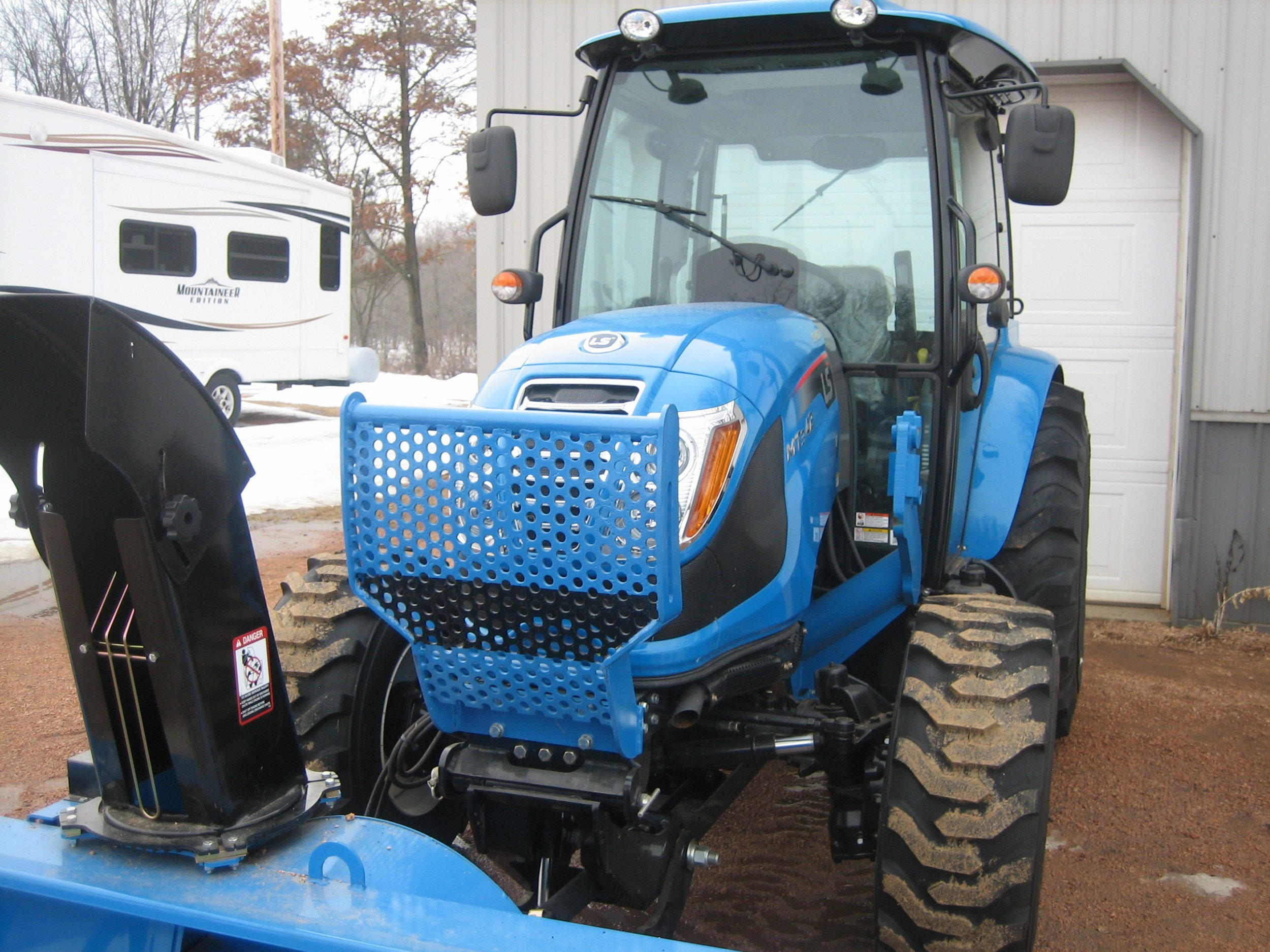

Upper part are welded together chain links, the bottom part is 1/8" metal.
Here is what I did on my LS , the screen is from an old Cat grille.

Stout grill material.
