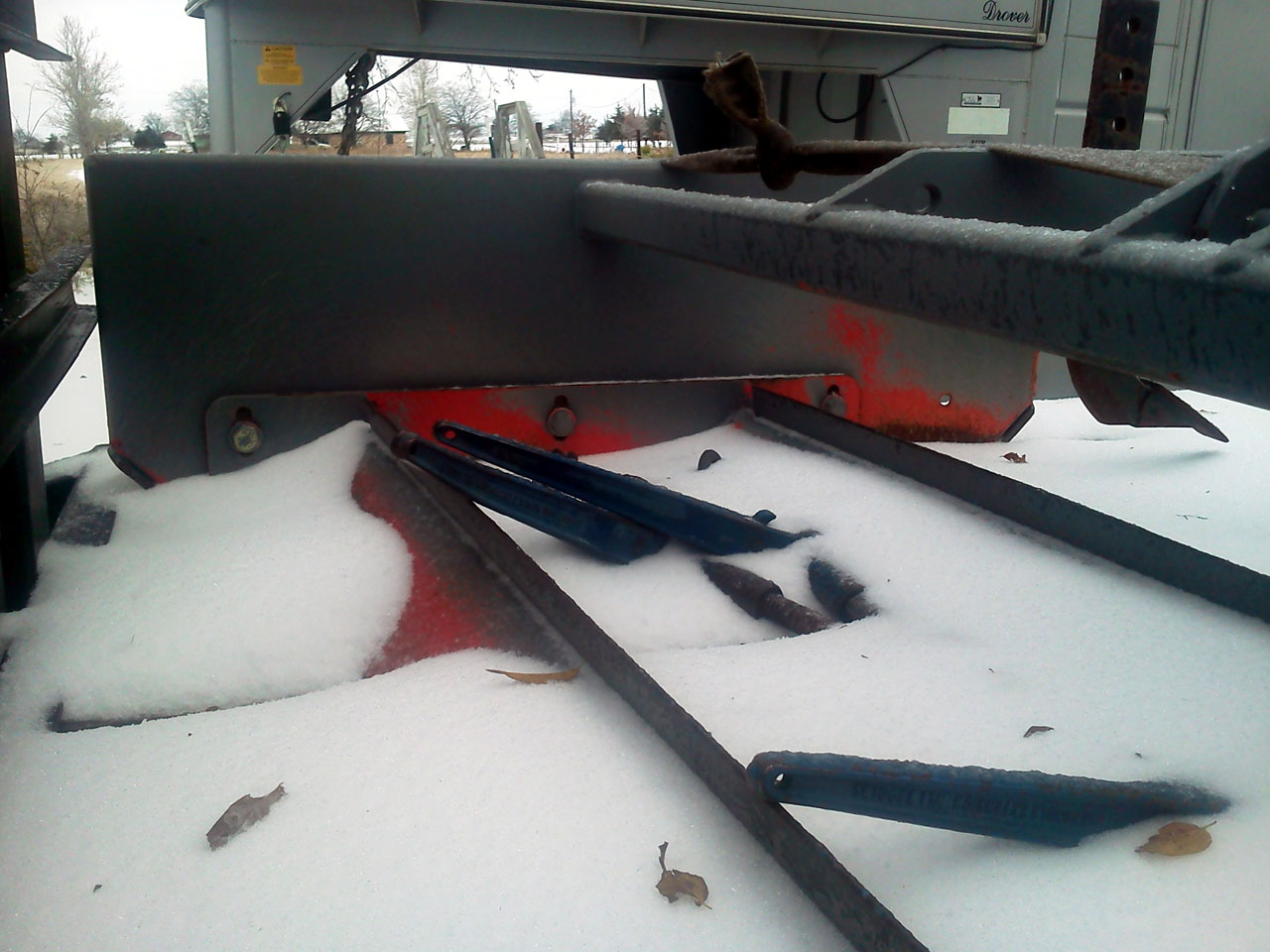

I've actually never seen a land plane in person, just pictures. How are the blades adjustable? Are the holes holding the blades slotted on the angle supports?

I snapped a better photo for you.

Two adjusting methods I've seen:
Blades (and maybe a subframe) move up and down between the side plates.
Blades are fastened rigidly to the side plates, but the skids under the side plates move up and down.
Bruce

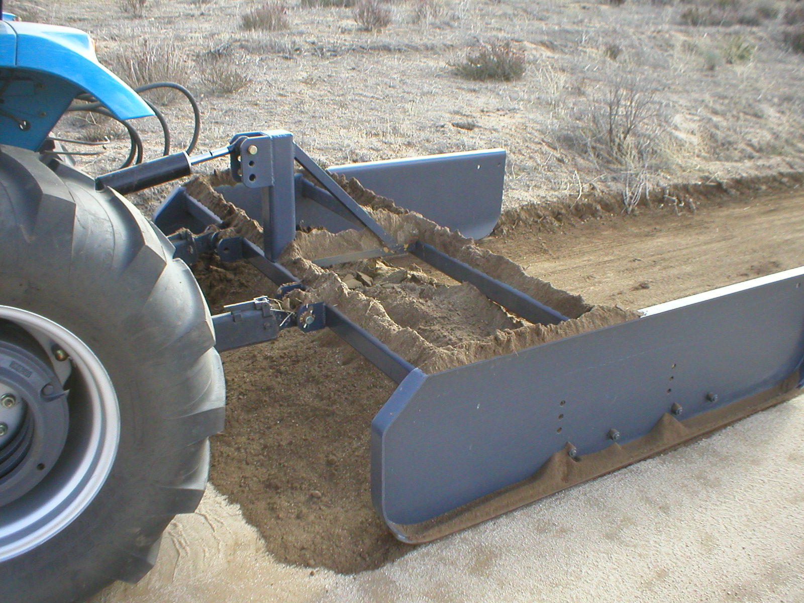

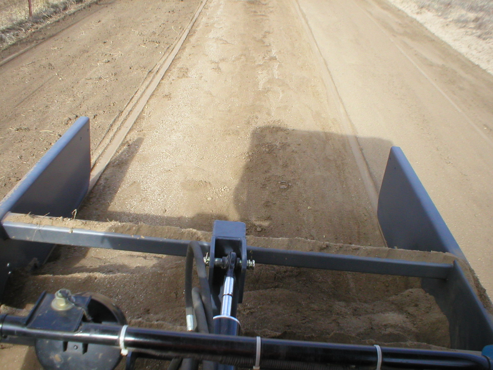

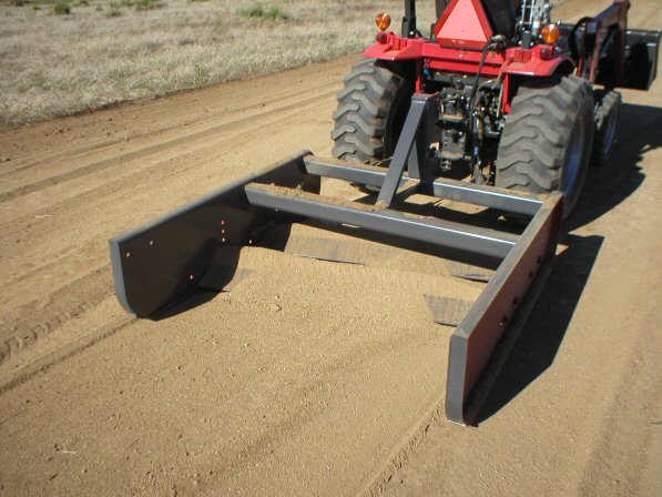

Something to keep in mind whenever doing dirt work. Moisture content can make HUGE differences with how the material reacts to what is being done to it.
1st pic is in dry ground, the materials is cut and flows freely over the cutting edges.
2nd pic is with damp ground, material does not flow as freely, but compacts down much better.

Yep that helps. I was thinking the slots was on the angle, not on a side support bolted to the side rails. That is a much easier build that way too. And BCP, your comment clarifies more, in that from pictures I've seen, many land planes do not have that adjustable feature on the sides. The everything land plane as an example, I see no bolts on the side, so I assume the angle supports are slotted. Most of these pictures are not details enough, but it appears both blades are set the same distance below the rails, not as you mentioned with the front one lower. Is it important to have the depth of the blades set differently? Seems the only way to accomplish that is slots in the angle support.
You can probably tell from the questions, I've decided I will build one over this winter....if I can stay warm enough my work area in the barn. Then again I may wait for warmer weather.
