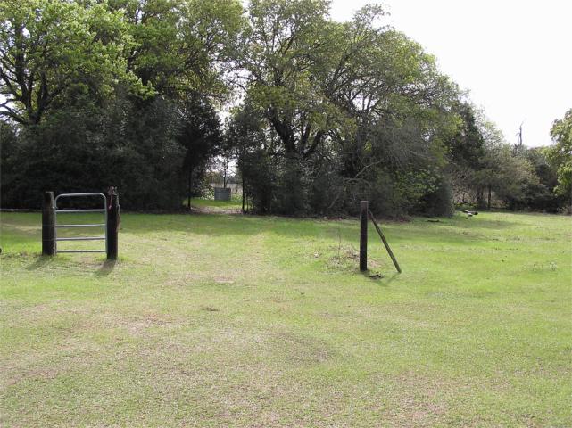

Well Harvey Looks like we are going "live" now. /forums/images/graemlins/smile.gif
I'll be under a bit of pressure to get things done to keep this thread going but this will be fun.
As I told Harvey I really like the design of his connectors and it seems so simple, but then Harvey makes everything look simple. Since I am not a builder and usually put things together wrong at least twice and always ask way too many questions I think I would be considered Harvey worst case scenario customer. /forums/images/graemlins/grin.gif
Harvey's Ideal of being "live" and answering all my questions through this thread sounds like a great idea to me.
This thread might seem painfully slow to experienced builders but for us novices I know it will answer a lot of building questions and might give us an insight into the creative mind of Harvey Lacey. /forums/images/graemlins/smile.gif
The building will be my first metal structure and will be built in in central Texas. It will be built in retirement mode: slow and fun. /forums/images/graemlins/smirk.gif
The framing materials have been brought on site and the holes have been dug.
The building will be a 21'X30' carport/storage building. The back 9' will be a storage area will slab.
The first thing I learned is that the building should be in increments of 3' because of the width of the metal sheets.
I will post more pictures tonight.
This picture shows the building site.

Hi Don,
Im lookin foward to this thread /forums/images/graemlins/grin.gif But I gotta ask, was that photo from a while ago, grass seems very short for this time of year ?
scotty

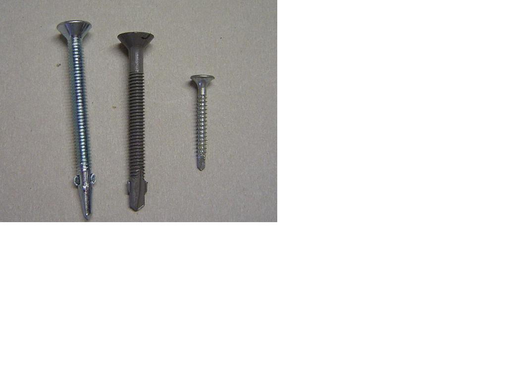

Jim, I can't remember what type of siding you have. If it has a lap to hide fastners here is some ideas.
The left and center screws are made for attaching wood to steel. They have small wings above the drill point to keep your wood from riding up the threads when the point starts drilling the steel. Once the tip gets thru the steel the wings break off. The left screw is zinc coated, center screw has a chemical resistant coating.
I used the center screws on a 10x10 portch for my dad about 2 years ago. We used them to attach choice decking to steel perlin. When the choice deck greyed they matched great.
Short screw on the right is a standard stainless steel drywall screw.
Hope this helps!
James

If they're like me the grass is short because we've had less that 4 inches of rain in the last 9 month. In that time on a normal year i'd of had 30".

Those screws are the cat's meow in my book James.
On Scott's barn we used a standard Home Depot prehung exterior door. We used the brackets and framed the opening just like we would with wood, two inches bigger each way than the nominal door size.
Then we used regular wood shims to locate the door in the opening. The two inch oversize is to allow for squaring up and plumbing the door. In our case we could have went an inch oversize and had plenty of room for adjustment.
Once we had the door wedged in place we used six of those large grey screws to attach the plastic-wood door frame through the wedges into the steel purlin framework.
Jim start designing your building.
I've used two different ways to attach wood siding to steel purlin frameworks. The first time involved a cantilevered super trick looking cedar entertainment area in North Dallas. She wanted a cedar finish to match her fence including a twelve foot cantilevered roof with no pillars.
I was contacted because the contractors needed some ideas. /forums/images/graemlins/grin.gif
We went in and placed four each four inch pipe posts twelve feet deep in lots of concrete. Then I built out a purlin framework with metal roof. We added two by cedar framework to the purlins via metal screws. Then they went in nailed up the cedar planks. It was a fun job.
Think of a cedar fence with a cantilevered cedar ceiling with can lights and a refrigerator and grill built into the wall.
The other way is to use self tapping screws and cedar planks. I love rabbets. Cutting in a three eighths of an inch rabbet on each plank guarantees there won't be a gap no matter how dry the material gets over time.
